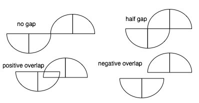

 I think what is at issue here is a misunderstanding of the terminology. Some reference "gap" and some "overlap", like they are the same thing. Are they the same thing? My current thinking is no. Overlap, the percentage of stagger between two half cylinders like this
   (3D glasses required)
  and gap, the distance between the two halves, like this
        _____
                ______
  Different publications call the two terms differently, and that causes the confusion. I could be completely wrong about the above, but if drawn out on paper with proportional scaling, the model with gap looks like it would flow better. The barrel I have flying now has no gap, and 4" overlap. It'll start on a cricket fart, and spins very nicely up to about 75 rpm in 10mph wind, but has very little torque.
 Is the above correct? Thanks all!

Actually, you'll need more than 3D glasses to see that. How bout this..
« Last Edit: October 17, 2007, 06:49:25 AM by disaray1 »

Here's how I always imagined it. I guess it helps if you mentally remove the straight lines.
My small quick vawt has a 1/2" overlap, one blade overlaps the other by that much, and a 1" air gap.
You're right though, it's mixed and matched depending on the source...no fun.

feral air;
   You have it correct. Most all of the long term places show it 1/2 the radius of the diameter before cutting the barrel, that would be the overlap.
ALL the older books on this shows a 1/2 radii overlap as well.
There is now doubt that the term overlap and gap have been intermixed way too much.
A modified Savonius does show a true gap, but this goes further in that it actually modifies the overlapping section as well , where they are becomeing a flatten area.
Windstuff Ed and others a few years ago did a whole lot of design studies on the VAWT and the Sav. to the point where there was even a single 3 cup sectioned VAWT instead of the normal 2 cup designs.
The overlap is to "help" guide the air through the cup and the 1/2 radius seems the be the sweet spot. The Gap is more of a structual help than air flow.
Maybe Ed will chime in here about those long ago discussions , he's kinda the guru of the VAWTs.
Hope this doesn't add to the muck:-)

Re: Savonius gap clarification
« Reply #10 on: October 18, 2007, 09:52:25 AM »
  The above drawing is correct.  The drum machines and sandia's machines are two different breeds.  Sandia was leaning toward the lift portion as the wing crossed the 0 degree into the wind where the barrels tend to operate best as primarily drag machines but does achieve lift as the drum passes the 0 point.
  The whole idea of the gap and/or overlap is to reduce the negative pressure or vacuum behind the upwind wing (negative drag).  Also, by overlapping the drums the upwind side tends to feed the downwind while reducing Cd on the upwind side similar to a diffuser.  Like all drag machines the power is extracted primarily by the downwind blade, the upwind blade simply reduces the amount of power extracted by the downwind blade.
  I wouldn't read to much into the "perfect gap/offset" because this will vary based on windspeed.  If it's to large then the turbine will suffer in low winds and visa versa.  In lower winds ( 0-20mph ) your better off keeping the overlap small, 4" on a full size drum would be fine, and keeping the larger cup area of the downwind side.  This will produce more torque.

That there's this much ambiguity surrounding what's often called the "Simple Savonius" just seems strange. The terms and formulas should be concrete and anyone using them incorrectly should be easily corrected.
I always figured it by the diameter of the cylinder too but all I know for sure is that that's the prevailing theory.
"I tried to build one without the middle pipe but was never able to get it to stay straight over any length of time."
A design like my "quick vawt" makes that fairly easy. If you want any real power out you'd need to scale that up a ways but that shouldn't be too hard to do if you're determined. I've been considering ordering some custom "U" brackets so I could use larger diameter pipes (in the spirit of "go big or go home") but the only place I've found that'll do short-runs wants like $40ea. for 2 custom brackets. Ouch.
Savs are already less efficient to start with so I never even considered adding a shaft to mine. So far I've been lucky, my barrel-vawt has held its shape fine for the last few months and last week it saw a nice storm so I know it's good to go. My "quick vawts" are just toys (yard art) but they've held their shape just as well.
"... but due to swept area differences it really did not address the real efficiency issue of most power produced in a certain diameter turbine. That means that the less overlap the greater the swept area so the more area to extract power from and it skews(screws) the figures."
I get why they did it that way though; you have a cylinder with whatever diameter, now make the most efficient rotor you can. The diameter of the result doesn't matter so much when you look at it that way.
The most power for a given diameter turbine is a different question that you have to answer (at least in part) with modified blades, different designs, etc.
If you're trying for the most efficient (drag-based) rotor for a given diameter then I think the so-called "squirrel cage" vawts have the edge. The little one I made has a 9in diameter and sweeps 2.88sqft. The closest Sav. I have to that has a 10in diameter and if it was as tall as my squirrel cage it would only sweep 1.62sqft.
The squirrel cage wins by 1.26sqft (!!!) and the squirrel cage is an inch smaller in diameter. That's a fairly drastic difference at that scale. Of course that's not the efficiency difference but it should still give an idea. I don't know how that scales either but I'd imagine the squirrel cage keeps its edge.
And now that I've rambled off-topic, I'm done. I don't care that much to drag this out. Eyeballing the gap and overlap seems to work well enough for me and I probably won't be making many more Savonius rotors anyway. take it easy

Hi, this is exactly what I wanted to know too P
but based on this,
"http://www.prod.sandia.gov/cgi-bin/techlib/access-control.pl/1976/760131.pdf">http://www.prod.sandia.gov/cgi-bin/techlib/access-control.pl/1976/760131.pdf
for the gap width ratio, s/d
bucket diameter,d = 2 r
My question is do we need to consider the diameter of the shaft?
« Last Edit: September 18, 2008, 11:03:08 PM by mechamz »

I haven't built one yet, but from my reading...
If the shaft diameter is less than, say, 1/4 the width of the gap-hole its centered on, I wouldnt worry about it affecting output.
As I understand it, you are balancing the swept wind catching area on the retreating scoop side against the the wind pushing back against the back of the advancing scoop.
If there was zero gap, the wind resistance on the advancing side would be the same, but there would be turbulent drag behind the advancing side, and turbulent wind capture on the retreating scoop.
Once you introduce a gap so air can flow between the two sides everything changes. Wind "A" hits the outer portion of the retreating scoop. inside the scoop, air "B" gets pushed in a "relatively" non-turbulent fashion in an "S" shaped path to the other side. It pushes air "C" inside the back of the advancing scoop out, reducing drag on the advancing scoop.
I have read that the highest recommended 50% gap performs better than others in high winds, and the lowest recommended gap is 17% for low winds (the most common wind found near ground level)
These are not expensive, make two separate VAWT's with the scoops between a top and bottom solid disc. Make one with Gap "A" and the other with gap "B", and raise them the same height at the same time in the same wind. (or mount them to your front bumper)
Something two feet in diameter and about 3 feet tall should provide fairly accurate data, but then again, the most important thing to remember is, I never made one.
However, I insist you send me a check when you get rich off this!
