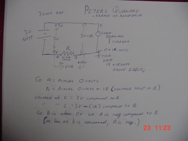

But I'm wondering: as the output of opamp 2 (current control opamp, pin 15(-) and 16(+) goes UP, the TL494 starts to fold back. So, in order for current control to work, shouldn't pin 15(-) be tied to ground and pin 15 (+) be driven by the positive current feedback voltage (i.e., more current through the transformer, more drop over the line, sample point becomes more positive w.r.t. gnd, and pin 16 should go more positive (as opposed to pin 15) to reduce current again and close the loop ? In that case, couldn't the sample resistor be placed not at the transformer, but in the outgoing ground line (where pos. and gnd exit the PSU for use) ?
Either that or I'm missing how this circuit really works.
In this link (40 kB drawing) is the circuit as I've built it, but again, the way I understand it, pin 15 and 16 should be reversed for a closed loop with negative feedback.
http://www.anotherpower.com/gallery/dinges/PC_PSU_schematic?full=1
Oztules (or anyone else that knows how to deal with the TL494), I'd be interested in your opinion on this.

Peter, your reasoning for the operation of the tl494 is fair enough....... however, ground in this case is more positive than the feedback voltage ( look at how we have achieved the voltage..... we take the voltage from below ground ie more negative than ground. Ground in this case is 2" above the sense voltage. The wire is a voltage divider, the ground point is at a slightly more positive condition than the connection between the sense wire and the lifted tap output. As the current rises ground becomes more positive in relation to the tap/connection interface.
So if we tie pin 16+ to ground, pin 15- becomes more negative with respect to ground and overcomes the positive bias we put on it via the 47k resistor to vref.
Originally pin 15 was tied to vref. This held the op amp in off condition as the 15- was above 16+ If you look at how we generate a pulse width from a triangular wave beaten against a fixed voltage through a comparator, we find that the pulse width is related to width of the triangle at the voltage point of the fixed voltage..... graphically.... draw a triangle, and move a horizontal line up and down it. The max width is when the horiz line is at the bottom of the triangle... not the top. So with no control voltage (original condition before butchery 16+ gnd and 15- at vref+, the output from the pwm would be at max. (ignoring the voltage control for the moment).
In the new case we positivly bias the 15- pin via 47k from the vref. This will mimic the original wiring.... now we hook up the below ground voltage from the transformer tap. As voltage through the sense wire raises, pin15- becomes more negative (proportional to the current through the sense wire) with respect to pin 16+.
This turns on the op amp,and the horizontal line we drew rises and so the pulse width decreases...... clear as mud really
If I have made this difficult, let me know and I will try again.

That's the part I don't get: that the voltage on the sample point is more negative than ground. I would think it to be more positive (should've measured it with the DMM though; neglected to do that). And the fact that the design more or less worked (though not with the current range I wanted) seemed to prove your design was ok.
Let's for a moment assume that ground (on the PCB) stays at ground. We lift the return wire of the transformer and put in 2" of our own wire in between that and ground. Now, where our extra wire is soldered to the PCB-ground is actually ground. The other end of the wire (attached to the transformer return) becomes more positive as current increases (I would think), but apparently, you say it becomes more negative ?
Another question: how much current adjustment range do you get on your PSUs ? Can you adjust from, say, 100 mA to 10+ A (it's mainly the lower current range I'm interested in; does it work down to a few 100 mA or so ?)
I think I understand how it works, except from the actually sampled voltage; positive or negative... (yes, I believe you when you say it's negative, I just don't understand why)

You may be getting misinformation from your current readings because of load change.. ie you think you have current control under control, only to find out that the test load was not capable of loading the current up due to voltage considerations. ie if you used a 4.5A globe, you may have felt that you were limiting at 5A only to find that with a lower impedance load (read short), you were really not limiting at  that point at all....ie you had the load limiting the current, not just your current control.... probably what happened here.
........oztules
« Last Edit: October 21, 2007, 04:27:58 PM by oztules »
Re: PC PSU conversion
« Reply #17 on: October 21, 2007, 08:05:52 PM »
Hi Peter,
Yes, the voltage differential is difficult to see clearly... until you lose the firm grip you have on gnd=0 .... the end of the emf generating device is zero to full potential... anything across it is in circuit from it's full potential down to zero at it's terminals like this:
I suspect by now your kicking yourself...... I know you won't be surprised to know that somehow at some lower level.....it  makes me feel better.
I will go out and test the lower regions of the psu I have in the shed. Will report back to you re: min current and any changes to get that definition..... prob longer wire and bigger trim pot.
Upside down current is easier seen below the equator I guess.

I'm pretty sure the current control worked at higher load though, and that it wasn't limited by a too-high impedance load.
Not sure if a 5k potmeter would have made a difference, as I only got to use the lower 100 ohm (0-100 ohm) part of the 2k2; with a 5k resistor it would still be that small part I'd be using ? In effect, it would be even a smaller adjustment angle on the 5k pot (about half), I think.
After rummaging through the stack of PC PSUs I found only three other XT PSUs. One I want to keep in original condition, the other two I opened up. Turned out both of them already use the 2nd opamp (pin 15/16). Tried modifying one of them just for adjustable voltage but that wasn't trivial either (i.e. only limited succes - 6..15 V). I didn't bother any more since I couldn't add current control to it anyway.
So, I'll be on the lookout for some more, plain simple XT PSUs in the near future. I did have a look at a (generic) schematic of an ATX power supply and noticed it wouldn't be any harder to modify one of those. We'll see. This story hasn't ended just yet.

"I'm pretty sure the current control worked at higher load though, and that it wasn't limited by a too-high impedance load."
If you think about it, with no feedback, the pulse width will only be limited by the voltage comparator. If you only saw 5A or so, I can only assume that the load was not capable of drawing any more current. If you had disconnected the sense, pin 15- would be high, (via 47k) 16+ low and comparator would be turned off for all intensive purposes. (no current limit)
If you only got currrent control in the first 100R, then you would have to think that the neg feedback ran out of use at 100r..... or the load was not heavy enough to generate any higher feedback voltage.... my choice. Remember, low feedback voltage.... high current out. As you go past the controlled 100r and increase, you should have gone to maxcurrent that the load can draw. Thats why I think that the load was not big enough to draw more current... as the comparator was in a condition of 15- higher than 16+. Current is only adversely affected when 15- goes neg  compared to 16+. Thats why 5k would have made the difference to higher current settings. It would decrease the chance of 15 going neg wrt 16 and so higer current.
"Not sure if a 5k potmeter would have made a difference, as I only got to use the lower 100 ohm (0-100 ohm) part of the 2k2; with a 5k resistor it would still be that small part I'd be using ? In effect, it would be even a smaller adjustment angle on the 5k pot (about half), I think."
Following the my above argument, the higher value the pot, the less likelyhood of decreasing current out from the unlimited original condition . So remember, less feedback voltage, higher current out. I think your thinking about it backwards (north of the equator thing) So like I postulated originally, if you ran out of "more current after 100R" it must be because your load couldn't draw any more at the voltage you had set.... other wise it would have after 100r as it would be harder to drive the pin 15- out of it's full bore positive bias from the 47k.
I think you may be looking at it all back to front.

The way I see it; the higher the output current, the more negative point C becomes. As C becomes more negative it pulls the voltage on point A down; when the voltage on A becomes negative (less than on the + pin 16) the output goes high and current limiting kicks in.
Now, at a certain voltage on point C, it turns out that the LOWER the potmeter is set (lower resistance), the sooner the voltage on A goes down and hence current limit kicks in.
So, in order to have a current setting range of, say, 100 mA to 10A, it is (in my case) necessary to LOWER the potmeter value of 2k2 to, say, 500 ohm or 1k. That way at a given negative voltage on C the voltage on point A becomes negative sooner.
Another option might be to increase the 47k resistor to 220k or 470k. But at least it should NOT be lower (as it was before; I also tried it with 4k7 after trying 47k first and with 4k7 it blew a switcher transistor)
Am I correct so far, Oztules ?

With a 4" long sense line I get -30mV voltage drop at 10 A.
Tried a potmeter of both 100 ohm and one of 25 kohm; the 25 kohm one seemed to give the most adjustment range, but I could only regulate in the upper part: 9-10 A. It was definitely the current control that was working as I could turn the voltage potmeter way up without voltage rising; then, when increasing current control, voltage would (rapidly) rise. The same happened when disconnecting the potmeter (thus disabling current control): voltage rapidly rose to its volt-potmeter setting.
So, -30 mV at 10A; that means about -3 mV at 1 A.
Guess I'll have to figure out such a combination of resistors (47k resistor and potmeter) that the current setting is adjustable from ~1A to ~10A.

 "  1.  try a 4" wire; a longer wire should give me more negative voltage on point C for a given load.
   2. try a lower potmeter (500 ohm or 1k); that way at a certain negative voltage at C point A becomes more negative; that should give me a lower current range too.
   3. try a 220k or 470k resistor instead of the 47k one. This should have the same effect as lowering the potmeter. "
to point 1..............yes true.
to point 2..............Yes, on reflection, keep the pot at a fairly low value ... less than 1k. On thinking about this, the pot value will dynamically change the relationship of the 47k voltage from the vref. ie as we go to a larger pot, you decrease the impedance load on the 47k, (and + voltage presented to pin 15- will increase) and so may get into runaway when you adjust for A max in experimental mode (twiddling). If your load cannot accept A max, you may be lulled into a false sense of security, and a new load may exceed your upper pot limit. When you establish it for sure, you can increase to further the range upward.
to point 3........ yes and see point 2 and the ramifications. this should work to lower the A out.
It will be patently obvious by now that an EE I aint. I just try to understand the workings, and develop a work around. There are lots of folks on this board who would be better able to give you a far more decent current control circuit, but this one works very well for me and has proved to be very very robust. I use the yellow wire from the power supplies red black yellow output strings for my current sense wire. Maybe you used heavier stuff, and this is what is giving you limited readings for your lower currents.
Remember, as you twiddle the pot settings to lower feedback from the tap, you are also changing the voltage drop over the 47k resistor (by resistance change from the pot), and so the vref + voltage given to pin 15 will be changing it's positive bias as well as the feedback quotient from the neg tap.... makes calculating what is happening quite dynamic..
..........oztules

"today I noticed that, as you turn the potmeter from extreme left to extreme right, that current goes from max (12A) to minimum (2.5A) (over about 90% of the wiper range) and then, over the last ~10% of rotation, goes back up to 12A!"
...... yes I suspect that someone who actually knows what is going on will be more useful at explaining this behaviour as opposed to a bushranger like me. I haven't experienced this behaviour, but my crummy trim pots seem to have no start/finish  point that I can feel, and just go open circuit over the last/first part as the wiper jumps over the start/finish of the carbon tracks. This may explain your 12A upper limit... same as adjusting for your upper limit. If the comparator were to truly loose the feedback, pin15- would go vref and it would go to max,and blow up ( if the load is high enough) rather than the trim pot max value.... seems an odd co-incidence.
If that really happens and pot is 0R, I can't explain it..... which you can add to the myriad of other things I can't explain.
