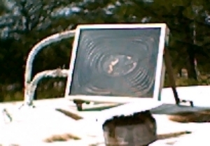

While my Mother and Sister were visiting last month, I had them take a few pictures. Here's one of the solar water heater I made. It took me 9 months to finish, and at the last minute, I tore some of the black plastic landscaping stuff I used as a backing. I tried some black paint to cover the exposed wood underneath, only to find it melted the plastic! That's about 80ft. of 1" black pipe inside it. My neighbor gave me about 200ft. of the stuff! It's hard to see, but I put a small 2-4 watt auto lightbulb in the center that I could turn on from inside if it got too cold. Didn't have a freeze-up all winter! It also had no problem keeping the 95gals. of water HOT. I have a 40 gal. propane heater, and added a 55gal. drum with 1 thickness of R-19, and 1 thickness of R-15 outside of that all around the drum. I kept the pilot light on on the propane heater, so that helped it a little without burning too much propane. I have the stuff for another one, but time & health won't let me get it finished by winter this year.

Some new developements. Getting started on a second solar water heater. Only slightly smaller as the glass donated is 32" x 34".
