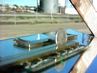

coldspot
  • Posts: 843
Re: Crazy Thoughts or working to many hours
« Reply #6 on: October 31, 2007, 10:05:59 PM »
No,
This isn't an origional idea.
Way Back, 20+ ago when going to ISU for Electrical Tech, we toured "American Falls" Hydro plant. Seeing bolth the old and new then stuff. I might recall seeing something.
But my thoughts mostly came from my liquid cooling/Phase change computer cooling days.
(straight from that hobby to this one)
Here is a couple shots of my memory water block cooling tricks.
Tubing I'm talking about is on the farthest back blocks.
The center ones here.
They arn't in this one but the size referance is shown well.
I never used this little ones, the other ones had much better flow and where used instead.
For a stator made like this we might be able to also use rubber or plastic tubing.
I wish that some body would finish the ceramic split stator halfs so I could try that idea we had. {hint, hint,,..  ;))
