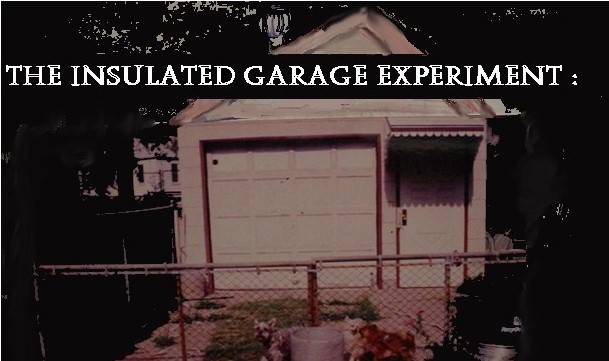

My plan to use UNDERGROUND coolness to cool a building started
when I insulated my garage workshop.  When I started, I had a
building that i wanted to make easier to HEAT in the winter. But
I found an UNEXPECTED bonus.  After adding an attic to the garage
and insulating all the walls with styrofoam, and the attic also
insulated, I noticed in the SUMMER the temperature of the building
had gone down from about 110 degrees before i started.... to about
85 degrees... without any airconditioning!   I realized that the
coolness of the earth from the concrete floor was cooling the small
garage. I didn't expect this to happen.  I had accidentally ALMOST
airconditioned the building in summer without using anything but
the coolness of the earth!   And the coolness was only the SURFACE
coolness, not the REAL coolness located ten feet down of 60 degrees F.

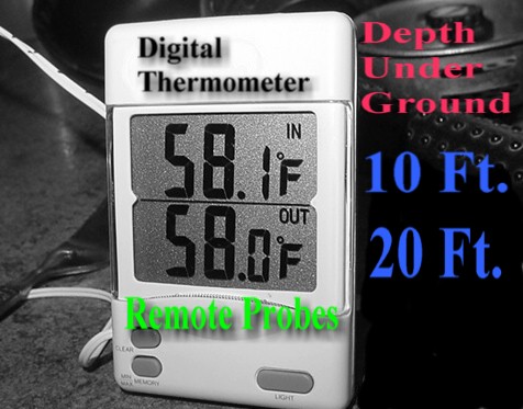

Here is a Dual Thermometer showing temperatures at the TEN foot level
and at the 20 foot depth.  Readings taken at the beginning of summer.

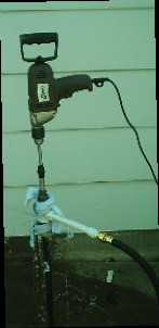

well-drillers, or LOTS of work HAND-DIGGING with a shovel.  One method I tried
was a WATER-INJECTOR drill made out of GASPIPE and attached to an electric
drill.......as pictured here :
This drill took me WEEKS to design and build.... and it drilled a 2 inch wide
hole about ONE FOOT down when the electric drill BOGGED DOWN and stopped !

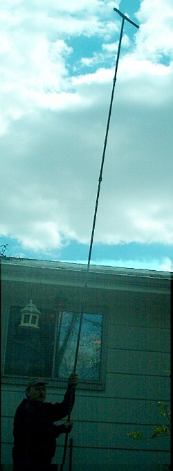

Another method had to be found.  So I tried something an OLD MAN had told me
about...  HE said, "use a TEE-handled hand-powered drill. They are easy to
use and just ADD lengths of half-inch-gaspipe to get down as far as you want."
So I tried it and IT WORKED!
As you can see, I was able to use this drill method to drill down about
20 feet in about 6 hours of drilling.  I was sure to check for OVERHEAD POWER
LINES first before doing this though.  And I kept my small dog AWAY from the
hole untill it was done.  Keep in mind the dangers of working on such a project

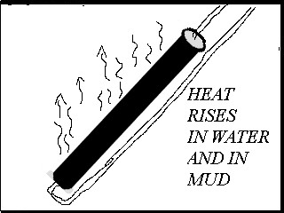

 During my many YEARS of working on this
system, I discovered an interesting thing about HOT WATER that i don't believe
most people are aware of.  Everyone knows that HOT AIR RISES, and COLD AIR
FALLS DOWN, RIGHT?   But did you know that HOT WATER RISES ALSO?   I did
an experiment using a 5 foot long pvc pipe with a cap on the bottom.  I filled
up the pipe with hot water  and placed my temperature probe down the pipe.
here are my results:
       60 inch level........(top)  temperature is 120 deg F.
       40 inch level........       temperature is 114 deg F.
       20 inch level........       temperature is 104 deg F.
       00 inch level........ (bottom) temperature 95 degrees F. !!
I did ANOTHER experiment where i placed some cold water in an OLD glass
coffeepot. then using a little squirt bottle, i squirted some COLORED water
into the BOTTOM INSIDE of the coffeepot.  When I held a candle under the
coffeepot, I could SEE the colorwater RISING up.... proving again that
HOT WATER RISES.  Some of you may say "SO WHAT." but think about it!
If you drill a pipe STRAIGHT DOWN into the ground to use as a radiator
of heat I believe the heat will RISE UP alongside the pipe that you are
trying to COOL!!!  Therefore, I believe the best method of drilling a
heat exchanger into the ground is at an ANGLE... NOT straight down!
Horizontal pipes would work too... if you can get them DEEP ENOUGH where
the real coolness is.

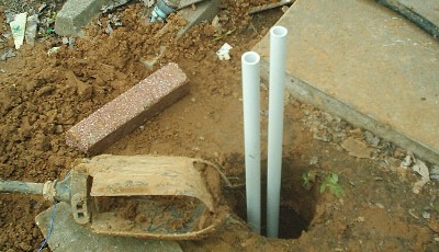

uses a lot of electricity.  Here is a picture of my UNDERGROUND radiator
going into the 20ft. hole.
Like I said at the beginning, this system is a PROTOTYPE.  I don't claim
it is working yet.  Here is my radiator i built, but didn't get much
cooling from it.  I do believe this system will eventually work, but

In your sketch the black part should probably be a section of metal pipe instead of pvc. Metal should loose/lose (for once both loose and lose are correct!) more heat than pvc but it might be worth testing to know for sure, I could easily be wrong.
Cool project and one I'd like to try at some point. I like the idea to slant it too - it makes perfect sense yet it's one of those things I'd have never thought to do. take it easy

I second that. Metal  has a better thermal conductivity(how easily the substance can transfer heat). If you put a metal pipe down the hole then it would be able to transfer the heat to the ground a lot better. Also if the radiator was metal it would work better too.

True, metal conducts heat better, but the metal transfers that heat top/from the soil it faces and that is the limiting factor.  The only way to get appreciable thermal flux from these wells is to maximize the surface area of the soil interface.  Metal is nice but plastic or concrete is great too and the latter two will generally last longer.
Earth tube experiments showed little difference in performance across different "tube" materials.
