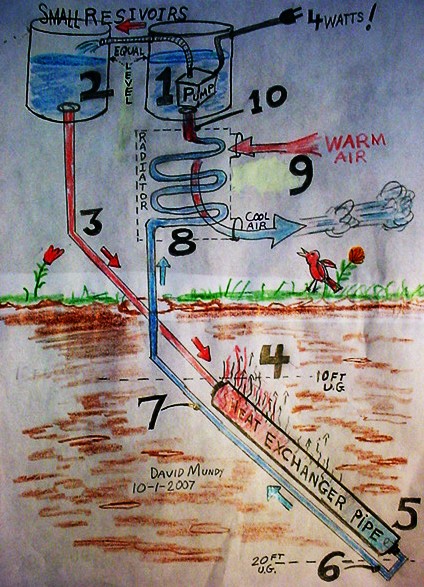

Thank you for all the thoughtfull comments on Part 1 of
my Underground Air Cooling system.  Here is a more detailed
simplified schematic of the system.
1.  Starting at item one, the SUBMERSABLE PUMP.( The kind used
    everywhere in those small water garden fountains). It is a very
    small 4-watt/ 66gallon per hour/ten dollar waterpump.  This
    pump only has a "lift" of 16 inches. But almost NO LIFT at all
    is needed to move the water from resivoir 1 over to resivoir 2.
2.  Water spews into the 2nd resivoir. The water must maintain an
    equal level throughout the system, so the water goes down the pipe.
  1.  Warmed water flows down the pipe into the TOP of heat exchanger.
  2.  Warmest water will rise to top of heat exchanger, coolest to bottom.
5.  At the bottom of the heat exchanger, water should be coldest because:
          A. Hot water rises in the pipe, cool water falls down.
          B. Heat rises in the mud, ABOVE the pipes.
6.  Cooled water begins its trip back up.  Notice the "UP" pipe is located
    UNDER the 4" heat exchanger - not above it!... thats because we dont
    want to REWARM the cooled water on its way back up.
7.  Would be a good idea to INSULATE the pipe on its way up, As suggested
    by one readers comments in part 1 of this article.
8.  Cool 60 degree water enters radiator at the BOTTOM.  Water warms
    as it passes through radiator.
9.  Warm air at the ceiling of the room enters the top of the radiator.
    As air cools it falls down through radiator. Because we are trying to
    cool with only 60 degree water, a larger than usual radiator would be
    needed.
10. Warmed water enters RESIVOIR one... to be pumped again... back to step 1.
In this way,  No freon is needed... No compressor.... No complex electronics
And very little electricity!   Notice though, for the system to work right,
the PUMP must pump water towards the TOP of the underground heat exchanger.
Also the BOTTOM of the radiator pipe must connect to the BOTTOM of the heat
exchanger.  Be sure to mark them before you bury the heat exchanger or you
won't know which is which.  This system is a PROTOTYPE and not proven to
actually work yet.  If you build one, please hold yourself responsible for
all safety issues and blame if it doesn't work.  My system is still under
development and not working yet.  This is submitted for your consideration,
comments and suggestions. thanks from FRAMISTAN

I have not read all the last post but one point seems to be overlooked, earth is a good insulator, therefore the earth around your heat exchanger pipe will soon be at or near the water temp.
The theory around earth cooling/heating is sound but one is dealing with very low grade heat/cool. But at least from your efforts you may expand to a workable system, good luck.

Actually it's not so much an insulator as it's temp changes very slowly in relationship to ambiant air temp. But because it changes slowly you can end up with a zone around the ground heat exchanger that equalizes with the exchangers temp. You end up need a lot of in ground exchanger surface area.

Several things need to happen for a scheme such as this to work. As Allan pointed out earth IS an insulator (well, copper is to just a very poor one) and the earth WILL eventually heat up.
David states he has a 15C difference between ambient and ground temperature he will get effective cooling only until the mass of earth heats. The system will gradually degrade to useless. Unless, there is a moving ground water source under the piece of dirt he is on. A lot of this is covered simply in the link 'Old F' posted.
There are a lot of things that may be done. A plenum chamber with the radiator at the top would allow the cool air to drop, pulling air through the radiator at low or no energy costs.
Systems such as this work only when a lot of factors come in line. The best of these systems will still have the possibility of mold infestation and the need for extreme heat exchange areas. This is a result of the low 'delta T'. I doubt anyone can be found  who is smart enough who will design such a system at low or no charge. If the systems DID work effectively one would see companies in the business of building this age old idea. The fact it is not happening, and there are no 'scam' artists exploiting the concept should be an indication of some kind.

Why do you have two reservoirs? why not just attach the pump outlet to the down pipe?
I agree with the other comments about the ground warming up around your heat exchanger.

I beg to differ.  Soil has pretty low specific heat compared to its thermal conductivity.  That is why it changes temperature slowly.
Stone will also change temperature slowly, but that is because of high specific heat compared to its thermal conductivity.  Stone is a poor insulator over the long term.  Enough stone will average a daily temperature cycle but that's different.  In the winter a stone house will get REALLY cold.
You will want a lot of smaller tubes, not a single bigger one.  The smaller tubes can have similiar surface area, but will "see" a larger volume of soil.  Each tube will set up a thermal gradient in the surrounding soil and at the soil / tube interface there will be a discontinuity (a delta T).  That thermal gradient is a decaying exponential just like a capacitor discharging over time but the thermal gradient is over space.  Far enough away, the temperature is constant and cold.  Closer to the tube the heat is dispersing into the soil and that soil is thereforewarmer.
A good example of this, and a good natural experiment is the thermal gradient of your soil in the late summer.  From the surface to a depth of about six feet the temperature will drop from summertime hot to a cool and essentially constant annual average.  That causes me to think that tubes should be spaced about 12 feet from each other to avoid the tubes "seeing" each other over a cooling season.  I guess that sub-surface soil is denser and therefore has higher conductivity, so twelve feet is maybe a lower bound for spacing.
The thermal "power" you can extract or push will be determined by the surface area of your tubes and the "delta" T of the soil to tube interface.  The thermal "energy" will have to do with the soil volume accessible by your tubes.  That is a volume integral (yes calculus) of the this radial gradient times the length of the tubes.  These thermal gradients will overlap a bit with multiple tubes, but assuming the tubes are sufficently spaced, it will be a small error.  A decent estimate is to simply assume the tubes access soil in the surrounding ~6 feet and add that up.
Figure out the cooling energy you need in a summer and divide that by the specific heat of your soil and then the difference in temperature between the soil and room temperature in celcius.  That will give you the amount of soil you need to push that heat into.  You may be surprised how much it that is....

The reason I show 2 resivoirs is..... when i constructed my
first radiator, (see part 1 and picture of big yellow radiator),
I had problems INITIALLY  filling the pipes to the TOP using
one resivoir, and also problems with AIR BUBBLES getting into
the pipes. The resivoirs allow airbubbles to go out the top.
When I actually build my next radiator, I will have
one water tank separated by a plastic barrier, essentially making
it two tanks in one.  I drew-it-up that way so people new to the concept
can see what I am talking about easier. Lots of people spend 3 minutes
looking at what I have drawn, and jump to conclusions pretty
quick on something I have worked on for years..  I am aware of
 SOME of the problems many people have
listed such as the dirt not being a good conductor of cold/heat. For that,
I have also placed a WATER SOAKER PIPE alongside my heat exchanger. but
I didn't mention it  in the articles. You picked up on it quick though.
This should make the ground wet around the heat exchanger and
make it work better. DIRT is a bad conductor, but MUD is wonderfull.
I very much appreciate everyones comments
though.  I have gotten some really good ideas from all of you.
