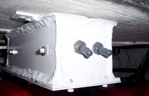

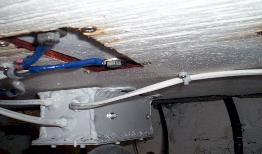

This is where I have the ballasts protected from the marine enviroment.
This is a picture of the housing before paint and final wiring.
Otherside of the ballast box showing switches.

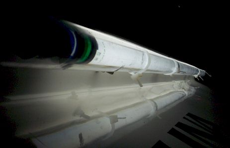

Heres what the fluorescent bulbs look tike in the poycarbonate tube assemblies.

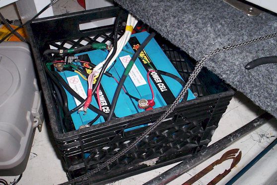

These are the batterys im running on the boat. There great, they can tip over and wont leak.

 Ya, what I really got out of this project, was learning about 12volt fluorescent ballasts, well all ballasts actually. If that wire running down along the tube of the fluorescent bulb is not sheilded by some thin gauge sheet metal that is grounded. It can cause problems for the bulb.
  Now what "I've" learned is that there may be some type of polarity indicator on most standard ballasts output. Such as, for the dc ballast there was a long and short wire of the same color, to go to the bulb.
 However with the ac type ballasts(the type I worked with) had 4 independant circuits with two separate commons to illuminate 4 separate bulbs. 2 red wires 2 blue wires, and 2 yellow wires that were branched to make common on each red and blue circuit(it did not matter which of the to yellow wires went to either red or blue circuit.
 With the ac fixture and ballast there was a 'grounding plane' in the form of sheet metal. I could reverse the bulbs with no conseqence.
 With the dc ballasts one of the output lead wires was running along the bulb, since there was no fixture, the wire running along the bulb could cause some problem for the bulb, because it had no ground plane, sheiding the 'supposed wrong' output wire from the ballast.
 I left the bulb stationary(with the dc ballast, no fixture)(in its orientation :ie the lable facing the same direction) and switched the output leads from the ballast to the bulb.
This immediately seemed to correct what ever was happening to the bulb.
 Apparently if the correct output lead from the ballast is running along-side the bulb, with no grounding plane, it doesnt matter.
I sure wish this possibility was nailed down somewhere in the directions, it would have saved alot of work. Just to know the grounding plane was even useful, for whatever reason, would have made the job easier.

 It is an possibility that the 40watt 60inch fluorescent tubes are too bright, to get shrimp. As the 'shrimp trawlers' were circling around, I had a chance to observe there lights. They were simple incandecents about 60watt, strung out with outriggers about 3 or 4 on each side. They were running a gas ac generator, you could hear it running. I was anchored.
 I use a silver coating on solar applications(and others). Its basically a simple silver re-dox that has been used for years for mirror making. I have coated lightbulbs before with this stuff, it makes one hell of a fullmoon-light color when the bulbs are lit. Or a one-way mirror. Since its 99.99999 pure AG(silver) only a couple of microns thick. I could coat the fluorescent tubes very easily. Just as simply as coating a piece of glass to make it a mirror. But I must stress the silver coating is translucent. And it does not hold up well at all, to anytype of weathering. This is why I think it might be ok in the poly-carbonate tube assemblies.
 I was thinking, not only would this make a fine grounding-plane, when coated on the fluorescent bulb, it would dim the light in such a-way, that the bulbs would become shrimp magnets.(if there not all ready)
 Its funny, because I turned the lights on as I was traveling with the boat at speed(20mph), when I went out last saturday nite. As I hit certian areas, 40 or 50 fish would jump out of the water next to the boat while traveling at speed(whats called a plane).
 Needless to say, this startled the hell out of me. I slowed the boat down to almost a stop at one point, turns out they were needle fish. several swam straight up to the lights, I got a good look at them, could have netted them if I wanted too. Perhaps some were ladyfish, these were easily 2 feet long.
 Well, we'll see how well the lights work for the shrimp as they are, if it turns out the lights are to bright(can you imagion me getting this far with this?) I will do a part 4 with the silver coating on the bulbs.
