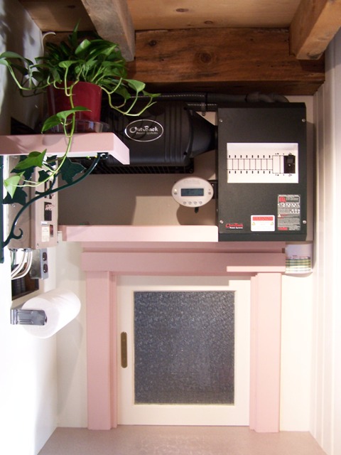

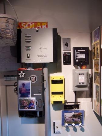

We set out this year to transition the system over to 48VDC in anticipation of the new axial-flux (details previously posted in my diary), but we have numerous low voltage circuits and devices, including lights, water pumps, refrigeration, etc.  Here's the progress thus far:

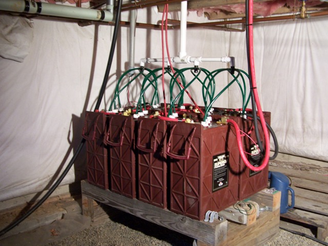

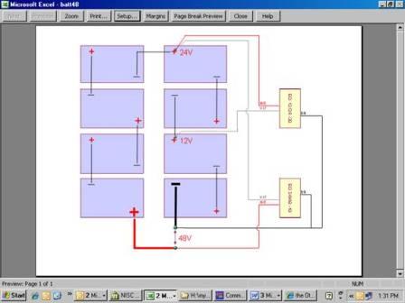

We installed a 48V Outback inverter this summer, and rewired the battery bank for 48V, currently with both 12 & 24V taps.  The batteries are balanced using two, Solar Converter's "autotransformers" (equalizers) wired like this:
The Sencenbaugh, and presently the PV's, charge into the bank at the 12V tap.  This is also where most of our lighting, the refrigerator and a number of existing small loads are tied.  It's less than ideal for charging - we're only utilizing a portion of the available battery capacity directly - but although the equalizers are small (the 12V is current limited to 20A; the 24V is limited at 10A) on average they seem to work well within some reasonable restraints and load management.  As designed they allow one to consume, or produce, at considerably higher rates for short durations, and still balance out over time.

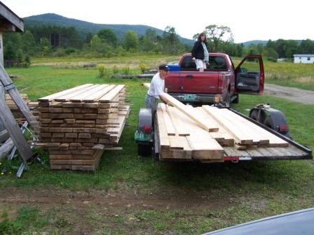

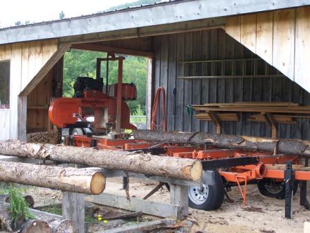

We're still muddling through many of the details on the wind generator - and learning vicariously through the experiences of folks here - but we wanted to get some lumber drying for the blades.  After a bit of research we selected Balsam Fir as one of the better locally available species.   It wasn't immediately intuitive that this would be our choice - I generally think of it as being pretty soft, and compression strength perpendicular to the grain is low (which concerns me a bit) - but it has good a properties in bending and particularly horizontal shear relative to it's weight.  And, it fulfills a lot of our parameters- locally available, light, easy to work, moderately strong.  White cedar was a possible candidate too, being lighter, but is a fair amount weaker.  The properties for the Douglas Fir might would appear to bring the strength to weight ratio up to that of Sitka, but I don't think we need the extra strength and the extra weight will be a penalty.  So this spring I cut a few logs and my friend Mark did a nice job sawing them out.
Some are solid blocks, presumably for the early run, the final set(s) will be laminated.
