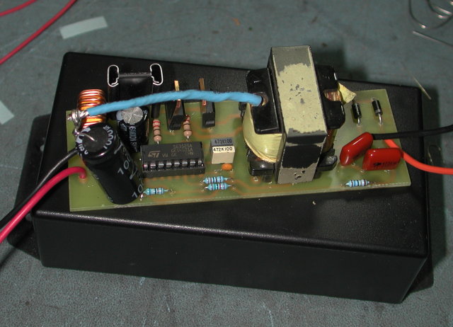

This is something I mentioned here on FL quite some time ago now; using the main transformer out of a pc power supply, and running it "backwards" to generate a high voltage for driving CFL's.
The original secondary winding centre tap goes to positive 24 volt supply. Fet to ground off each of what used to be the 12 volt taps.
The original primary winding now becomes the high voltage output. In this case I used a voltage doubler rectifier, and set the feedback voltage divider to give an output of 240 volts dc. The controller chip is an SG3525, running at 50KHz, although you could use the TL494 salvaged from the same junked pc power supply; although you'll need to add the totem pole driver stage for each fet. Output voltage remains near enough to constant over an input voltage range of 20-30 volts, tested driving an 18 watt 240 volt cfl. Side by side testing using a matched pair of 10 watt lamps, one driven off this inverter, the other plugged into the 240 volt mains, shows a barely discernable light intensity advantage to the mains powered lamp. I'm also powering the controller chip off a 7812 regulator, which does need a small heatsink.
A 12 volt powered version could be built, though you would probably need to connect the fets to the 5 volt taps rather than the 12 volt taps.
The circuit is similar to that published in Silicon Chip magazine in September of 2004, which is also available from Oatley Electronics as kit 111b for AU$27.00.
I did the pcb layout to slide neatly into a UB3 jiffy box. It goes in vertically between the posts which the lid screws to, and needs no additional hardware to hold it. The jiffy box has a flanged lid for mounting. I will probably make several units with 2 lamp holders attached directly to the ends of the jiffy box, one each end. Then screw the jiffy box to a piece of 3 inch wide timber painted white, and call it a lamp fitting.
This particular board is a little rough; it is a prototype after all. I have re-done the layout to tidy up all the little changes, but haven't etched a new board yet.

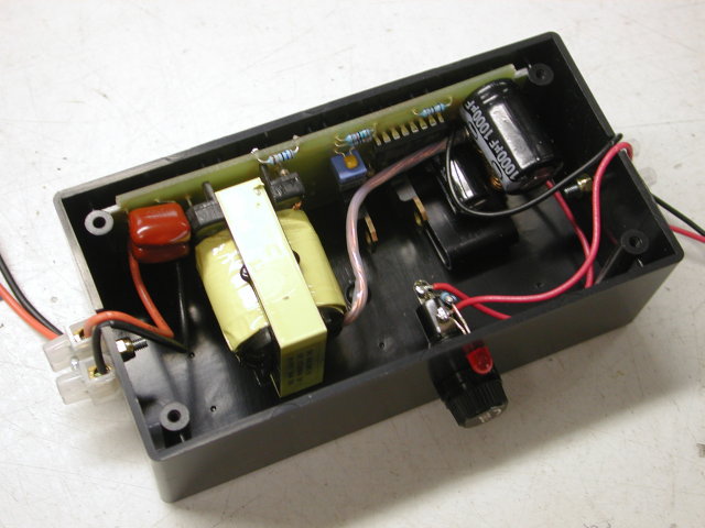

And one last photo of the pcb inside the jiffy box.
Fuse on the incoming dc has an led and resistor across it so if the fuse should blow the led will come on.
Notches in the corner of the pcb are to clear the moulding in the lid of the jiffy box.
This is now the second one I've built. Both been running all day every day for a while now. Side of the box runs slightly warm to the touch, about 40 deg C. Most of this comes from the 12 volt regulator. If building these for a 12 volt system you wouldn't need that regulator at all. Might even change the regulator to 15 volts.
Still refining the pcb layout; should have it perfect for the third unit. I haven't uploaded the layout as yet, just ask if anyone wants a copy.

Since I've now gone with a 12 volt battery, I've modified my 6 units to run off 12 volts. Removed the 7812 regulator, and changed the taps on the transformer I'm connecting the fets to. Running a 13 watt cfl, the fets with no heatsink see about 15 degC temperature rise.
And to answer a question. The output is set to 240 volts, not 340, because of the turns ratio of the transformer. 240 volt cfl's work just fine on 240 dc.
