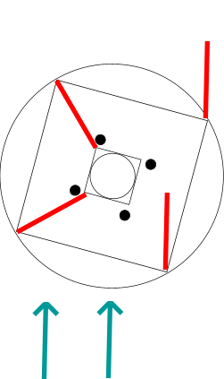

Hi Guys,
I have built a number of VAWT prototypes. I am achieving lots of torque with about 45rpm at 12kph winds with 10sq meter sail areas. My Vawt is similar to US PATENT 5525037 dated june 1996. http://patft.uspto.gov/netacgi/nph-Parser?Sect1=PTO1&Sect2=HITOFF&d=PALL&p=1&u=%2Fne
tahtml%2FPTO%2Fsrchnum.htm&r=1&f=G&l=50&s1=5525037.PN.&OS=PN/5525037&RS=PN/5
525037
The big issue is power generation. Due to the nature of wind fluctuating - and the requirements of generators to have fixed hi revs with plus or minus 10 percent tolerance I am looking at alternate methods.
One idea is steam. If a turbine could heat water to generate steam, it would provide a simpler system to link multiple VAWTs. The steam could also be directly employed to heat my home - provide hot water - drive compressors to provide air conditioning and refrigeration - as well as drive a steam turbine to provide main power and dump surplus to the grid.
I am experimenting with rotating cavitation drum water heaters to heat the water.
Has anybody else gone this route with VAWTs?

Oh forgot any pics of the turbine?
« Last Edit: January 09, 2008, 04:39:32 PM by vawtman »

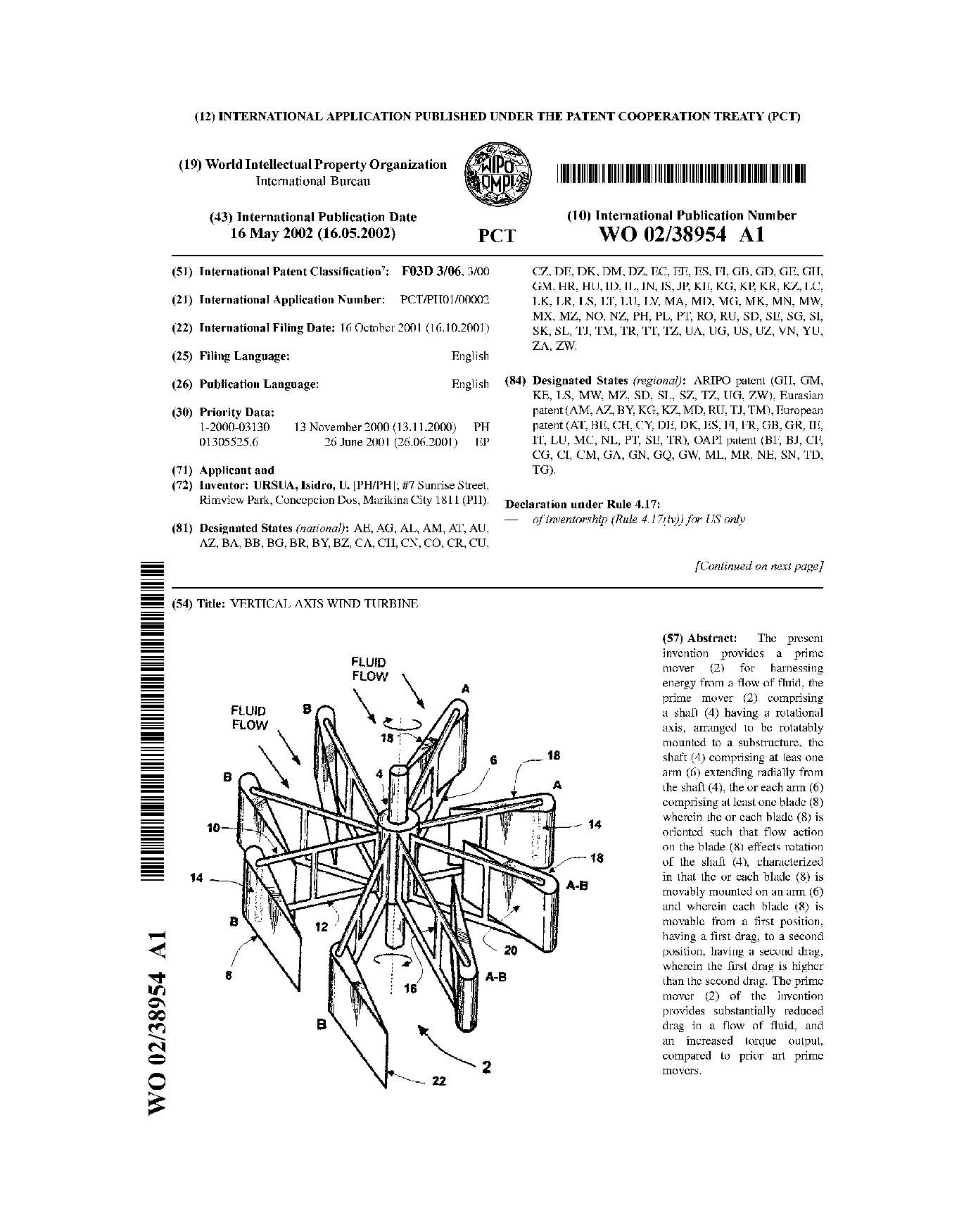

Hi Vawtman,
I cant show my actual windmill (prov patent only) but I can show an earlier prototype animated gif I made - here tis http://www.otherpower.com/images/scimages/8568/animatedgif.gif.
This turned out to be a 2001 patent already in existence see http://www.otherpower.com/images/scimages/8568/au2002214421_Page_2.jpg.
My current windmill has similar performance.
If Vawt energy can be converted to hot water with greater than 30 percent efficiency it would be more efficient than my current method of driving a generator with a 100 to 1 gearing and dumping the power to a heating element in my hot water tank.
This would also make using multiple VAWTs easy - they would simply add to the hot water storage near the house with insulated piping. Much simpler than linking multiple generators with variable wind complicating things.
