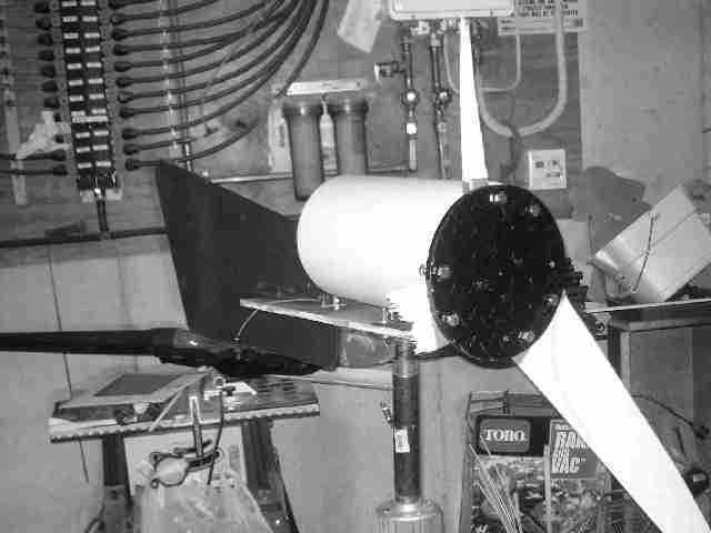

It Has been 3 mouths in the Making and finally its in the wind.
I started making a wind mill as a Toy for something to do something
to play with to keep my mind occupied.
I started reading web site after web site and then reading that same
web site over again. Trying to find information about how to Build the
home brew wind mill. Not only Reading But Then I started to Look for things
i could use to make this thing Fly. Things just around the house Wood,Metal,Pipe,
Old Tractor parts.
Then it started to Get bad, As I was driving Back And forth to work or
anywhere as far as that go's I was on the look out for STUFF.
Letting Friends, Family and Co-workers Know what i was doing and if they
knew of any place i could find Stuff. One Co-worker came up with an old
DC motor 90 vdc Daton. (free). My dad found a Aluminum plate 1/2 thick
Great for mounting the Motor on and making a disk and hub to mount
the Blades (free).Someone else had an old Road sigh great for the Tail.(free)
I Got it Now (WIND MILL ON THE BRAIN).
I found some old 4" pvc pipe at the house for the blades. Now i was set
every day after work down to basement i would go Reading and trying different
things just to get this thing working.
4" Pvc 24" Blades worked okay BUT I needed to go Bigger. So I went with 6" Pvc
blades, pvc at the time seem to be the easyest to make. The 6" Pvc 30" Blades
worked Okay But still not what i was looking for. Starting Looking into wood
Blades and how to make them. Seam like alot of work and a real pain to do
till i got started.Yes there is a lot of trial and error.The first wood blades
worked very well 1"x6"x30" long. Now i got it together and made up a test
stand out of some iron pipe and a 4x4 post to set it on. I can take it outside
now and test it after waiting 6 days for wind (it works).
Hooked up a 12 volt flash light bulb to it and it lite yeha. But that put a
big load on the motor and stalled it out(Fast). So i thought i would let it
out to see how the blades held up. That day i was at work and we got up to
50 mph winds Thats all i could think of windmill windmill windmill.
Well here is a Pic on how that worked out for me. A Free Wheeling Wind Mill
IS NOT GOOD.   More tomorrow

Interesting project, thank you for sharing!
I removed your picture though...  you should resize and repost it, it was almost 1mb in size, the limit here is 150kb.  Folks with dial up connections were complaining.
Free wheeling is not good for sure.  Also - not furling didn't help.
Another thing I notice is the way its mounted to the post there...  threaded pipe like that has about half its wall thickness at the bottom of the threads(a bit more or less depending on the size of pipe) and about 1/4 the strength it would have had it not been threaded.  You might be lucky the pipe didn't snap off at the threads!
