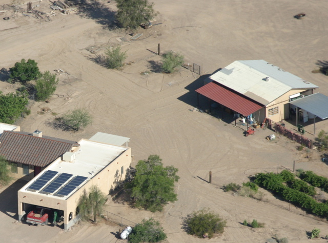

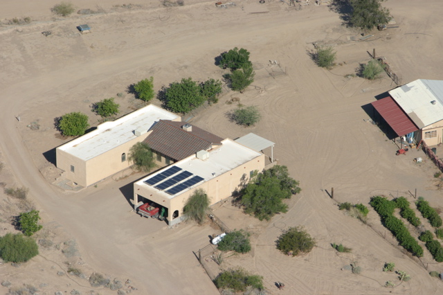

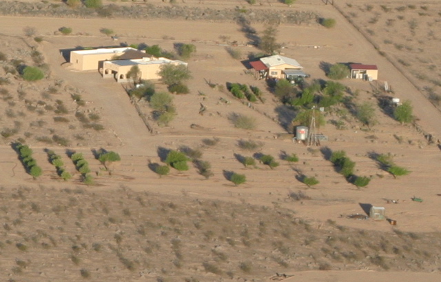

I am living off grid and have been for about 2 years. I know a little more than I first did but not much more. I hope to better understand DC electricity as it relates to solar power.
At the present time I have 2880 watts of solar panels and will be adding another 1440 watts in the near future.
I will try to post some pics of my house.

Wheeler, thanks for posting, especially the pics.
I can't imagine anyone would hassle you about putting up a wind-gen (a common problem) and the flat land with few trees seems like a good location for one...

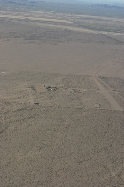

Wow, talk about being in the middle of NOWHERE!  I would sure hate for the wife to forget to fill the car gas tank and extra gas cans.  Looks like quite a walk.
Nice solar collection array.  I'm sure you get very good sun and wind out there.  Looking forward to your projects in the future.  Thanks for sharing the photos.
Ever think about being the first to make a 100 foot diameter mill??
(Just keep glueing a bunch of 2x4's together until each blade is big enough)

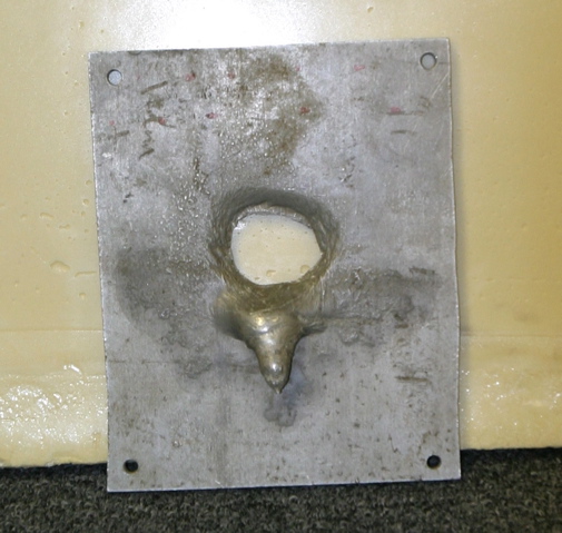

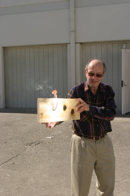

Brew;
Here is a project some friends have been working on for some time. Last week they brought over a petal out of a parabolic collector and showed us how it concentrates energy.
The last picture is when the collector was assembled and focused on a piece of 3/8 al. plate.
As time goes by I will post more pics.

Wheeler,
Great pics.  Nice slice of serenity.

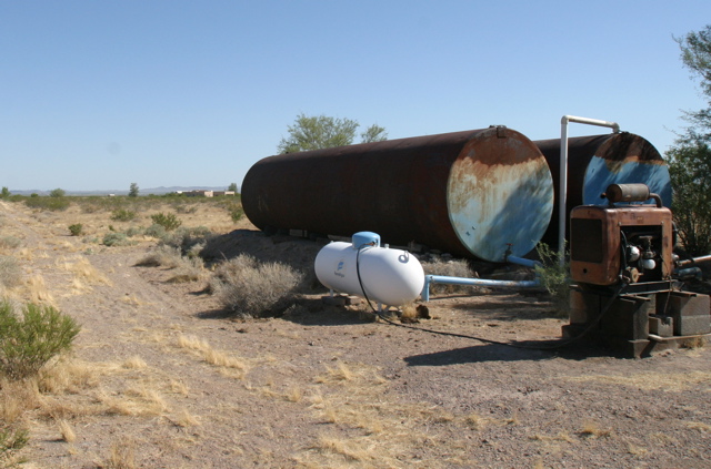

Kite:

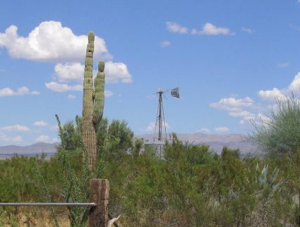

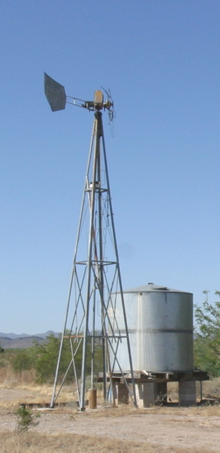

I have two wells, the main well produces 150 gal. per minute with storage of 25,000 gal. and is ran by a Ford tractor engine running on propane.
The lower well has not been used since the wind mill fell apart (before I purchased the property) I plan on fixing it when I learn more and collect some money.
The aquifer is at 180 feet and the wells are about 280 feet deep.

Wow, that's impressive.
I was expecting that the depths might be alot deeper.  I would think that would be well within the range of capabilities of some of the better solar powered deep well pumps available now (600-750' are out there).
We've used a Sun Pumps (Safford, AZ) DC pump for years with good results, but our static level is only about 60'.
You might also be interested to see the article in Dec/Jan Homepower (#122).  A fellow named Kevin Moore describes rebuilding a wind pumper.

Yes that is an airstrip, about 2500 feet in length, that is one of the first improvements I made to the property. My plane is a 1946 Aeronca Champ, I keep it in Parker until I can fund a hangar.

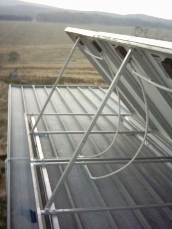

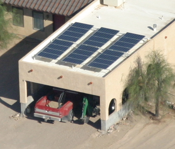

I have a feeling the "3 in a string" is related to shading and/or improper mounting.
Shading sure doesn't look like a problem!
I would be concerned about the heat under the PVs in OH, let alone there!
Might want to get them to at least a 15 degree tilt to the south.  Even if it mean re-drilling holes and doing a bit of rewiring.
Better perfomance.  Longer life.
Might look into some kind of controller that runs an attic fan when the batteries reach X-volts. Or whatever.  Lots of ways to use DC better than AC.
CmeBREW's fan is a grand example of using DC...

I plan on moving the solar panels (after I replace the roof) to the building behind the house. The angle of the roof appears good and I have enough space on the roof to accept all 9 arrays that I currently have.
 With all of the Kyocera panels I will have 4320 watts of rated power and with a back up generator and 16 L-16's I should be set, or so I think.
The panels are not mounted directly to the roof, the space between the existing panels and the roof is about 18",  I will stand them off when I move them, how much space do I need?

  Welcome to the Other Power discussion board. I have really enjoyed reading your post and seeing the great photos, something many others here will enjoy and learn form besides.
  I have been here for many years and currently am rebuilding my 18' axial alternator that has been inspired by and much copied from the Dan's the originators of the board. You will meet many helpful people here and there is a lot of combined knowledge on many different aspects of AE.
  What type of basement wall do you have and how deep ? Thank you again for posting, I look forward to your future contributions.
  (I couldn't help but feel I could "hit" your strip on base ready to turn left on final, I soloed twice many years ago in a Blanik sailplane here back East. A little more anxious though over the trees and dropping it in on 1000' less for the first time.) Thanks again for sharing.  Dave B.

The 18" is good.
Probably want them tilted south.
And spread out so they don't shade each other.
Jeeze.  Thats a lot of power.

Thanks for the advice, My system consists of 24 KC-120 panels wired as 48v per array feeding an MX-60 controller. I have 24 Trojan T-125 batteries in series and parallel that power a Trace Ps 25/24 inverter. I have another 12 KC-120 panels to be installed soon. Wheeler
This might be a silly question, but why have you got your panels wired in a 48V configuration to feed your 24V battery system?  If your panels are the same as these ones then you should have them wired in pairs to feed your 24V battery system:
http://www.solaronline.com.au/cgi/index.cgi/shopfront/view_product_details?product_id=1107358708
Doing that will double the power you're harvesting from them.  I also run a 24V system, but my panels are 24V each so I have all 4 of them wired in parallel:

Wheeler
From the looks of the tail your water pumper is an Aermotor
There still in around.  Heres there link
http://www.aermotorwindmill.com/Links/Index.asp
Welcome the board

Because he has a MX60.
My panels are also wired for 48V into a 24V bank.
The beauty of MPPT.

Farmer, yes you are correct, I was using three trace controllers and noticed that all would not be producing the same power.
When one or more went into float mode and another was still producing power I thought there must be a better way.
I started reading the Outback manual and realized I could control all 24 panels if they were wired at 48v.  With my limited experience this made sense to me, when I install the remaining 12 KC-12 panels and purchase a complete Outback system, I might need to use two mx-60's, although I am not certain of this.

The tail reads "Fairbanks Morse" I am not sure if this is the manufacture or just a name.  I try to remember to do a search when I get on the net, only to get side tracked by other interests. Now that propane has jumped in  price, I should at least find out more about getting it fixed.  I will check out the link you posted, thanks!
