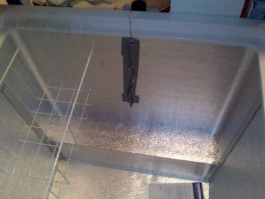

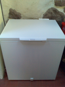

Spurred on by some of the conversion threads and the fact that our Fridge/Freezer combi went phut I decided to convert a chest freezer to a fridge.
I wad going to buy an electrical controller when I saw on eBay a mechanical thermostat controller.  This I think is used in heating / cooler systems and consists of a thin copper tube connected to a thermostat.
I put this in a plastic box and fixed it to the back of the freezer.  I cut an extension cable in two, wired the plug half as the input, and the socket half as the output.  It was a simple matter of threading then cooper tube into the freezer, plugging the freezer into the socket and the other end of the wire into the wall and away we went.
For the first few days I monitored the power consumption with a 'Kill-a-watt' type meter and is uses a maximum of 160 watts in 24 hours, a great improvement of 1200+ watts for the original combi.  The next plan is to buy an efficient freezer.
The Thermostat
The box wired up
The sensor stuck down with duct tape.
The completed fridge.

Nice work.
I'd be a bit concerned about the thermostat running the motor directly.
Might want the thermostat running a large heavy duty relay.
Are there any HP ratings on the thermostat?

Well done! Saw a thermistor + relay solution in Silicon Chip, an Aussie electronics mag. From memory thermostats drive the motor directly of fridges and freezers as they have rather large contacts, but if you are concerned you could drive it via a relay.

Look at the specs on that control. It's rated at 15A at 240V. It will work fine in this application without a relay.

I checked out the thermostat before I bought it.  It is rated at 15amp at 240 volt, so plenty of juice for this.  I think they are used for A/C or Hot water elements.

It is an inefficient freezer.  It is only a class 'B' rather than a class 'A' or 'A+', but that was a trade off on price.  We only paied 250 euro against 400+ euro for the more efficient.

I see one possible problem with that. Refrigerator thermostats generally sense air temperature. Chest freezer thermostats have the sensor shoved into a long tube along the evaporator coil. While it might work, the differential for an air sensing thermostat and a surface sensing thermostat might be different. Results might be large swings in interior temperature or compressor cycling in too short of intervals.
