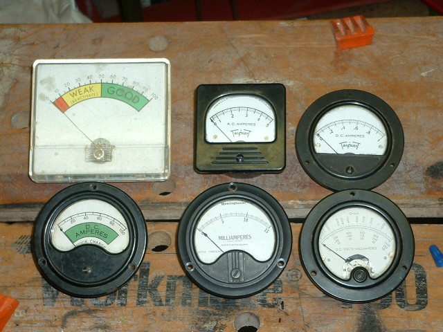

I've been looking for some analog meters for my two systems for quite a while.
Since there are two systems to outfit and my philosophy is ' if it's free energy lets try to get it free ' (or as cheaply as possible) I do a lot of scrounging around.
I went to a HAM festival / swap meet over the weekend and one fellow had a $3 bin full of old meters.
Top left was $1 and it takes a 2k2 resistor for 15V full deflection - perfect!
Middle top was $2 and all it took was a bit of silicon to glue the glass back in.
The rest were $3 apiece.
Two Tripletts, one Westinghouse, one Barnett and two No names.
I'm so happy!

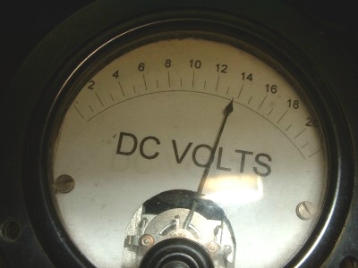

« Reply #10 on: March 21, 2008, 06:24:39 PM »
Thanks again BT,
Nice easy program to use. You did good.
Sorry about the blurry pix.
« Last Edit: March 21, 2008, 06:24:39 PM by FishbonzWV »

Here's another example of BT's program at work.
This was the bottom right meter(Weston)from a VOM. I found through trial and error a 17k5 resistor gave me 22 volts full deflection.
This Triplett was a 1 Amp meter so I cut the internal shunt and added an external one using 18 inches of 14 AWG solid core wire. Started with 24 inches and kept cutting off pieces until the amps matched my fluke meter at 4 Amps. Then I just used white out correction fluid to make the dots disappear and added a zero to the end 1 digit.
