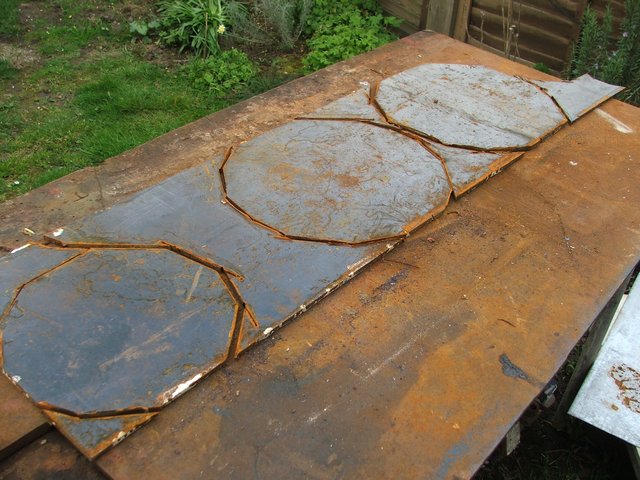

  this is three rotors cut rough for turning.
  one 9" and two 12".

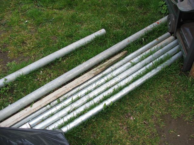

    i have got myself sum pipe and tubes for the tower or mast.
     trying to work out how much concrete i will need and whare to put it yet.

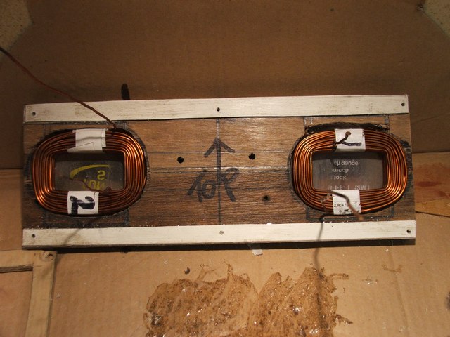

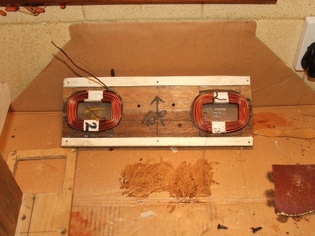

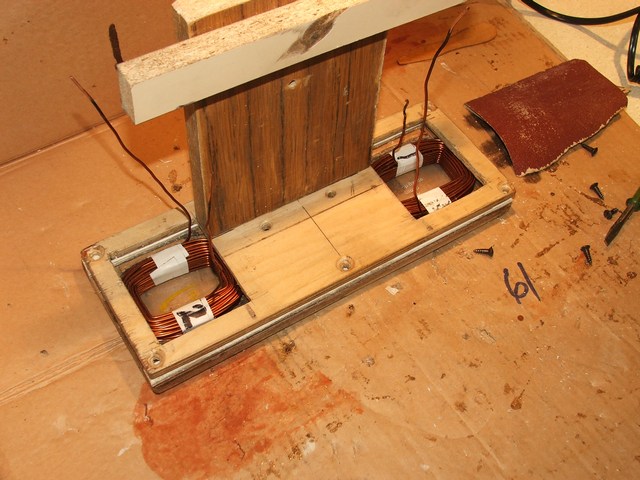

    other things i have been doing are playing with coils.

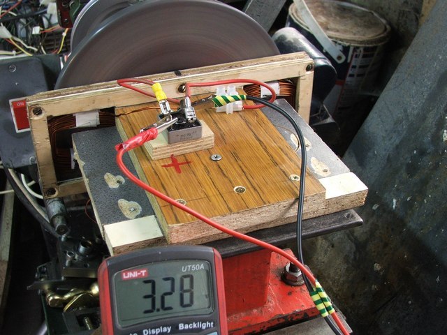

    taken the other mill apart and yousing the single rotor for testing.
    very happy with what im doing .
   the testing of a single coil was fun so thought i can try two.

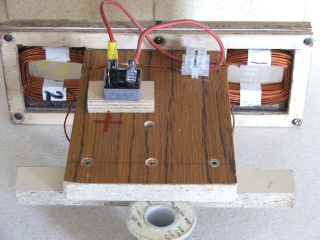

  testing the AC is good .but with the rectifier in line for DC . i lose a bit voltage.   its two coils so one phase.  i understand this would be called jerry rigged.
  but with three phase star connected .it will still have three rectifiers .
  am i right in understanding if it was jerry rigged .i would lose 1.4 vots three times ?
  and with star only lose 1.4 volt.
   and dos the name jerry rigged come from jerry on this site.
  or is there another reason its called that.

   testing  with a single rotor and testing with a double rotor.
   will i have twice the volts from the double as i get from the single.
  in time i will know the answer to this .
   but for now it would be nice to know .

The 1.4V thing.  I'll try.
It still only looses 1.4V. Total.
It looses 1.4V per phase.
With 3 phase star and 12V, it lost 1.4V at the battery.
With 3 phases, Jerry Rigged, each phase lost 1.4V.  No matter.  The loss is parallel, meaning the 1.4V is there 3 times but next to each other (not in a row).
Silly example, but the best I can compare it to...
I have a 60" long 2x4.  All 4 sides measure 60".
I cut 1.4" off one end.
The 2x4 is now 58.6" long.
All 4 sides are 58.6" long.
It did not get 5.6" shorter because it has 4 sides.  (1.4 x 4 = 5.6)
Jerry Rig treats each phase as a seperate single phase PMA.
The 1.4V is cut off each side.
Star is measuring things caddy-corner.
Hope that helps.

   i paid £30 british pounds for the 8mm steel plate. i got 2 9" discs.
  2 12" discs. it was new plate and a nice bit stuff.  but not long ago it would have cost much much less.
   the test coils i was running at 330 rpm . thay are what i will use on small twin rotor. 9"
