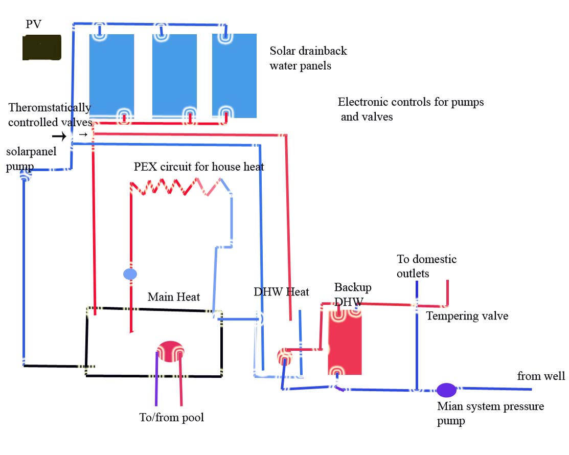

This my first diary entry. After a few posts, I thought it might be easier for people to follow my what i want to do if I put my stuff in the diary.
Right now, I am finishing up our house in NB, Canada (cold climate similar to northern Maine, USA)
Basic description: 2 acre (0.8 ha) lot. 28 x 40 ft house (length facing a bit east of true south), 1 full basement insulated with 2 inches styrofoam boards beneath the slab and outside, 2 full stories build of 2 x 6 insulated with glass wool batts and 1 inch foam board, good poly vapor barrier sealed around windows and floors, 1 half story attic (16 x 40 ft) insulated with 18 inches of filled cellulose. Roof sloped 11/12 towards south. Most windows on south side, all windows triple glazing, argon filled, lowe glass. Outside finition all vertical ship lapped locally sawn tamarack. Inside floors oiled tamarack and local slate.
Heating system: radiant water pex tubes beneath floors heated by electric boiler. One circulating pump, 6 zone valves. Wood burning 0 clearance efficient fireplace for back up.
Water heater: regular electric tank with two 220 volts soaking heater elements.
Lighting is in transition from incandescent to cfl, about 1 third replaced.
Next Summer, four years after construction, I will finally be able to install the clothesline.
Someday, I'll convert a gas powered car to electric. Someday, I'll build my own wind turbine. But that's not for tomorrow...
For the near future, my aim is to install home-made solar flat-plate collectors and a big home-made wooden storage tank to heat up water for: space heating, domestic water and accessorily pool heating. Here is my tentative flow diagram:
power point file
Additional details
Total rise from collectors to storage tank will be about 35 ft.
Pool is 21 ft diameter out of ground
I still have to determine:
  • area of collectors
  • length of copper coil heat exchangers
  • length of dump load heat exchanger
  • pump power and solar pv panel wattage
  • how to manage moisture exiting the storage tank
  • if my actual heating system controller can manage additional pumps, sensors and valves
Any comments? suggestions? additional questions?
Martin

 I'm not really understanding your flow on the pool, but why have separate coils for your PEX heat loop and your pool? you should just use the tank water for the PEX loop.(i may be confused by what you're doing there) Used simultaneously I doubt it would keep up with both loads.
 I'm guessing you only want to heat the pool when the house doesn't need heat. Also is there really a need for a tempering valve on the pool loop?
 Sizing would have to be determined by your local solar insolation, and btu's required to heat your house. I believe you'll find information on that at:
 http://builditsolar.com/ you may find some other ideas that will help there.
 You may also consider a separate system for Domestic Hot Water since at times you'd have a usable heat in your tank for interior heating that would be lower than you could use for DHW. That would reduce the energy usage from your backup heating. Also you'll be using that system year round. Consider, interior heating can be used down to 75 (a stretch) which wouldn't be very useful for DHW. Even temperatures as low as 90F wouldn't be of much help (except for pre-heat) in DHW.
 Some of your arrows seem to be indicating the wrong flow direction.(bottom for back-up tank, between Dc pump for solar panel and exchanger loop.
 I'd also eliminate the float valve for filling your tank and use a manual one and have  a way to know what your water height is.
 Confused by a few other things,also i see a hot line just dumping into tank from DHW circuit? Or is that a pickup line for your PEX? DO NOT EVER mix an anti-freeze solution and DHW. you cannot even switch lines over..so that one is confusing.
 In a nutshell,solar to storage, pex loop uses tank water,DHW would be better off with a separate system (you could use a heat exchanger to add heat to main storage if the DHW has an overabundance)PV for pump power, and determine sizes which without a LOT more info we cannot do for you.
 Oh and looking again, why is there an exchanger loop from the solar panel? Aren't you planning to use an antifreeze mix for the storage, PEX loop, and Solar panel water?  I'm also not seeing a reason for the dump load under the driveway.
 If you used a drainback system for your collectors, you could eliminate the need for anti-freeze, also.

Mbeland,
Good you have done some home work.
You should have asked this before you built. Why?
The 2 inch foam board below slab was not a good investment.
Insulation saving is based on the delta temperature, 50 vs 70 is called never pays pack.
Dry ground is an insulator, why below ground homes were popular.
Side walls as you go up should have been thicker, specially above the frost line and the exposed area should have same R value as outside walls.
Based on your perceived goals my feedback: (I agree with zeusmorg post above).
Tank is too small, heat storage is less than one night at worst case conditions.
No antifreeze in the tank, need double walled heat exchangers for most codes.
Using potable water in the tank a single walled heat exchangers will pass. (as long as you can prove  always potable water).
Nothing wrong with wood tank if it has a liner. Difficult to make water tight.
Since I do not know your numbers estimate based on mine.
My home in Michigan has insulation near yours, 1350sqft.
92% 76KBTU/hr forced air furnace, worst day -23 deg F five days in a row, Furnace run time 23.5hr/day. My basement walls have 1 inch above grade and 4 ft down. Payback was too long to go lower. Broke when completed my house.
Natural gas Tank less hot water is 117kBTU/hr. Unlimited hot water great:-) Can make for nice backup heat. I not setup for it yet.
18,000 gal pool. Heater 140KBTU/hr raise temp 1 deg F per hour.
Very expensive to heat with electric, no wonder your interested in Solar heat!
Largest heat load is the pool, only used for a few months a year...
Have you checked out the links at www.builditsolar.com?
Have fun,
Scott.

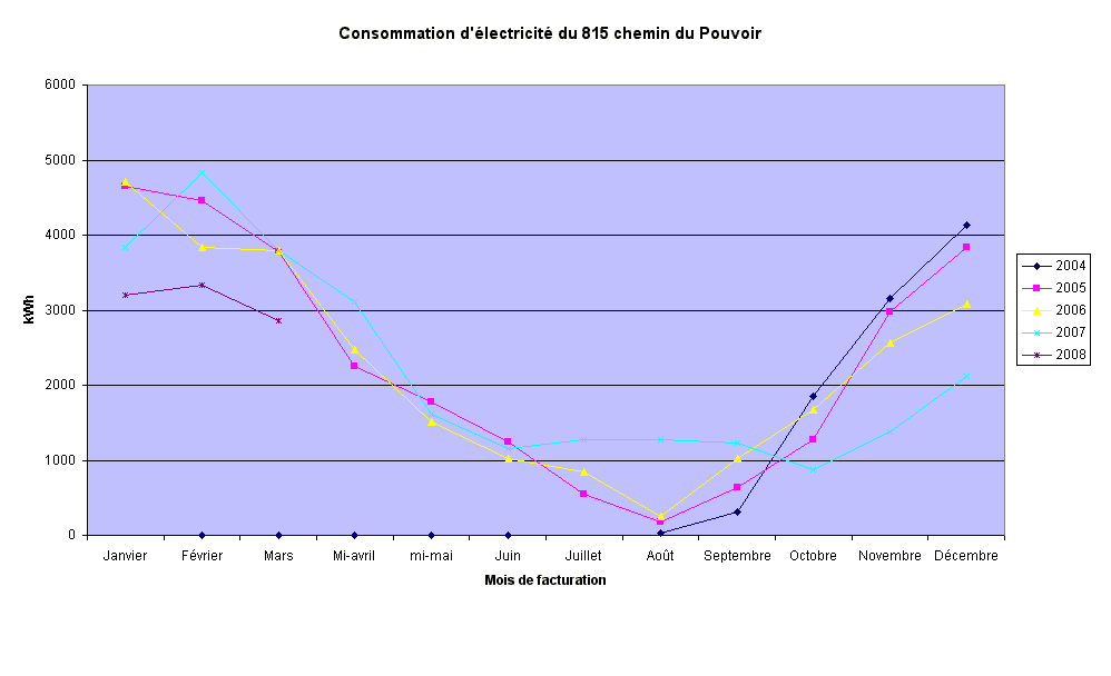

mbeland
  • Posts: 80
Re: First diary post: house description and tentat
« Reply #9 on: April 23, 2008, 07:11:19 AM »
Hi zeusmorg,
"I'm not really understanding your flow on the pool, but why have separate coils for your PEX heat loop and your pool? you should just use the tank water for the PEX loop.(i may be confused by what you're doing there) Used simultaneously I doubt it would keep up with both loads."
My plan that maybe was not clear on the diagram is to prevent pool water to go into the storage tank because of corrosion issues. That's why I put a separate heat exchanger coil for the pool. I thought it should be made of pex. The need for the tempering valve is because since the system would be sized for winter heating, I think I will have more than plenty heat in the summer. That is also why I planned for a dump load under the drive way. My roof is very high and I will not go on top to cover part of the collectors in the Summer.
A separate system for domestic hot water and heating may be a good idea. I understand here two separate storage tanks but one single set of collectors that would be directed towards domestic hot water in priority. One may be bigger wooden for heating directly used by the radiant heating loops and the other smaller and pressurized for domestic hot water.
I will check the flow directions and post an improved diagram soon.
The float valve for filling the tank was to make the system as maintenance free as possible. I understand if there is a leak somewhere, I need to be advised so things need not be totally automatic.
I plan to use a heat exchanger loop from the solar panels because I didn't want to have such a big amount of concentrated antifreeze. The amount I would put would be just enough to make it less prompt to grow stuff in the water but not as concentrated as in the solar loops. The other reason is that I was told the collectors prefer to have a pressurized system with no oxygen renewal and I would then need a big pump to be able to push 35 feet of fluid up to the collectors. I understand putting concentrated antifreeze would make the system more efficient though: better heat transfer from collectors to storage tank.
 I didn't think drain back would be adequate to heat space during winter.
Thanks for your comments
Martin

  • Posts: 80
Re: house description and tentative flow diagram
« Reply #11 on: April 23, 2008, 07:44:12 AM »
Hi again Scott,
Here is a plot my electric bill for the last 4 years.
Base usage in the Summer is approx 1000 kwh/mo (a lot of work to be done to lower that uh??)
Peak monthly usage in the Winter is around 4500 kwh/mo but lowered to 3300 kWh/mo with partial wood backup. If I substract the base usage, I get a peak monthly heating load of 3500 kWh/mo or 2300 kWh/mo with wood backup. So I guess, if I planned for 2300 kwh/mo, I would be OK. That would mean an average of 77 kWh/day which is equivalent to 3.2 kW.
Is this ok? where do I go from there? I guess I need to account for cloudy days and inherent variation in solar input...
Martin
« Last Edit: April 23, 2008, 07:44:12 AM by mbeland »

zeusmorg
  • Posts: 363
Revised system flow
« Reply #15 on: April 23, 2008, 01:30:39 PM »
ok, I decided to do a quickie diagram eliminating unneeded things and adding my suggestions.
 To help describe some things, there are two thermal valves to switch from main storage to Domestic Hot Water exchanger storage. A pv panel to supply power for pumps. A tempering valve to insure no scalding water is present at DHW faucets. A heat exchanger for pool,and one for DHW to insure no contaminants enter the DW supply.
 I still prefer drainback for freeze protection , and to make the filling costs cheaper.You'll also notice a pipe(not labeled) between the tanks, this should be slightly above the normal water level, to allow the two tanks to balance their levels..
 I also forgot to add a fill and overflow..oops, and didn't label the house heating circuits pump.
 For simplicity I didn't show any wiring.
 You are obviously mis-reading something my suggestion for using 1 heat exchanger was you COULD switch between the house heat circuit and the pool circuit IF you do not require both at the same time. You NEVER (ever) EVER!!!!! mix ANY water (or switch between pipes that use it)that could possibly contain contaminates with your DW system..PERIOD.
 System usage: PV runs pump when solar insolation is high enough to use the collectors(it's possible to add a mini-maximizer in that circuit). the system drains back (I neglected to add valves for that) emptying the collectors when not in use. Eliminating the need for anti-freeze.
Water is routed to the DHW exchange tank until tank temp is high enough, then switched over to main storage.(or you could have two totally separate systems). Heating is available for pool in summer, and heating the house in winter.
 Sizing solar panels the size of the storage tanks,pumps and the heat exchangers depend on your needs,and I'm not going to engineer that part for you.
« Last Edit: April 23, 2008, 01:30:39 PM by zeusmorg »

Mbeland,
French
Eau, soleil, le vent =>Water, sun, wind
As you noticed, many considerations. Knowing your local code requirements is Very important.
Codes are not written for necessarily normal operations, must deal with when things are not working.
Solar heat collectors.
Drain back for cold climates seem to be the best.
Pool must be a new requirement, energy use does not show during the summer.
Tank
Have a porch? Put the tank under it, insulated of course! Www.papercrete.com
  1. l = 686.86gal water is 1BTU per lb. Gal = 8.33 lb.
  2. lb or 5721BTU per deg F.
Lets assume 100 def F temperature change.
Total stored heat is 572,100BTU. One bad evening 8hr its gone!-(
I would target to store one worst case day. Backup after that.
Only been to France in the summer so do not know the winters.
All electric home? Then 1Mwhr/mo includes the hot water not so bad.
My use 764Kwhr this month, with gas.
Have too many computers running (4-5) cost $6 each to run.
Have fun,
Scott.

mbeland
  • Posts: 80
Re: Revised system flow
« Reply #18 on: April 24, 2008, 05:44:35 AM »
Thanks for that nice diagram!
Very good idea to separate the dhw from the main heating storage! I will search the board for drainback valves and sizing calculations.
Martin

mbeland
  • Posts: 80
« Reply #19 on: April 24, 2008, 09:11:29 AM »
Hi Scott,
In fact "Eau, soleil, le vent" means "Water, sun, wind" but it is a word game because in French in pronounces like "Au soleil levant" meaning in English "to the rising sun"
I am not French from France. I am French speaking from Canada, originally from the province of Québec and now living in Edmundston (90% French speaking), northern New Brunswick. Minus 25 degrees C is about the coldest is usually gets. This week we turned off the electric heat for the Summer and I did a small fire this morning. We had over a meter of snow before it started to melt this winter. We still have over a foot in the woods still (April 24th).
Pool is not heated so far but season is short here.
Our consumption also includes clothes dryer year round. That should change next summer with the new clothesline.
Thanks for the calculations on tank sizing. That would mean at least doubling what I had planned. Do you think it is better to make two 4 x 8 or make a bigger one?
Based on another contributor, I will probably separate dhw from heating, so there could three tanks, the dhw one being smaller though.
Martin
« Last Edit: April 24, 2008, 09:11:29 AM by mbeland »
scottsAI
  • Posts: 884
« Reply #20 on: April 24, 2008, 03:04:31 PM »
Mbeland,
I realized just after I sent it could be Canada, my wife's family is French from Quebec.
Be careful with playing with French words, the Le car did not go over well with the French gov:-)
Edmundston is about 5 deg north of me. -25 C is -13 F.
Michigan rarely goes below 0 F, yet few years ago we had -23 deg F for 5 days, no sun.
Furnace ran 23.5hr, 11pm setback for 6 deg, then ran continuously.
After the second day we never made it to the temperature set point. Ran the burners on the stove for a hour to get it up to temperature. Wife learned just how cold the windows are!
Have you read the stuff over at www.builditsolar.com? Very good ideas for what your doing. Including how to build the tank. Round tanks have less surface area, then square then...
Tank - Needs insulation, one requires less for the same volume of water.
Put a baffle so the new hot water stays in a small area for DHW, excess then flows to rest of the tank.
A year ago I had a nice response on clothes dryer.
http://www.fieldlines.com/story/2007/4/24/14610/4873
Since your's is electric you should be venting into house during the winter.
Without to much work, can reduce heat by 50% was my conclusion.
Pool - solar blankets help!
Above ground?
Quick calculations show 0.5 to 1 inch insulation is very cost effective. (unless have a cheap source of heat). At nigh in the spring and fall it goes below 60 F, with 80 F pool, it cools fast.
My wife wanted 90 F pool, did it for a while, could not do laps was too hot. She hardly used it so backed it down to 80-82F. Bit cold for some, great for me.
I looked at the cost of the pool. Realized its expensive! Only getting two months use for the cost of water and chemicals ($300/yr or $5/day, later got the cost down to $100). Spending the money on a heater more than doubled the season, heating cost was $1/hr with gas. Early spring it was expensive to keep heated, not enough warm days to use it so backed it down to early June through October. Once the kids are in school not much use except on the weekends, so after a while stopped in September. Took pool out once they were in their teens, they could not keep the chemistry right so sold it. I only miss it now and then. Planing on a pool in my next home use it year round. No Cl. Pool cover removal is not fun alone. New pool will have a button to press to remove cover. Chemistry will be totally automated. Nice to be an engineer.
Have fun,
Scott.

mbeland
  • Posts: 80
« Reply #21 on: April 25, 2008, 06:47:22 AM »
Hi Scott,
Bien le bonjour à votre épouse!
"Be careful with playing with French words, the Le car did not go over well with the French gov:-)" I don't get it... please explain.
Yes I have looked at www.builditsolar.com. That is where I got the idea of a wooden tank. I like your idea of building one single tank with a baffle to separate the DHW storage tank from the main heating tank. However, the problem will be to fit all this in my technical room. From a previous post, I see that I need a bigger tank (at least 2 tanks 4 x 4 x 8 ft) plus the dhw heat storage tank. My technical room is about 12 x 14 ft but one full wall is occupied by the heating system valves and boiler, the second is occupied by heat exchanger, pressure tank and electric breaker box, third one has central vacuum and dhw electric tank. That leaves me a portion of third wall maybe just about 8 ft long and about 6 foot long on fourth wall on the other side of door. It seems like if I want a bigger tank, I need to make it taller than 4 ft high. Considering that space issue, I prefer square tank to round ones. I will have to check code for distance to breaker box.
So far, the pool is the least of my preoccupations. We got it for free except for the labor of removing it. I envision it more like a dump load for summer.
Martin

scottsAI
  • Posts: 884
« Reply #22 on: April 25, 2008, 12:06:13 PM »
Martin,
70's American Motors (AMC) imported a Renault vehicle they called "le car" for little car.
I remember hearing the French gov did not like this name, if I got this right "The French do not like the butchering of the language like the Americans do"... What can I say I thought it was funny.
Taller tank looks like it will work for you. The weight of the tank is huge, make sure the slab its on can handle the weight without breaking.
I mentioned earlier do you have a porch without a basement under it?
Great place for a large tank. Digging the hole by hand is not too bad. I have done the foundations for a home only took a couple days.
Solar collectors sized by the heat needed by the pool, everything else will be taken care of.
Have fun,
Scott.

mbeland
  • Posts: 80
« Reply #23 on: April 25, 2008, 01:34:39 PM »
Now I remember the Le car story. I think it was the Renault 5. A very cheap, valuable but very noisy car. Reticence from the French gov won't stop me from playing with words. It's too much fun, especially with two languages (read in French 2 tongues)...
About the slab. Does anyone know how heavy a 4 inch thick slab reinforced with wire mesh can withstand?
I do have a porch but it is only 4 x 8 ft. I doubt it is worth the trouble of digging and making a hole in the basement wall, more difficulty to insulate the tank
If I split the tanks in 2 (within my technical room), I wonder how I could place the inlet and outlet vs heat exchanger coil... Connection between the two tank I guess should be at the bottom.
Martin
« Last Edit: April 25, 2008, 01:34:39 PM by mbeland »
zeusmorg
  • Posts: 363
« Reply #24 on: April 25, 2008, 04:11:07 PM »
 As far as the PSI of your concrete, it depends on several factors, grade of concrete used, and how well the ground underneath was compacted before pouring. The wire mesh reinforcement really makes no difference, that just retains cracks is about all.
 If the slab was properly done, you should have no worries putting a water tank on top. Tap on the concrete to see if you can detect any hollow areas, if any are present then you have some worries.
 Location of a pipe for balancing the water level isn't critical. Water seeks it's own level. Personally, I'd build one large tank with an insulation barrier between them. You create less exterior surface area that way and a lower need for heavy exterior insulation. The top is probably the most critical for insulation, as heat rises. That would save you from any additional heat load in your house in the summer.
 Heat exchangers should be placed near the top for heating applications, (pool, DHW) and at the bottom for solar panels. In other words you want to utilize the hottest part for your heating applications and heat the coolest part. Of course if you go drainback, that is inconsequential, pickup at the bottom, and return at the top.
