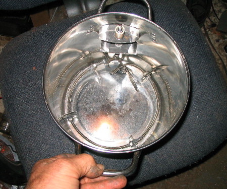

Well I happy to report the new cell is working well I don't have much data .But it's been fun to run out of gas .I made mistakes with the cookware . I went shopping with a magnet and the three piece stock pot set at Walmart  was the first choice . It's too thin to do any welding or machining
 live and learn there . I had ordered some Teflon washers as spacers . But haven't received them . So I went with Jb and it's holding up .to the heat . I won't go on with a mess of stuff I'll weight until after the next trip and and spend some time with the  amp gage and get the concentration shutdown working (ie shutdown add water). For now I leave you with a short movie file to view .lAdmin please allow I'll take it down in a day or so ) . I was banking on the all thread . Earlier attempts showed the gases developing from exposed edges and  I now think the fracture is effected at the fine edges. One piece of 24 " ¼  20 all thread  out performed the flat plates . The negative cylinder is necessary for a  vehicle. Another day of tests before I tak it apart . Move the anode connection to the side and rebuild the top as well as weld up ta new frame.
http://www.otherpower.com/images/scimages/1431/8_qt_cell_.avi
http://www.otherpower.com/images/scimages/1431/8_qt_gas_test.avi

 It's called HHO or hydrogen / brown's gas into intake for gas engines. It makes use of the on board spare power aka battery or similar PTO.
It's a well known addon for gas engines to get a much better burn in the cylinders with extra milage as well. Some have doc showing 30% increase at initial usage.
NOT normally pure H2 since it's using the cracked H2 and O to make the in-cylinder burn much more complete.
The O give the gas more oxygen for more complete burn. The hydrogen gives it a bit more fuel to burn.
NOT to be confused with the OU stuff, this has been proved and works.
JUST becareful there high enough current involved to do in someone who isn't careful.

I read you said you were going to use sodium bicarbonate(NaHCO3) and rain water.
If you use NaHCO3, it will become a basic solution in your cell. Your results will be skewed also by the CO2 and possible CO that is produced. And when thats released it will leave behind Na to react with the water creating NaOH, thus resulting in a basic solution. There's little way to get rid of the caustic solution without a PEM electrolyzer.
The Rain water I wouldn't suggest. Even though its plentiful(in some places) its not a great source of H2O. Your cell needs to be clean in order to run efficiently. Your stainless steel will also last longer if you have clean water and the right electrolyte, because in a perfect cell(pure water, pure NaOH, Best Stainless steel) everything works the way you want it to, but once you add something else it changes the whole balance and could end in a ruined cell and wasted money.
All in all I would suggest to use distilled water, good NaOH(lab supplier quality) and good 304(or better 316) Stainless steel.
