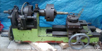

  i spent a bit of time rebuilding a old lathe i got from a friend for nothing.
  so when i finished it i started on the single rotor gen.
  this lathe was so old it might have done bits in its past for real wind mills of old.
  but it was good to get this junk i got from my mate running again.
  i found sum history about the old lathe and it never was a good quality lathe.
  but it done its best for me.
  so when i saw another old lathe on ebay going cheap. i bid and win it.
  it was only a short bed and had no tail stock.
  but i could turn just over 14" on the face plate.
  so that was great as my next gen will have a 12"steel disc.
  after a lot of work cleaning mending and painting i was able to make a smaller
 9" rotor to match the one i had.
  this new short bed lathe was great.
 it made i nice job of of turning a nice new steel disc.
  i also made a new type fitting for the twin rotor.
   a tapir lock hub.
  but now i had to modify the old rotor.to match the new one.
  boy was that a problem.
  as it had the 8 magnets on it . its lucky it was potted in resin.
  it stuck to the lathe bed the vice . the tools .
  trying to measure what i was doing was a nightmare.
   if it wasent for the cost of the magnets i would have scrapped it.
   but thinking i was lucky it only had 8 magnets and not 12 like the others .
  or it might still be stuck to the lathe.

  now to explain the pics.
  two are the lathe pics posted on ebay
 the lathe as i got it. others how it looks now.
  a pic of my old lathe and one with old rotor complete with
 metal turnings.
