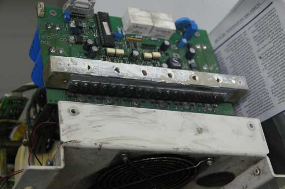

So for anybody interested, I replaced the capacitors with 64V ones and all worked well.
Clearley the magic smoke had escaped from two capacitors, I put it down to excessive heat, caused by my summer temperatures and the rigerous work out I give it in summer.
So now I have a stand by inverter, I suspect electrolitic capacitor failure may be the cause of the demise of many inverters, since it is true for most electronic equipment I see no reason for inverters to be an exception.

Today I started out to put this beast back in service to prove it, but alas no go, bugger.
Took it off the wall and back to the play pen for a better look, the MOSFET bank at the rear looked very gunky so I removed the heatsink to fully expose the control board and MOSFET's.
A prolonged spray with ecectrical cleaner and a blast with air cleaned up most of the gunk. Tried powering it up and no go, bugger again.
Its very wet today and the cleaning spray makes the components cold so moisture soon covered them. So out with the heat gun for a bit of molly codling and it jumped into life.
Re-installed it and the AC voltage was 190 not it's usual 240, grrrrr heat gun again and 240v.
So I put it in service and left the cooling fan O/S overnight to let it warm up.
In the image you can see that the cooling fan blew direct onto the control board.Now the cooling fan was set up to blow and since the relay that starts it was faulty (some time ago) I just ran it full time and as the winter moisture set in, well dust/moisture and electronics don't mix.
So I have fitted a new fan to suck this time and will build a circuit to start it when the inverter is supplying say 1 KW. One can only asume that one of the pots on the control board is voltage adjustment and it got wet or gunk washed into it.
I never said I should be let loose on electronic equipment!

It is a true sine wave inverter?
The 190V seems like a working MSW inverter voltage with a standard meter.
Just mentioned it to keep others with MSW units from thinking their unit is faulty.

Ghurd it is a true sine wave and came progressivly up to full 240 volts over about an hour once in use.
I just have to remember to switch on the fan when loading it until I build the load sensing switch.
