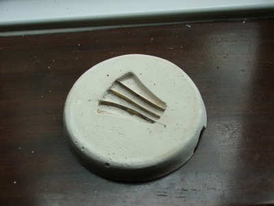

 i have only made one stator.  and its good as new.
  it dident make a lot of power but that was my fault.
  and now im going to make another .
  this one will have two rotors.  first one was a single rotor hence no power.
  already i am thinking about fitting in sum air cooling .
  why fit air cooling.  it cant do any harm and wont affect the working of the gen.
   so why not help it vent while i can at the building stage.
   ive seen sum others put vanes to move air .
  i have never had heating problems and i am only considering it might help.
    i do understand thay can get hot . sum things are meant to run hot.
   this time i will fallow the advise given in the wire dia and amount of turns.
   i have a problem with myself. in the fact that if 70 turns of wire
   is called for . then i think if i put a extra ten turns it will be better.
   so  i don't know enough.
   but will all the reading i do on here i am getting a bit wiser .
   and now i have a much better understanding of cut in speed.
   prop speed and stall.
    like a car engine under a heavy load it will get hot.
    its making power.
   but a wind gen can run cold without no problems. air cooled.
   a proper wound set of coils and correct magnets set at the very best layout
  is the answer .
 so if it aint broke why fix it.
   again that is just how i am with things.  tinker-tinker-tinker.
   sure i want power from a up and running mill.
   and all the time i am tinkering with it. it doing nothing.
   i just enjoy trying to do wee bits that can help out. and for free.

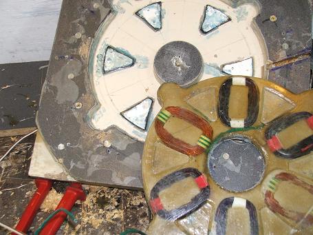

    so i put sum pics on to show how i was thinking about stator cooling..
    but now im not so sure i need do this.
   why dont i just put holes in the stator.  it will save resin.
    well i don't see many holes on other stators being made on this site.
   most look like a very flat surface.
  why dont the masters put holes and such things.
   if thay  do no good then that i can understand.   but what benefit is there
   not to put a air cooling helper in at the build time.
  the type machine i am building will furl.
   so on to the pics.

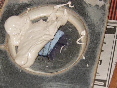

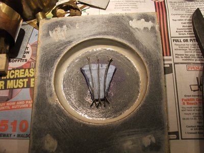

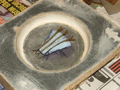

  this was a trial with plaster of paris.   i was going to incorporate this
 in the stator.
  with vanes in the rotor to help move air.
  i don't live whare it will freeze or fill with snow .
    the small fins are brass.  a lot of extra work. yes.
   will it help. maybe . sure cant do no harm.
  i can make sure i put extra glass mat in with the resin.

Re: stator cooling
« Reply #2 on: June 07, 2008, 12:31:46 AM »
You would do far better using all the winding space instead of 1/3 of it rather than playing about with holes and wind.
I am sure there can be improvements in cooling especially for those who feel that they don't have to pot the magnets for weather protection, the magnets probably fan as well as your vanes and the critical thing is to get the air flow in the right place.
Rather than tinker you could do us all a service by doing some scientific evaluation of the effects of these holes. There has been lots of speculation about this but no facts that can be validated.
There is far more evidence to show that using a larger copper section to use all the winding space is effective. It's difficult to remove heat, best not generate too much of it.
« Last Edit: June 07, 2008, 12:31:46 AM by Flux »

 hi flux and thanks for the comments.
  now i have had time to digest what you said.
  as i am only learning slowly  then i went bye the book when it came
 to potting the rotor.
  only adding small vanes.
  but from what you said about about air from the magnets . if not potted
 sounds a good idea.
   so now i understand i can make a compromise and only half pot the mags.
   still cover them with glass matt.
    so i will just half fill the rotor mould this time.
  no lid  and just stipple the matting with a brush.
   it wont be a perfect finish but will move plenty of air.
   but i will make sure the brush has a stainless steel metal band.
  if need be i can do a bit of sanding to get a better look.
   i suppose in a way this is a short cut.
   but now i understand a lot more .this will save resin and provide a good airflow.
   magnets will still be covered as well.
   and saves all that messing i was trying to do with the vanes.
   as you have said in the past its knowing where you can take short cuts.
 as this is small 9" rotors i am using here i cant drill holes near the center
  as is done on the larger gens of the rotor to help with air flow.
   as far as filling the winding space with copper
   then i still need to ask for advise on that.
 but i understand now what you mean  .get as much copper as will allow with the same amount of turns. just make the dia thicker.
