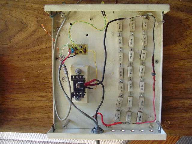

I was in a hurry to get my system working, and used some resistors I had on-hand to make this Dump Controller. The resistors are from an old audio amplifier. This system could dump almost 6 amps. It was perfect at the time but it's not really beefy enough to handle much more power than I am making now. Ghurd hooked me up with some real resistors and another Controller so I could make the GhurdSuperController.

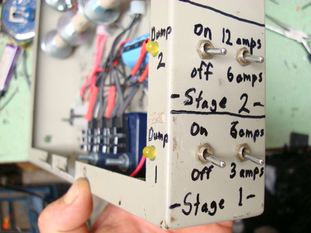

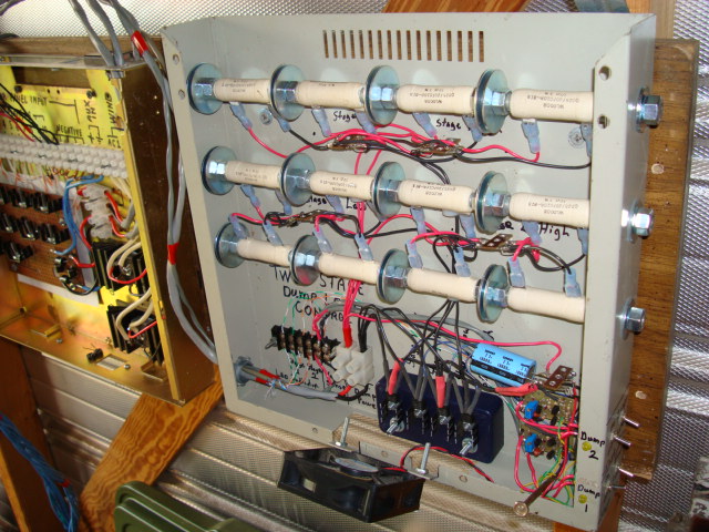

This is my new 2 stage Dump controller already installed. It has 2 seporate Ghurd Controller Modules in it. The first stage can be set to start dumping at 14.5 volts, while the second stage can be set higher to start dumping at 14.7 volts. This makes it easier on the battery as large dump loads are not used until there is a large amount of power to dump. The resistors are hanging on 3/8inch threaded rod with little heatsinks made from big fender washers. The threaded rod is bolted tightly to the chassis which makes an it into an even bigger heatsink. The top row of resistors is Stage 1 and the 2nd and 3rd rows are Stage 2. The 12volt fan only operates when any of the 2 stages are dumping. The fan gets it's power through 2 isolation diodes that charge the Big Blue 10000mfd capacitor on the lower right.
I also made each dump stage adjustable with switches. Stage 1 can be set to dump at 3 or 6 amps, while stage 2 is settable to 6 or 12 amps dump. At this time I have everything set to minimum since I only have 3amps coming in right now, but I can really grow into some more Solar Panels and other RE inputs easily. I included On/Off switches on each stage too. This will let me operate the unit on either stage independently or turn them both off for Battery Equalization. The dump indicator LEDs are here also, plus there are LED outputs on the terminal strips for some dump indicators inside where I'm using the power at.

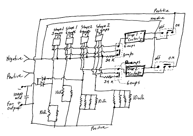

Here is "DanCADD" schematic diagram. It's hard to read but it's all correct. Except there are reverse Freewheeling diodes on each resistor bank to cancel out the possible Back voltage the coils in the resistors might create when being switched off.

This Dump controller was built inside the metal cover for a thin-form UPS unit that had been toasted. You may notice in the second picture above that this controller is mounted next to my Diode Isolated Combiner unit built in the golden metal. That was the Inner Chassis of the same UPS unit.

Very nice Woof. I don't quite follow the fan operation. Is this just run intermittently off the charged cap some how when ever both loads are on ? Great job and well worth the effort I'm sure.  Dave B.

Sure ,  I'll explain the Fan operation a little better . . .
If any one of the 2 stages pulses a dump voltage to the resistors, it also pulses the capacitor through an isolation diode, which charges up the 10000mfd capacitor and can keep the fan running for about 5 or 8 seconds. The the diode isolates the capacitor from the resistors preventing the capacitor from discharging back through the resistors. The ghurd dump controller can be set for a wide histersis range and I have mine set for .01 volt. Set that way the controller can pulse dumps quite rapidly. It is rare to see it pulsing dumps more than 1 second apart. I usually see the dump pulses running faster than 10 times a second, but it can easy be so fast that the dump light appears to stay on continuously.
There has been some discussion about how bad it is to charge a capacitor Hard like this in the first few dump pulses that may be more than 5 seconds apart, but I have never heard of any actual problems doing this, plus this is a fairly high quality cap.

It wouldn't hurt to put a few ohm resitor in the charge part of that cap.  A greater concern than damaging the cap is damaging a FET.  A really good large value cap would look like a dead short and stress a FET that was operating close to its limit.  I have used this method with higher frequency PWM dump and it is an easy way to turn on the fan as resistors start to get toasty.  In faster PWM circuits, use a fast recovery diode otherwise it will be conducting in both directions.

The picture I added is from the Construction, most of the stuff isn't hooked up on there.
