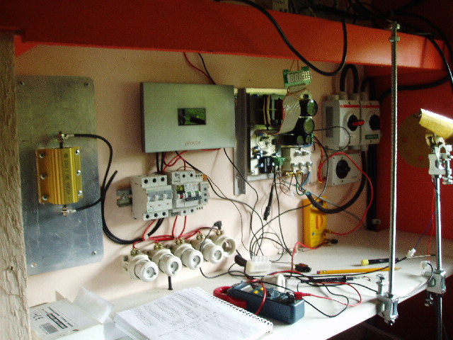

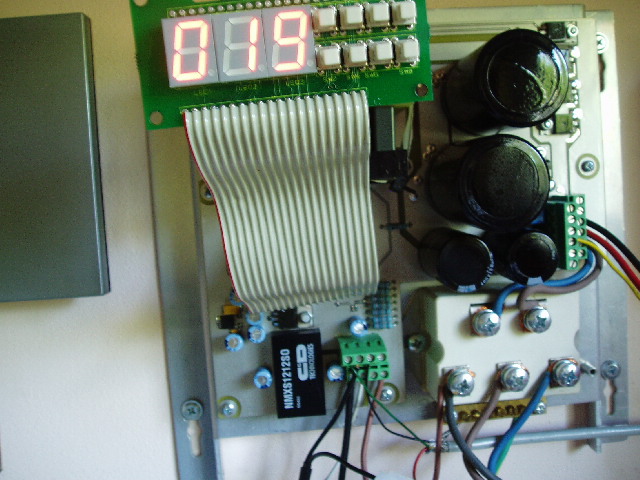

Controlling a windmill with voltage step down counter.
Here are some pictures of our "mppt" control unit.
It is pic controlled control unit measures wind speed and adjust voltage down
To alloy the generator run faster.
Generator voltage is higher, more current in battery bank and no overheating problems.
I can program in witch rpm:s generator takes versus anemometer in different wind speeds and propel gives always the maximum Power.

Hi Wellery,
Looks like your tackling the problem head on.
How did you achieve the stepdown (buck converter... what does it look like), and how did you arrive at the control signals for the buck converter.
Excellent project to work on, I would be interested in your best guess figures too....
