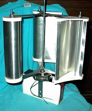

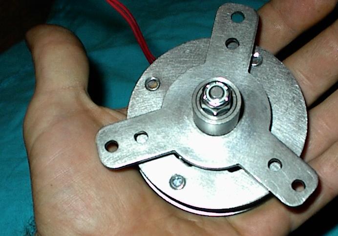

Small, mini, tiny the "Smid-gen" is just that.. measuring 3 inches in diameter and 3/4" thick it uses 8 tiny magnets to focus flux through a single coil forming an axial flux single phase alternator.
No, it's not a real work horse but it definately makes micro power a "breeze"...
It makes enough power to drive a dozen Bright white LED in a 10 mph wind with the little 8" tall by 12" diameter Lenz2.   With a set of 14" blades on it it does 14 volts at .12 amps.
Another fun project with a little "no box" thinking...

Great stuff Ed, as always.
Have you any more images and details on the alternator?, it looks reasonably straight forward.
I, along with others I suspect want to make one.

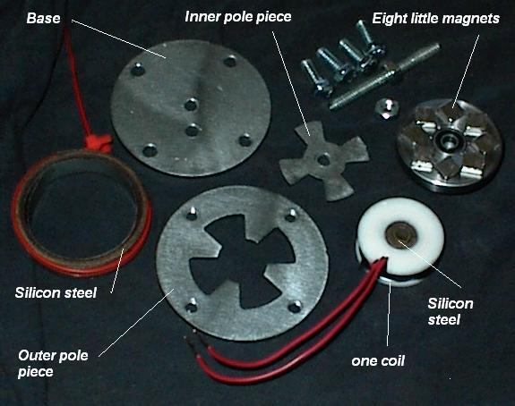

Re: Smid-gen mini mite
« Reply #5 on: September 01, 2008, 08:16:57 AM »
Here is a layout of all the parts...
It's basically an axial version of the claw pole design.   I built several of them each with improvements to increase performance and reduce cogging.   The final version shown has only a tiny feel of the cogging and requires little force to overcome it.
The steel used makes a big difference in it's performance as well as the cogging effect as well.  I originally machined steel rings for the coil and outer flux return and found you could shape them to create different outputs and reduce cogging.   The final version uses silicon for the inner coil core and return ring and a low carbon steel for the pole pieces and base plate.  The coil is completely enclosed in steel.
The magnets are 3/8 x 3/8 x 1/8 blocks that are mounted to the prop hub assembly ( or base of the Lenz2 arm ) which both have their own bearing assembly.
The "smid-gen" and "Lenz2 spinner" will be offered as kits on my site in the near future.
« Last Edit: September 01, 2008, 08:16:57 AM by windstuffnow »

Nice design Ed,
A bit more to it than I expected, I had to google 'silicone steel', I now understand its importance within the design.
http://www.key-to-steel.com/Articles/Art101.htm
An 'exploded  or sectional view' may also help others understand the concept, not sure how that could be done easily though..
