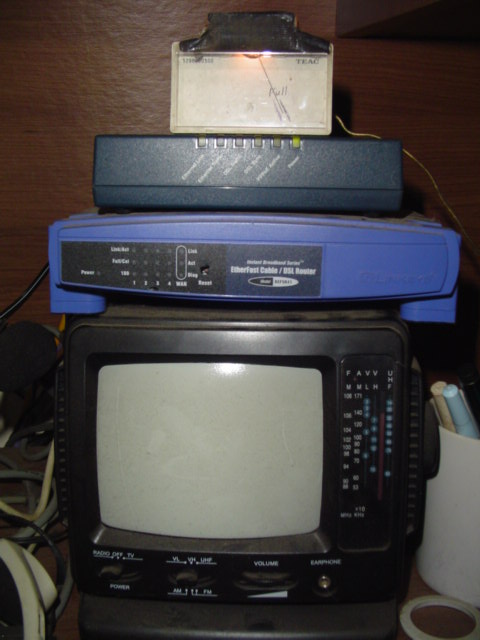

OK here is how I did my remote meter . . .
The meter I used is a VU meter removed from an old cassette deck. While it was connected to my 12 volt battery, I tried different Hi-Ohm resistors on it until the meter movement went 3/4 of the way to 'pegged out', ended up using a 68,000 ohm resistor.
I have a 110 foot run of cat 5 cable going from my battery to the room that I use the power in, 2 conductors are connected to the battery through a 250ma fuse to the meter.
I am only concerned about 2 voltages: 14.7vdc full charge, and 12.4vdc where the battery starts to sulfate to much. So I measure the voltage directly from the battery terminals and when I see the voltage reading 14.7 I run into the house and put a mark on the meter representing that voltage. Then that night as the battery is being drained I keep making measurements till I see a reading of 12.4 on the terminals, then run into the house and put another mark on the meter representing that voltage. This gives me perfectly accurate readings on the remote meter. As long as the meter needle is between those 2 marks, then I am happy.
This cassette deck meter also has a backlight which I can turn on with a pushbutton switch. I have a 120 ohm resistor in series with the backlight and it glows nicely when I push the button. I use 2 more conductors of the Cat 5 wire for LED indication of Stage one of my dump controller, plus 2 more conductors for Stage 2 dump indication. There is a spare pair of conductors in the wire.
Way Low Tech and works wonderfully !
