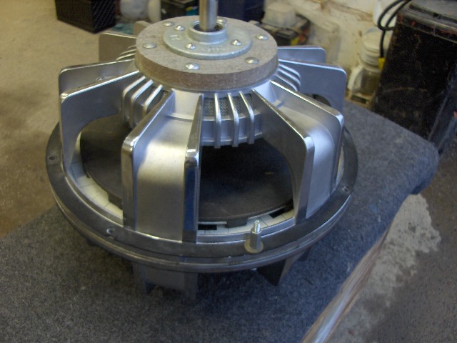

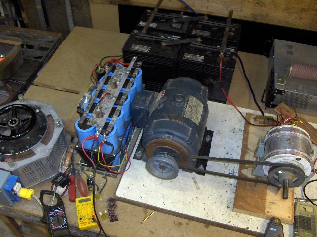

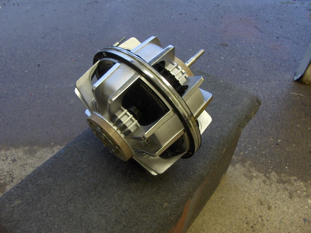

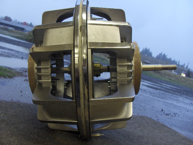

I set up a test bench in the shop today. This was to make a compairison of Hughs 4 ft PMA and the Garbogen. Both 12 volt machines.
Hughs is wired as per his instructions (star).
Test equiptment.
Fluke trure RMS meter measures PMA DC output.
Analog 10 amp meter measures PMA output.
HF cheap meter measures prime drive drive voltage.
HF clampon AC amp meter measures prime driver drive amperage.
Inferred digital tachometer.
5 KW 120 volt varyac, supplies 0 to 130 VAC.
DC power supply, using 2 each 50 amp X 400 volt fullwave bridge rectifiersand 10 each 6,600 UF/450 volt elactrolyc caps for 66,000 UF of power filtering and storage.
Load 4 each 6 volt golf cart batteries at 220 AH = 440 AH at 12 volts.
20 fuse at the battery for saftey. This test is limited to 10 amps.

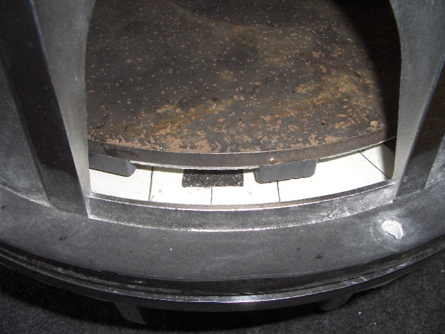

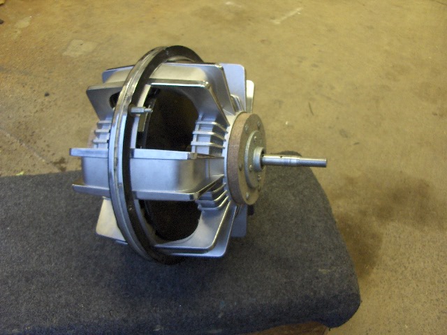

Here are a couple pictures of the 2 PMAs.
I wrote down a lot of #s today. I think however I'll just show the RPM diferances and power requiered to make amperage at specific RPMs.

Re: 2 PMAs tested today.
« Reply #2 on: November 14, 2008, 11:52:42 PM »
Jerry,
I can find no comfort in your measured figures. It makes no sense to me that an iron filled alt would out perform the axial flux in the efficiency stakes.
I somehow suspect this may reflect the impedance match between your driving motor and your participants requirements rather than the true power in / power out comparisons.
Then again, I could be wrong??.... However, I think it would be more useful to use the variac etc, and ignore the input figures completely (don't even measure them), and instead incorporate a pony brake/or what ever to measure the input torque on each unit.
Putting this another way, I think the power torque/curve of the drive motor is causing the results to be of little value. We need actual input power to the alts..... rather than calculated input power figures (real torque measurements, not reflections of the drive motor/variac/torque/rpm imperfections), then we can sensibly consider matching the alt to a prop.
Forgive me if I have misread the test, just the way I see it from here.

« Reply #3 on: November 15, 2008, 02:52:37 AM »
I agree that the only true way to measure power is the dynamometer method using torque and speed.
Using the drive motor input power is not going to give particularly accurate results but should serve as a reasonable comparison.
I would like to see the dc input requirements for the drive motor, terminal volts and armature current. I am not happy about using the rectifier input ac current.
With the dc figures to the drive motor I would also like to see a no load run on the motor with no load on the alternator.
The power into the axial machine at .5A  will be little different from 12W so we have 70W going lost in the drive system and it becomes tricky when the drive motor losses are far higher than the thing you are trying to measure.
There is another way to get at this and it may be possible for Jerry to do this and keep the convenience of the belt drive without having to dynamometer mount the drive motor or test alternators.
A simple prony brake on the motor shaft ( blocks of wood clamped round) or a rope brake over the pulley with a pair of spring balances would measure motor torque.
We need motor armature current dc amps and torque at each of the test speeds.
We then have a calibration of armature current against torque and for each load we get power from the armature current and speed using the current/torque graph. Motor loss is eliminated ( we have to live with the belt problems but it may be small).

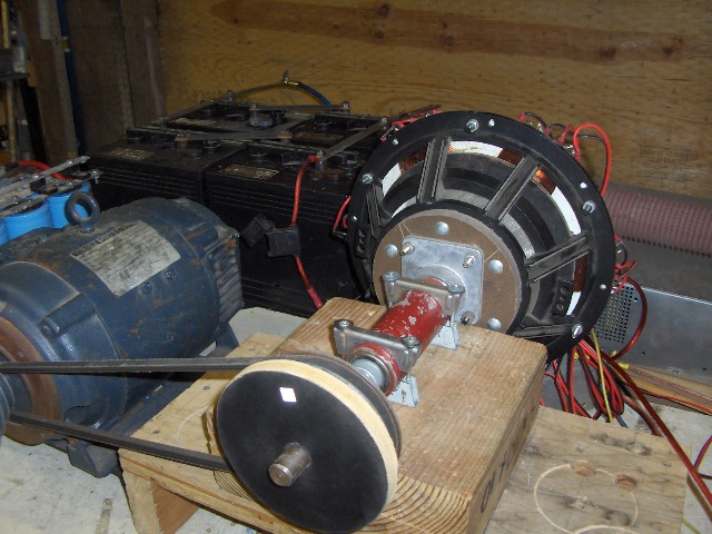

« Reply #4 on: November 15, 2008, 09:10:33 AM »
Thanks for the input guys.
I can measure armature amperasge on the drive motor. Or even replace that motor with a PM 2.5 HP tred mill motor.
Not quite understanding why if the drive motor requiers more power why thats not reflected in the load its under? It must also have something to do with the rpm at at specific load also?
The best test will the wind tunel.
Flux I do have the no load #s for both machines. This will include open volts.

« Reply #7 on: November 15, 2008, 03:52:06 PM »
Jerry,
Looking at the side casing of the motor I think you have field coils as well as the armature to consider. (the two bolts on the side at 90 degree angles would appear to hold field winding poles)
Consider this. If we have X ohms as the nett resistance of the armature and the field, the watts lost will be an Isq R function.... so losses in this part will be a square function... not linear. I think you can see the problems starting about now.
So as we load the same motor differently for the same power (different rpm and torque for the same power output), we will have different quotients of voltage x different amps to get the same power out. But the one with the higher amps at a lower voltage (likely the one with same power at lower rpms) will suffer much higher power losses in the copper circuit, and brush losses as a squared difference in the current.
This is before we start to look at the effects of higher magnetising currents due to the higher amps... and thats before we start to see what happens with the iron at higher currents. In the worst case, we could saturate the cores, and pour in more power for no appreciable power output increase.
I had just this problem recently, where I was driving a 10hp induction motor into the grid with a 4kw dc motor (just trying to run the batteries down a bit). The DC motor was rated with 4kw@2880 rpm, the induction motor was 4 pole 50hz..... 1500rpm. As I loaded up the induction motor to get more power into the grid, the current went up dramatically on the dc motor as it really needed a pulley (near 2:1) to get decent efficiency out of it. It was trying to pull it's 4kw at half the rated rpm..... things get unreasonably hot fairly fast.... obviously poor efficiency as we pushed the power up.....was fine at 1kw though, barley warmed up at all, at 4kw you could cook your toast on it. So efficiency was not linear to say the least.
At least that's how I think it works :)
It will be only by measuring with a spring and rpm, will you get believable figures which can't be debated.

Yes you are right, to use a wound field motor you need to supply the field from a separate rectifier at constant volts. The power measurements must be armature voltage and current.
I didn't look closely at the motor but got suspicious when Jerry said he could change it for a treadmill motor ( why change one pm motor for another).
Running shunt motors with armature and field in parallel is not good over any real speed range and for power out measurements you must not include the field losses.
