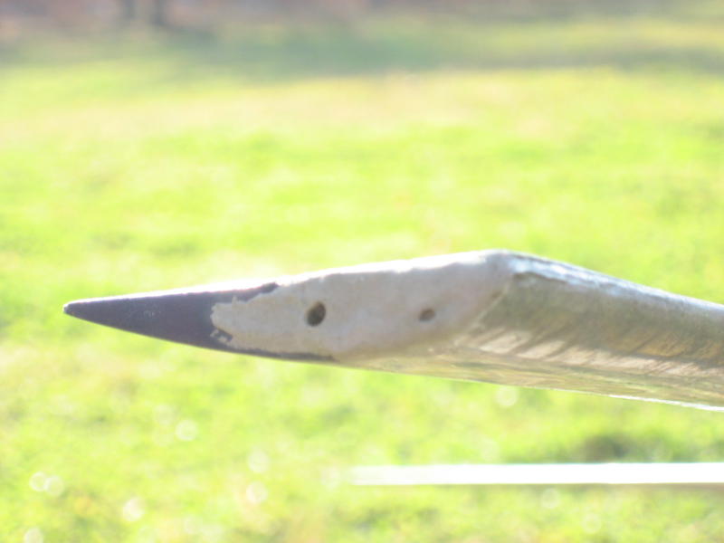

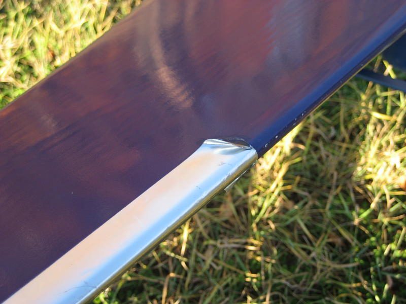

The stainless steal tape on the leading edge of the blades works well protecting the blades   The tape ends began to peel up slightly at the corners.   Before lowering the turbine, I could hear a low whistling sound, most likely caused by the tape pealing at the corners.

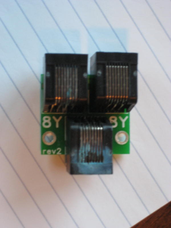

The split connection used on the weather station communication cable became corroded.  It was replaced. The signal from the weather vane and anemometer was restored.  This time the connections were sealed with dielectric silicon.  Special thanks to APRS for sending a replace next day air.

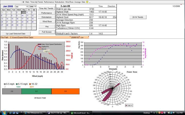

Hi, what software are using to track the performance of your mill?
« Last Edit: November 24, 2008, 08:53:04 PM by KilroyOdin »
Boondocker
  • Posts: 193
Re: 1yr Check-up
« Reply #6 on: November 25, 2008, 05:53:55 AM »
The software is spreadsheet Excel. Did a little programing using macros and visual basic to update the data.
http://www.fieldlines.com/story/2007/11/22/155224/64
http://www.fieldlines.com/story/2007/11/18/18820/361

 Just an idea! With the tape peeling back, would it work better to run the tape all the way to the hub? Air speed would be lower at that point and it may not start to peel. Nice to know that everything is holding up.
windy

It may.  For now trimmed the corners of the tape. Made them have a larger radius.

Many types of tapes stay "stuck" better if you can avoid sharp corners such as 90deg.
It may be better if you cut a generous radius at the ends, makes it less likely to "peel back".
An old trick learned many years ago.
ax7
