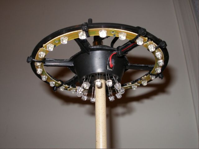

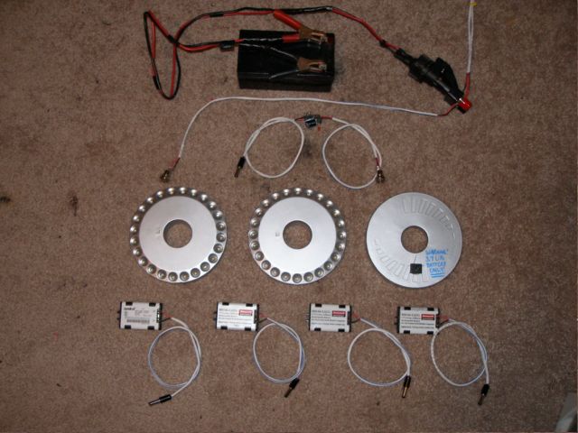

Ok, here they are. Zap is right, I've been neglecting my duties as an experimenter, and not posting the pictures. So without further adieu:
From top to bottom, left to right:
The 12V 5AH SLA is primary storage
The battery 'interface' (aftermarket 12V power port set, mainly for it's terminal posts and fuseholder)
Main power tap (size M coax, everything is!)
xV->4.2V buck converter for charging the LiPos. Usually I do this from the SLA, but it works just fine directly from the panel as well. Charge Time? 4 hours per LiPo if they are exhausted (3.2 OTV).
The 3 'UFO' 24 LED wally-world specials with the one on the right flipped over to show the power connection. Runtime? 8+ hours without dipping into the dreaded 'danger zone'.
The 4 LiPo 2100mAH batteries for secondary storage.
This is the solar panel. 33 cell kickin' out a whole 8 watts (OTV x Isc method):

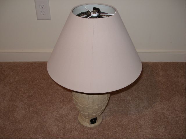

And my latest pride and joy, a 36 LED table lamp that is 1/3 home depot, 2/3 wally-world, 100% modified, and definitely sweet!

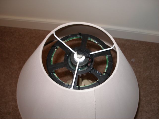

A peek down into the top of it, showing the lampshade mount mod with the coax power connector as the 'hub', and that almost spark-plug feel the mate has going into it. It also now 'floats', meaning that if you hit the shade, it doesn't cause the lamp to tip over - my biggest gripe about the original design, by far!
With the shade removed, a look up from below reveals the array of LEDs:

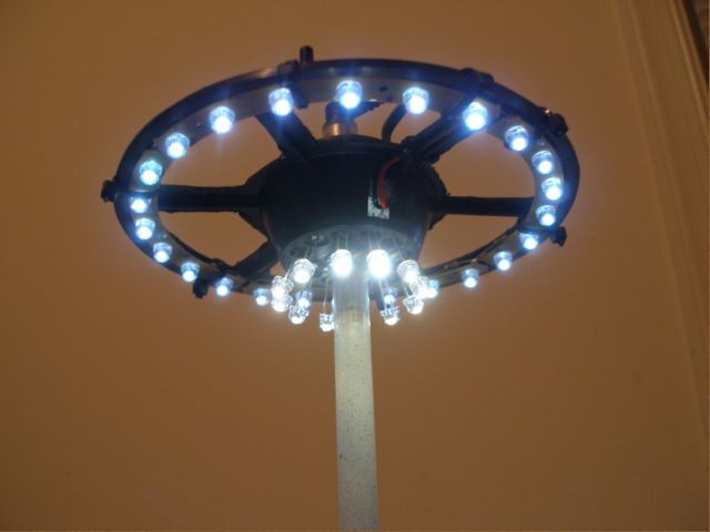

And last but not least, with the lamp powered on in 'mood' mode. Here you can see the difference in color between the 24 'cold' white and 12 'warm' white LEDs. The camera didn't do that great a job of capturing the warmth, as I had to turn on the overhead light and kill the flash, but the chill that the wife complained about sure shows up in that outer ring! This combo is an excellent balance between light output and color. The wife is happy now, and will actually use it!
The lamp has 3 modes:
Night Light mode draws just 1mA and is just enough to keep the 'pitch' out of black in a radius of better than 15 feet.
Mood mode draws 50mA and is perfect for just say, laying in bed chatting with the wife.
High power mode draws 750mA and is more than enough to read with, but sucks hard on the battery (another 2100mAH LiPo). I can get a couple solid hours out of it before I begin to get paranoid with voltage levels and want to drop it down a notch.
The battery is not yet changeable with the others; I tried to keep the aesthetic mods down as much as possible. Charging is done through a miniature (Nokia-like) coax connector that plugs in by the switch), but function is going to definitely outweigh form i believe on this one - I think I'm gonna drill out a hole in the backside of it and put another 'size M' coax back there so that the batteries can be changed out!
I'm also seeing if the original panel that sat atop this thing can still be considered effective enough for daily use, so we'll wait for the coax mod until I get this data back.
And there you have it. Sola-Minima at all of well less than $100!

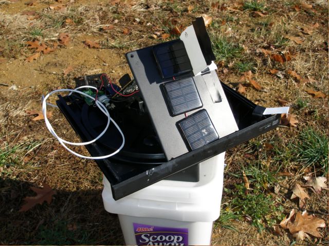

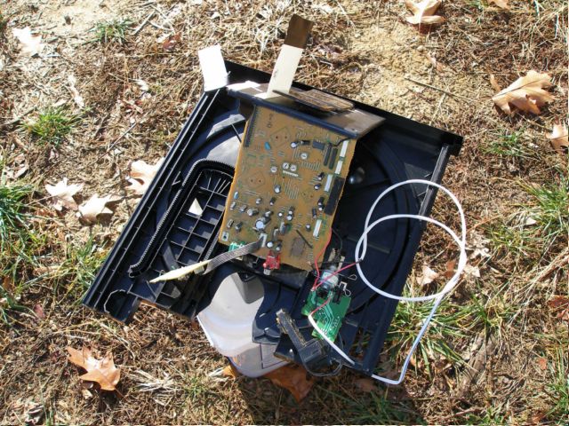

Very interesting, and definitely provoked some thought - enough to start playing with it.
I gutted that old CD player and got the tray mechanism out (had a nice little dance with a black widow in the process heheh), lubed it up, and doing some basic testing for proof of concept. It's the first day I've been able to really put it out there and let it do it's thing. That east coast storm sucked all the juice out of the experimentation for a few days. :(
I like the idea of powering the tracker directly from solar. Hadn't really thought about it that way, but it's much more efficient for tracking the smaller panels for sure, although I'm sure for larger panels it wouldn't be practical (or should I say economical). The beauty of this method tho is not wasting any main battery power to track the panel, and no standby losses. Definitely factors for a panel as small as mine! :)
I havent taken any pics yet, but the basics of it are the carousel tray (5 disc flat) turned upside down (so that the motor moves with the panels to avoid as much parasitic torque as possible due to wiring) and a set of 3 panels from those 'plop-em-in-the-yard' lights, just like in the video.
They are arranged vertically in relation to one another for the moment, with a piece of cardboard taped up on the side of one of them, perpendicular to the panel. The cardboard casts a shadow on the one panel, reducing current flow enough that the motor stops spinning until the sun's position is such as to defeat the cardboard, and make the whole thing move over a bit.
It's arranged in such a way that if cloud cover keeps it from moving, it will fire up and go until it finds the shadow again, assuming it hasn't been cloudy for several hours. This of course could put the sun at too much of an angle to break startup friction. I'm not worried about it, if it's cloudy for that long during the day, I call it a 'solar loss' anyway.
It handles what I have sitting on top of it weight-wise for the moment, but I wonder about it's abilities to turn when I go to mount the main panel on it. We will see.
I haven't gotten very far in thinking about the return system yet, but one of those cheapy mechanical alarm clocks with the switch for the alarm and a AA battery mixed in with a limit switch comes to mind. I'd have to set it to like 8 o'clock for it to work properly, since there's no differentiation between AM and PM. Maybe a dollar tree digital version would have just enough to do it... ?
Whatcha think? I'll get a pic of it up soon to give you a better idea.

Yup, weight (and subsequently friction) are the enemies here. Torque is definitely one of the more difficult things to come by with the small amounts of power we're using.
My test run today ran reasonably well, until the angle of the sun got low enough that I had to 'help' it along a little bit by giving it a nudge to get past the startup friction. This of course is unacceptable, so I'm looking into another possibility for gearing and the like.
Fortunately, as you said, speed is wasted here. I don't care if the motor has to go 10,000 revolutions just to move the panels a quarter inch. If it is capable of going faster than the earth is spinning, we're good.
I think you're on to something there with the bike wheel - Might not be a bad idea to drive the wheel using a fairly small hand crafted pulley off of the cd changer? Making a belt out of innertube rubber and going around the rim, etc. The bike wheel would be stronger too, and won't crap out from fatigue or parasitic friction as easily, since it has ball bearings.

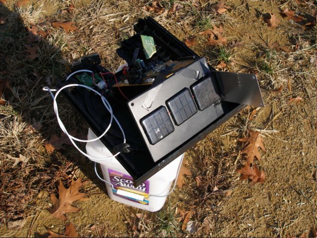

Pics of my first attempts at the tracker
« Reply #17 on: December 13, 2008, 04:42:54 PM »
Ok here it is... My first attempt at a tracker.
Most of the details have been discussed in the above posts, this is primarily to give everyone an idea of what it looks like. Thanks Zap for establishing the link between easy, cheap, and self-powered. Right now, it's not doing anything useful, but it makes the kids point and giggle when it moves. I'll make it actually do something of purpose in the near future.
The original concept in my mind looks something like this. Ironically, according to the wife, it's also an accurate image of what the inside of my mind looks like. <shakes head> . . . Primitive human... >X-D
Down and dirty, 10 minutes of actual building, primitive self powered solar tracker. Three 'plop-em' panels, wired in series, connected directly to the motor.
What can I say, it worked. It was rather sloppy since even the smallest breeze would send the cardboard shadow mask into a quivering frenzy, and screw with it's perception of the sun's location. Also, turns out that trying to partially block sets of cells on a panel wasn't the best way to stop it tracking. It would sit and be late for a move, then jump and go 15 or 20 degrees (as is apparent by the shadow in the picture).
The tracking plane is (audio folks don't cringe too much hahaha) - A Pioneer 5 Disc tray type CD changer tray, turned upside down so the wires and motor would move with the panels. Ripped it out of a working player. Yep thats right. A working player. It had minor front panel damage and the top cover didn't fit right. It had been sitting in storage for 2 years, and under a bed for a few before that. Time to reincarnate it, MadScientist style. Besides, who listens to CDs anymore?! :)
A back side view with a better look at the motor. Ignore the board behind the solar plane - it does nothing other than prop the panels up at a decent angle:
So, this morning, I made some quick mods. Swapped out the cardboard for aluminum, turned the panels 90 degrees so that the mask would hit only one cell of the 'sensing' panel, and bypassed the blocking diode previously in place for battery charging:
Ahh, thats better. Got it out there early enough to let it run a full sky's range of light, about 100 degrees or so of tracking. Now works much more the way I originally had in my mind. It does something of the order of 2 or 3 degrees per jump, evident by the shadow that is now visible in this picture.
It passed the 'cloud' test too (even though there was never a cloud in the sky all day). There is a good size tree across the street from my house that the light has to pass through from about 10AM until 11 or so. It didn't move at all during this time, then all of a sudden... zzzzt! Pointing right back at the sun in one quick turn.
Tomorrow, I may get froggy and try to work out exactly how the main panel should be mounted on this thing.
Until next time . . .
Steve
« Last Edit: December 13, 2008, 04:42:54 PM by Madscientist267 »

« Reply #18 on: December 14, 2008, 08:06:01 AM »
Good job Steve... now you'll need to do a time lapse video :)
I'm not sure I understand the panel setup.
Only 3 panels powering it?  Does the aluminum "shadow mask" keep enough power from the motor to keep is from spinning till it's time to align with the sun?
I found a geared motor that might work on mine... a worm gear affair out of a printer or scanner.  It will be awhile before I can test mine outside.  2.5°F right now, snowing and blowing at a good clip.
« Last Edit: December 14, 2008, 08:06:01 AM by zap »
Madscientist267
  • Posts: 1181
Re: My first step in the right direction...
« Reply #19 on: December 14, 2008, 09:57:08 AM »
Yeah I thought about the time lapse thing while I was watching it do it's thing yesterday. That's gonna be a little bit more difficult with what I have laying around. I have some cameras laying around that might be able to come up with something if I toy with some software...
As for panels, yep just the 3, wired in series. In full light (right now in winter) they're good for something like a total of about 6V OTV and ~100mA Isc, slightly more current in summer. It's just enough power to get the motor going.
The key is that in order for a series panel to produce power, all of the cells must be exposed to light. If even one cell gets blocked (or even just a good part of one cell), the entire array is rendered more or less useless. Think of it like the whole 'weakest link in the chain' thing. The total current through the entire array is only as high as what can flow through the weakest cell.
I am exploiting this by having the shadow mask cast the shadow on only the last cell. There's only a couple of degrees of difference between full and no (ok, unusable) power, so I get good resolution out of it.
The worm gear seems to be the ideal way to go for this, as it helps lock the turntable where the panels put it. And, it provides a torque boost in exchange for speed, which isn't needed anyway. I could easily gear this one down some more and still outrun the sun.
Also, you're probably going to find that your real-world results are much different from what you're seeing with the 100 watt bulb. Mine won't even think about moving with a 100 watt bulb right up on top of the cells, but moves along rather well in full sun. I hear ya with the snowstorms out there - I've lived in Aurora, Golden, and Missouri Lakes (just northwest of Blackhawk) - many years ago, but the memories still live on! ;)
Let me know how it goes.
Steve
« Last Edit: December 14, 2008, 09:57:08 AM by Madscientist267 »

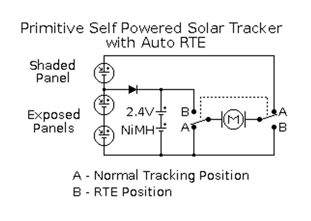

I'm taking a slightly different approach, to keep as much silicon out of the driver as possible. I've drawn up a schematic. Its primitive, yes, and has 2 (pretty major) caveats, but is a start. It's still only on paper, and likely won't be built as it sits in pencil, but gave me a better visualization to work from.
I'll get the diagram posted as soon as I get a chance, but the basics are as follows:
Two of the panels are exposed 'all of the time', so I tapped them with a diode to get juice to charge 2 AA NiMH cells, and then put a DPDT toggle in that would be tripped by stops at either end of the run.
In tracking mode, the switch connects the motor to all 3 panels, as they are now.
In RTE mode, it reverses the polarity, and connects the one leg of the motor to the batteries instead of the panels, returning the carousel to the start point, with no help from the panels.
The switch then gets flipped back by the east stop, and the process repeats.
The 2 caveats that I see at the moment are:
  1. - If there is cloud cover before the switch can trigger at the end of the day, the carousel will remain where it is until at least the following day. Result, lost input.
  2. - Even in ideal conditions, upon reaching the west stop, the RTE triggers immediately, causing the panel to go home while there is still usable sunlight left in the west. Again, lost input. Not as much per day as an RTE failure, but should be considered cumulative, so still significant over time.
Not perfect, but its keeping with the theme here of ultra-simple, and self powered. I'm sure at some point I'm going to have to concede to a transistor or two. Sensing darkness sounds the easiest, but like you said, a dark enough day, and it may get confused. I suppose worst case there would be one 'missed' day of solar. We'll see how the paper evolves, and then I'll go from there.
Steve
« Last Edit: December 16, 2008, 08:20:26 PM by Madscientist267 »

Schematic - Primitive Solar Tracker w/ RTE
« Reply #29 on: December 16, 2008, 11:17:51 PM »
Here's the schematic -
« Last Edit: December 16, 2008, 11:17:51 PM by Madscientist267 »
zap
  • Posts: 1107
  • There's an app for that
« Reply #30 on: December 17, 2008, 09:25:50 AM »
Steve that certainly is simple.  The schematic helped me sort out how the DPDT was going to work.  How did you draw it?
I didn't get the RTE portion of mine hooked up yet, hopefully today or tonight.
« Last Edit: December 17, 2008, 09:25:50 AM by zap »

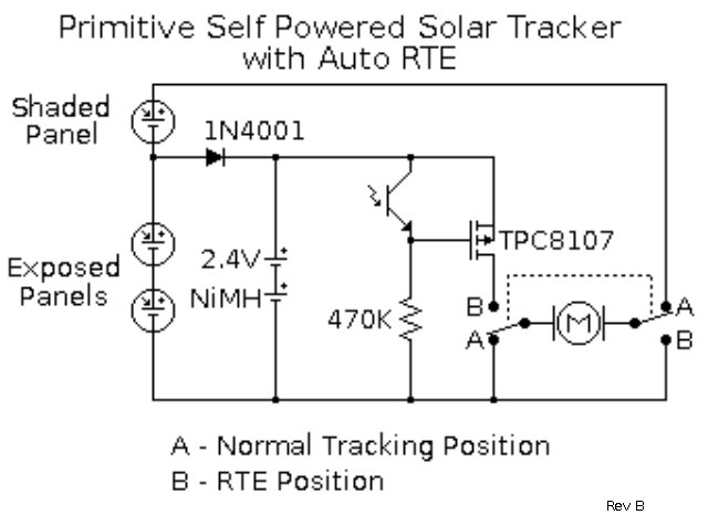

Madscientist267
  • Posts: 1181
« Reply #32 on: December 17, 2008, 04:34:25 PM »
Nice dude... I've been looking for a decent all-in-one (w/ SPICE modeling) for a while now, just haven't found anything that really does what I want it to. As for the ones I've been posting, they are done the hard way. I found myself in the car with the wife a few weeks ago with a laptop that had nothing on it to manipulate anything with except GIMP and after I made up some templates, it's not that bad actually. Kinda stuck with me. :)
Anyhow, here's the latest and greatest. I figured out how to nuke caveat 2 (immediate RTE) with minimal parts. Took some hunting to find a suitable MOSFET that would do it at these voltages. Everyday (IRF510 etc) wont cut it; can't quite trigger the gate at 2.4V.
Turns out there was a gold mine of low voltage MOSFETs right under my nose - LiPo battery controllers use them as interrupt switches. Perfect! It took some delicate soldering to use an SMT package with pigtails, but I've done it. Probably just going to pot it in epoxy.
The RTE portion of this is bench tested, and works beautifully, although I am considering experimenting with the 470K a bit (maybe a 220K?). The higher the value, the darker it needs to get before it triggers. It has a fairly sharp response, although I haven't measured what parasitic draw is up to the point that motor stall is overcome. Shouldn't be a big deal; the NiMH are 2000mAH.
Also, I have no idea what the exact specs are on the phototransistor, it was part of a sensor for the original carousel (it's like it was made to do this!)... In virtual darkness, there's about 750K of resistance, <1K under a 60W light bulb. I'm patiently waiting for actual sun; it has been overcast here for 3 days straight now! :(
Anyway, here it is:
« Last Edit: December 17, 2008, 04:34:25 PM by Madscientist267 »
