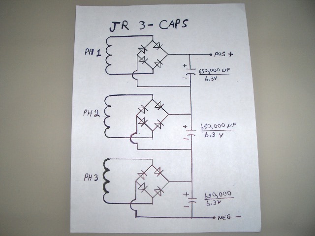

Fisrt is the Hornet GM alt with there single NEO ring magnet replacing the original rotor coil. The first test is with all 3 phases seperated, a fullwave bridge rectifier for each phase, a 160,000 uf cap on each bridge dc termanals, then these 3 seperate dc outputs wire in sires.
Next is the same setup but NO caps.

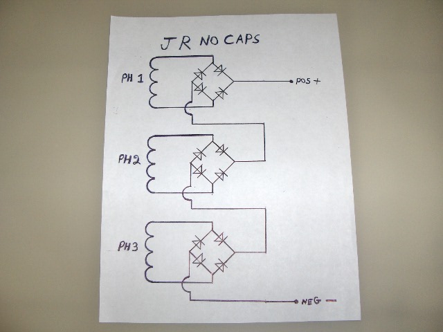

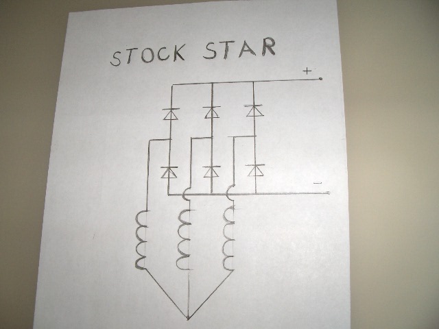

Next is the GM alt stock with the original GM 3 phase diode/bridge. I'll use JR for "Jerry Rigged"
 GM ALT JR+3 CAPs     GM ALT JR no CAPs        GM ALT Stock star/Hornet
 1 amp 556 rpm        1 amp 742 rpm             1 amp 1124 rpm
 2 amp 594 rpm        2 amp 774 rpm             2 amp 1153 rpm
 5 amp 693 rpm        5 amp 873 rpm             5 amp 1227 rpm
7.5 amp 785 rpm      7.5 amp 925 rpm           7.5 amp 1284 rpm

These alts are 3 phase. In the star mode a phase is making 10 volts and its in sires with the next phase the voltage is not 20 its 17v.

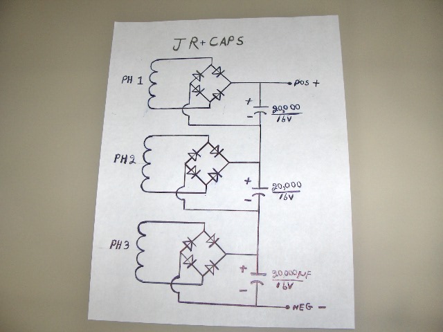

My scheam treats each phase as a seperate power supply. Coil to bridge to cap.
This makes a nice stable power supply. Now when I sires these 3 power supplies the volage is much higher and or the rpm requierment is greatly reduced.
On a typical ac power supply, when a power transformer is supplying 10 volt ac at the AC terminals on a fullwave bridge rectifier and there is a cap conected to the DC termanals of the fullwave bridge rectifier the DC voltage on the measures around 14 v.
3 X 14v = 42  is a better result then 2 X 10v = 17 volts.

Here are the schimatics of the GM alt mods I,ve made.
This is the stock GM alt 3 phase. It is the worst prefomer in this test.
Here is the "Jerry Rigged" version without the caps it did better then star by far but not as good as the caps version.

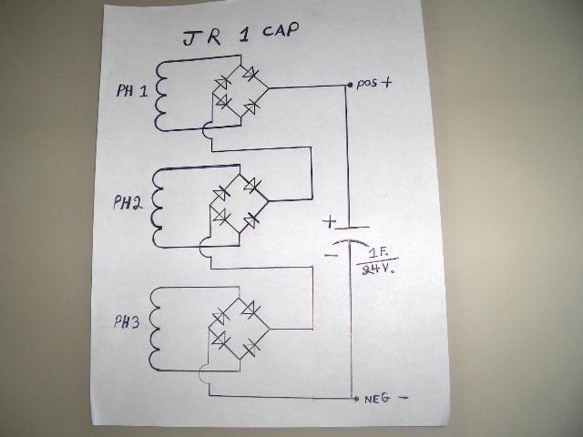

Here is the version with one single 1 farrad cap accross the 2 outside terminals. It did not work any better then the no cap version.
Here is the best preforming mod. a cap on each bridge DC output. 3 DC power supplies wired in sires. I did this with some 20,000 UF- 16 volt caps and some 630,000 UF- 6.3 volt caps. The preformance was the same.

If you get a chance, perhaps you could put a few hundred uf directly across the coils before the rectifier as a separate addition to  the series caps across the jerry rig (last photo.
With the F&P units, they found this lowers the rpm. Too much and it kills it. too little and it does not work too well. Their pole count is very high..... but it might be worth a try as you have the setup in place to test his out... it may help?
