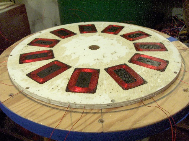

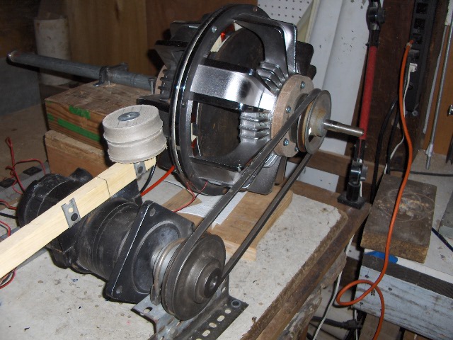

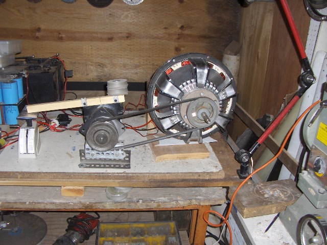

We'll i got the 14-11 ceramic assembled enough for some bench testing.
Even though it 27% outside and the grid is down right now (love that backup power).
Here are the #s so far.
               Hughs 4ft                        14-11 ceramic
 PMA,s amps
   1 amp        327 rpm                           299 rpm
   2 amps       350 rpm                           326 rpm
   5 amps       426 rpm                           394 rpm
   7.5 amps     493 rpm                           430 rpm
   10 amps      582 rpm                           516 rpm
I actuly ran the 14-11 up to 23 amps for 10 minuts. The heat in the stator was well within reason, not bad at all.
 I only did a torque measurment on both at 5 amps. Hughs torque was 1 LB 13.5 oz and 194.98 prime driver watts.
Since the 14-11 ceramic is a slightly more powerfull PMA it took slightly more torque but less prime driver watts.
 14-11 torque 1 LB 15 oz. but only 144.75 prime driver watts. Lower RPM?
Even though there is iron in the center of the coils it spins by hand real easy and keeps spining with some flywheel charicteristic.
At higher rpm you can hear a bit of a mone from the stator. Just like a real stator under load?LOL
Here are a few pictures.

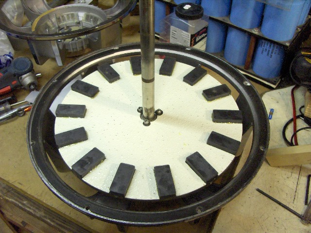

This is 1 magnet rotor disc in the speaker basket prier to assembly.
At this point I'm very happy with this PMA. $15 worth of magnets rather then $90 and a littel better preformance.
I'll do the more complete compairison after the wind tunnel test. That may be a month or 2 away however?

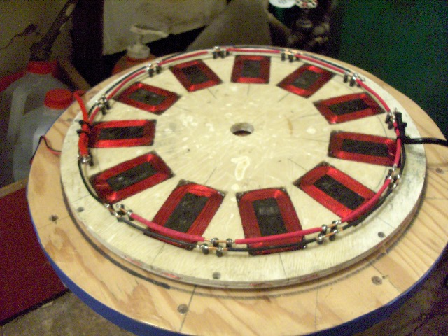

I was thinking that the ceramic magnets would need all the help they could get with there weak flux.
That was the insperation for the powdered iron in the coil centers. After making the test stator with the iron and finding it didn't present much of a cooging isue I desided to press on with the PMA.
Checking the resistance of each coil at 6 Ohms gives aproximent ESR of the hole PMA of .55 Ohms.
I made a quike check of the Hugh 4ft PMA this morning and found that each coil is about .5 Ohm.  In the star configuration this would equal an ESR of about 2 Ohms.
Strange to think that the 14-11 with the 4400 turns of 24 ga. would have a much lower ristance than the much large wire ga. 85 turns per coil of the 6 coil star unit.
Thanks for all the coments folks. Now back to the lab.

Many people seem to like the PMAs I make with the speaker baskets.
I would like to make a sugjestion.
My wife and I own and operate a retail car stereo store. I've been doing this since the 70s.
I sugjest that many of you could aproach your local car stereo shops and ask if they might have any old no value cast basket subs that have no other value then a door stop.
A woofer thats out of warranty and is only in there way and gathering dust. A dead unit customers just left behind when a new unit was installed in there enclosure.
Show them a picture or 2 of mine and explain how you can help make the earth a much better place by turning it into wind generator as aposed to just ending up in the landfill.
Maybe have the manager call you if something comes in or stop in once a week. Belive me most shops get a few door stops every mounth.
Maybe offer the installer $5 if the basket meets your needs. You can use just 1 but 2 is a littel stronger.
They don't have to match. just the size needs to be the same not the brand or style.
There are sutle size diferances so hold basket to basket to see if they match.
They a very nice base from witch to biuld a pma.
I'd like to see other people using them to. The magnet end caps make nice blade  supports or small magnet discs. Or shaft adaptors for larger discs. I've taken some 11" discs off some large heavy subs.
The magnets are fun also. Cut the magnets into pye sections for your own 14-11 ceramic with a wet tile saw?
Lots of free fun.
