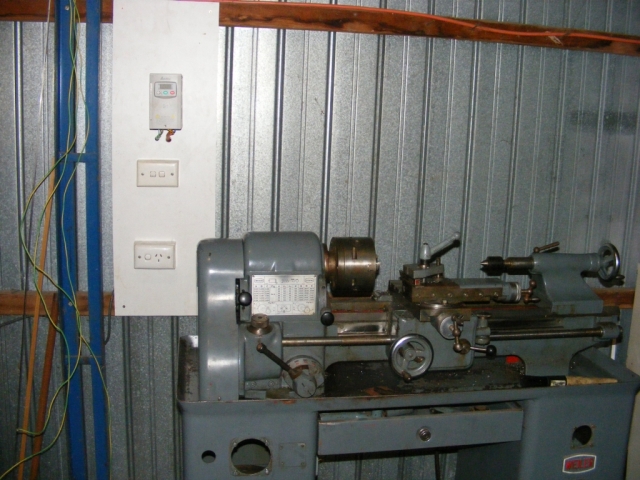

        Well xmas is always special here as it's the day we officially moved on to the farm and today marks 5 years. We've gone from a pultry solar array that was on the house when we bought the place to a 3kw/hour pv array which has been rock solid now for over 4-1/2 years.
         My shed is also fully powered by RE and i'm nearly there getting a full blown RE machineshop going. Today I converted my toolroom lathe to 3 phase/vfd drive and my bridgeport mill also has a VFD. The next vfd project is my 4' centre lathe then the surface grinder.

           A VFD is a Variable Frequency Device that is a small box where you put 240 volt single phase in and it pwm's 3 phase out. With being able to vary the frequency you can have a full range of speeds keeping the full torque rating of the 3 phase motor. Also you have the option of forward/reverse, ramp down to stop or sudden brake and a RS485 Modbus output to a computer.
           As we sell them at work I get them real cheap and I now have 3 of them, in the end my goal is to have every machine in my workshop hooked up to one. So what this means being off the grid doesn't stop one having a full blown machineshop.
 Below is a pic of my current project, converting my toolroom lathe to VFD drive. Yesterday I did a trial cut and under load it only drew 800 watts. :)
