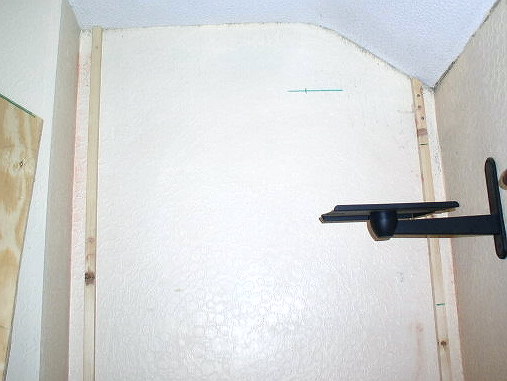

A section of north facing wall just under 4 feet wide.  To the left is a chimney flue (chimney breasts in the uk) and to the right is the corner made by the eastwards wall.  The black thing is a tv stand.  Either side of the alcove you can see wooden battons screwed to the wall. I left a space because it's easier to fix them that way, and later I used the channel for wiring to the TV.

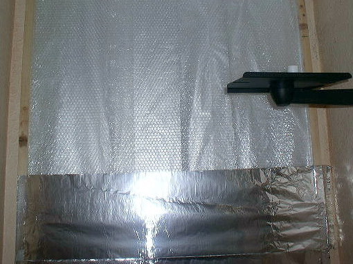

Here I've added the insulation.  A layer of aluminium foil stuck to the wall with glue stick, three layers of bubble wrap (bubbles all to the wall), and then you can see that I'm working up from below applying a second foil layer cross ways (which has caught the flash!).  This last layer is stuck directly to the battons with glue stick.

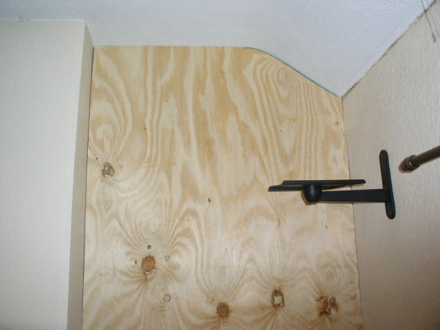

Lastly the 12mm ply is cut to fit and nailed to the battons.  I then finished this by sealing with emulsion paint, covered with a texture wallpaper and finally pianted tp match the room.
You asked for cost for the 8 x 8 wall.....
The 2 sheets of board were £15 each
battons 6 to 8 at a £1 each
Foil 50p a roll, perhaps 2 rolls  :-)
Bubble wrap about 1/2 a roll which I once bought for the greenhouse but never used (£13 a roll years ago).
I make that around £45, then I had to decorate on top of the wood, but the wall was ready for that anyway.
