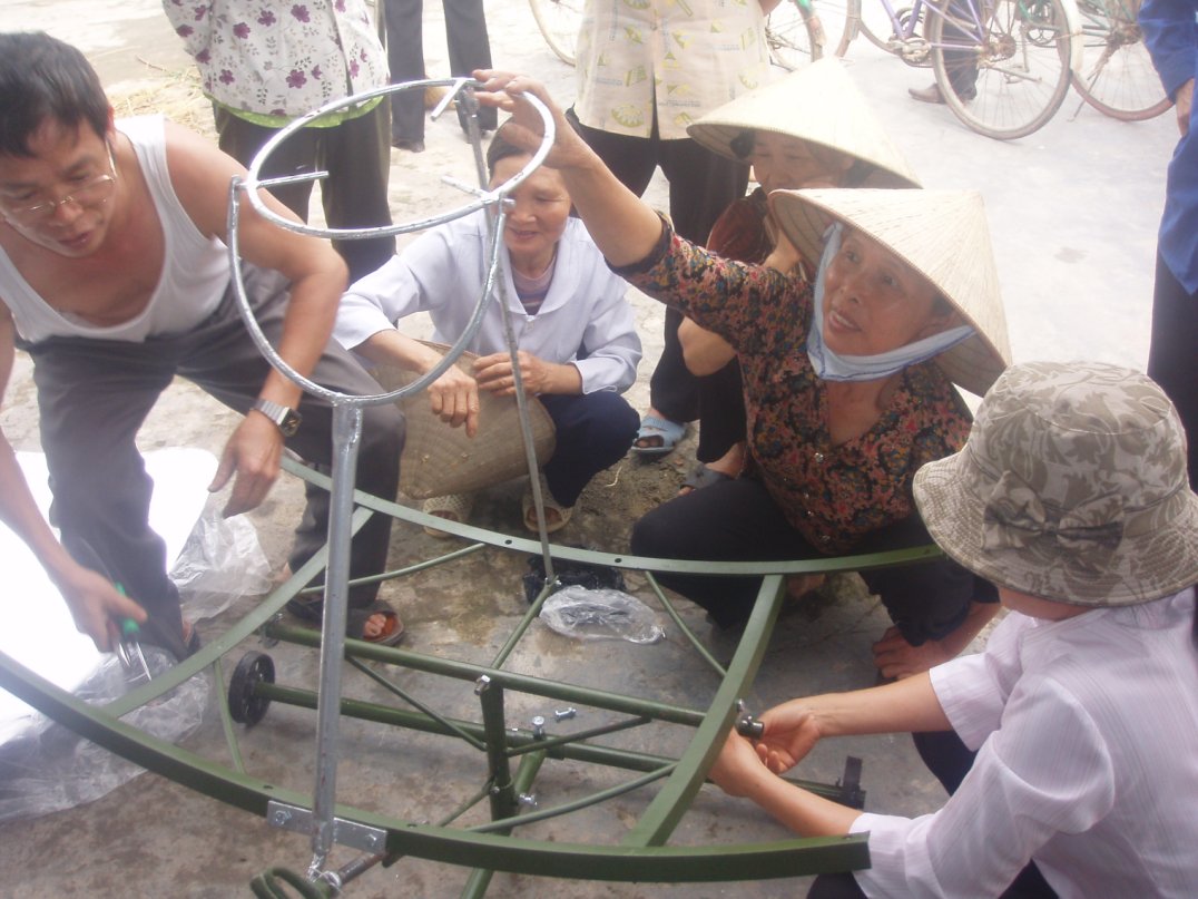

With the support of a Finnish NGO we started there a solar cooking energy project. In the above picture I'm putting together a solar cooking machine with a local lady, one of the users of the technology. The machine is made by my good friend in India, the leader of the company called 'Tinytech Plants'.

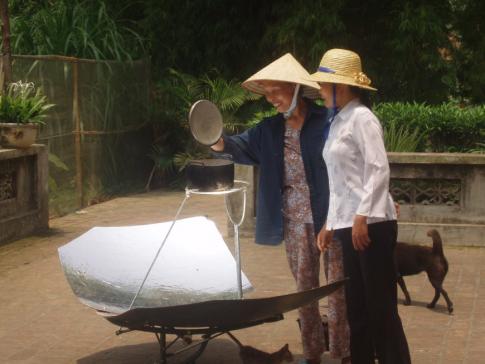

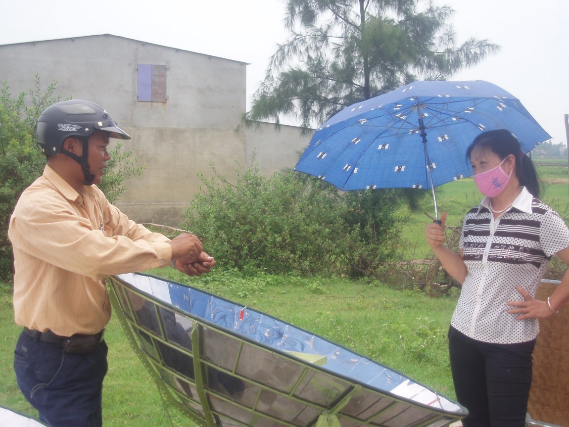

We bought five pieces of these cookers from India and twenty pieces of Chinese made solar cookers. In the third picture my friends in the village are checking the cooking process of a Chinese made solar cooker as produced by a company called 'Yancheng Sangli Solar Energy Co. Ltd'
http://www.chinasangli.com/website/html/tyz.htm
Here in the next picture one of the ladies is taking her cooker home.
Cooking.
There are more than 600 000 Solar Cookers like this in use in the north part of China and in Tibet.
If the sunshine conditions are good the machine can cook with roughly same speeds as electric cooking plates.

One thing you really need with solar cooking that no body in the pics has on is sunglasses (really dark )
« Last Edit: February 17, 2009, 02:01:12 AM by tecker »

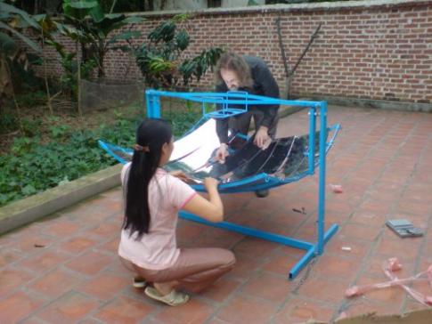

We visited them and tried to learn about their project. Here a picture of their cooker.
The Chinese Cooker is done accurately. If adjusted correctly all the sun rays are reflected under your cooking pot. You don't need any sun glasses, if you don't need it otherwise in the bright sun. This is one of the main reasons I'm recommending to make the mirror base accurately by cement casting.

In the above picture you can see the frame and the focusing construction of the Chinese solar cooker.
My first assistant TU with her Friend boiling water with the Indian cooker.
