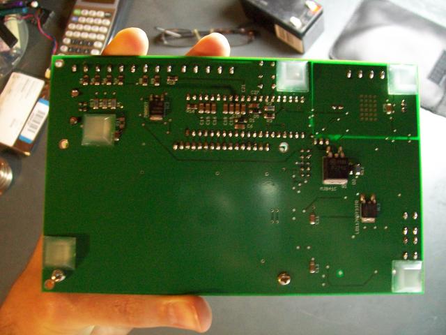

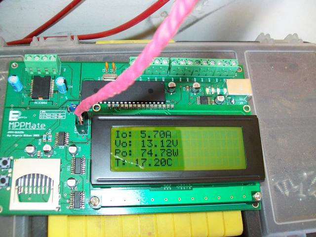

Ok, as I said before I materialized my data logger board that mates with my MPPT controller via the SPI port.
It logs data to an SD Card and the data can be extracted by reading the SD card in a computer or by connecting the data logger to a PC using the USB port.
So far it is logging great but I still have a few rough edges to chip out. I will do so when I get more time. I need to log input voltage and current.
Here are some pics:
Front:
Back:

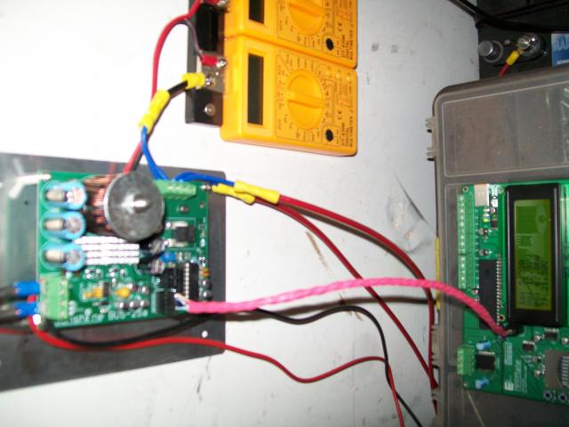

The complete setup:
Obviously this is not where everything will ultimately go. I need to get a nice box and bolt everything nice and tight to the wall. But right now that is good enough while I finish adding features to the code and complete the debugging.

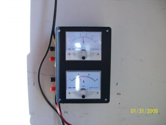

Meters measuring input current and Output Current:

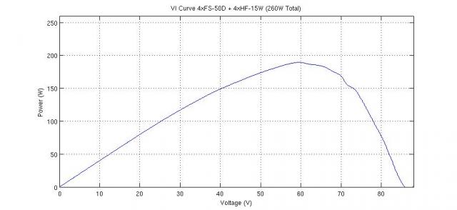

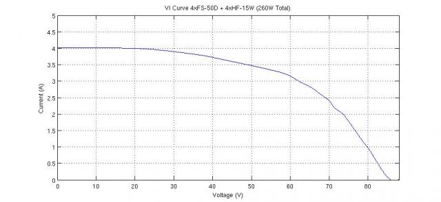

On Feb 4th I used the data logger to sweep the PWM from 0 to 99% to get the real life VI curves for my complete setup, not just manufacturer's curves that often lie. I have in my roof 4x Harbor Freight panels in series + 4 first solar 50W panels for a total of 260W. As I have commented before my panels are not angled very nicely for this season but I see improvements every day as the sun moves back up to the sky. Here are the curves I got:
Luckily I am getting a bit more power than that now.

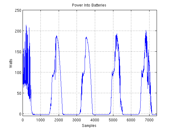

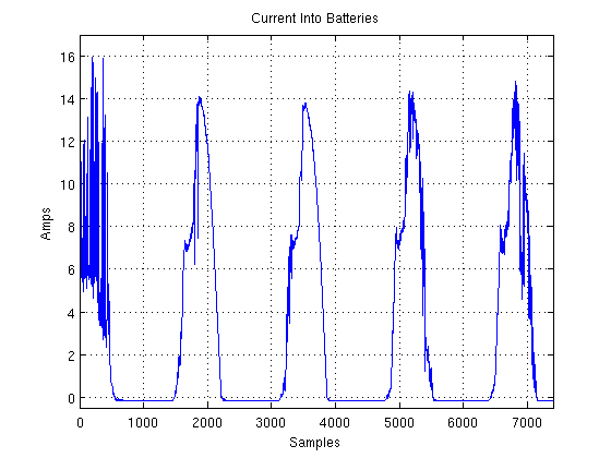

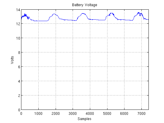

Now I show some of the data that I have grabbed starting Feb 23rd - Feb 27th (5 work days).
Battery Voltage:
Current Into Batteries:
Power Into Batteries:

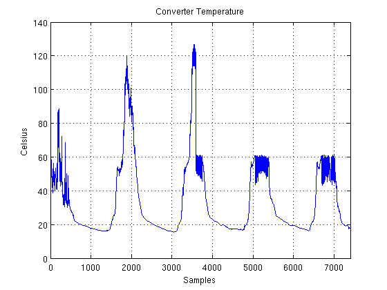

Converter Temperature:
Now the last one is a very interesting one. At the beginning of the week I left the cooling fan disconnected to see if the MPPT controller would make it. It turns out that its thermally safe without a fan running at about 16Amps on the output. Though the temperatures are a bit high for my taste so I decided to put the fan back on by the third day at about mid day. As you can see the temperatures quickly went down to 60C and remained there. There after the temps never went over 60C with the fan on. This week has been very hot, about 28C during the day.

Those 5 days I got:
  • A total of 5811Watt/Hours
  • Max Power: 213.57W
  • Avg. Power: 40.2W
  • Max Current: 15.96A
  • Avg. Current: 3.15A
  • Max Voltage: 13.55V
  • Min Voltage: 12.35V
  • Avg. Voltage: 12.76V
  • Max Temp: 126.86C
  • Min Temp: 15.45C

    Where were you taking the temperature from ?   FET Tabs ?
    Inductor wire ?  Core ?  Somewhere else ?
    Are you actually MPP tracking or finding the sweet spot by hand right now ?

    I am taking the the temperature right from the mosfet's tab. These mosfets are surface mount ones so I have a SMD thermistor right next to it. The inductor is also right next to the mosfets so if it gets too hot it also triggers the fan.
    I am doing full dynamic MPPT using P&O method and some other combined. The full MPPT description can be found here:
    http://www.fieldlines.com/story/2009/1/26/11314/0349
    I have a jumper in this board to allow me to set the PWM to whatever value I want just like an open loop buck converter. It allows me to test if the MPP algorithm is working at its fullest.
    « Last Edit: March 01, 2009, 09:26:36 AM by s4w2099 »

    Yes you are right. Even though my MPPT is 100% automatic I have noticed that the input voltage remains pretty much constant at MPP throughout the whole day. There are a few exceptions though.
    When the ambient temperature goes up the MPP voltage goes down and in a manual setup you would be loosing power if you are not there to adjust the converter. For example, in January my ambient temperatures ranged from -5C to about 20C and the array was operating at about 62V. Now my temperatures have risen and my array is operating at about 55V.
    Even when its overcast my array operates at about 62V and yieds quite a few amps into the batteries.
