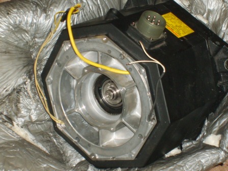

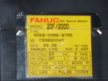

I am starting my first wind mill. I have a fanuc ac servo motor 20f/2000.
This motor should start charging about 180 to 200 rpm. I was thinking about building it as a eight foot mill. I am hopeing for sugestions as to what size mill to make from guys with more experence then me. Mabey save me few mistakes.
The motor has a brake and needs to be removed. I though I would be able to remove it from the encoder end. The encoder came off easy. it seems to be mounted to a plate that looks like it should come out but seems to be stuck. the only other way into the motor is from the frount. I have never taken apart motor like this before. I have read on the board that you can mess up the motor taking it apart to far and I do not want to do that. I wanted to post a shot of the end of the motor as far as I have it apart but it does not show on the list to insert but I uploaded it to my files. I have seen where other have taken the brake out of a servor motor and was hoping I could get a bit of advise on how to get mine out.
I will be adding more pics and things as stuff goes on. A bit of help on up loading and finding the pic so I can post them would be great. I have figured out resizing them. I uploaded first one found it fine but when I upload another I can not find it in the insert image box on right hand of screen ?

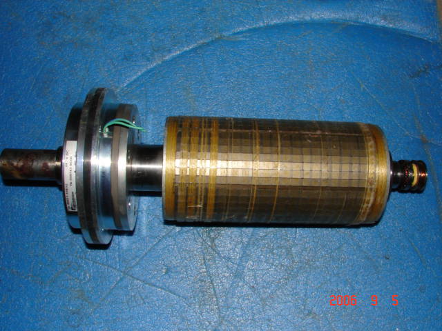

Hello!
I have NOT seen the insides of a Fanuc servo motor.
However I have had a Kollmorgan servo motor apart and "defeated" it's brake.
If I can get the image inserted here..  You will see the rotor from the Kollmorgan.  On the left side of the rotor is the brake (the drive shaft side).  It was bolted with allen screws from the outside of the end bell.   When I recovered this motor from the scrap heap someone else had already taken it apart So I'm unsure if there was a "proper order" to take it apart.   I believe that the brake assembly is "pressed" on and I do not have the equipment to remove it.  So all I did was cover the rotor with a towel and ground down the surface of the brake (what is bolted to the inside of the end bell) The wires for the brake had already been cut, so I reassembled the motor and plugged the holes in the end bell with silicone sealant.  The brake assembly in TOTAL now spins with the rotor.

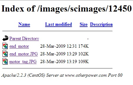

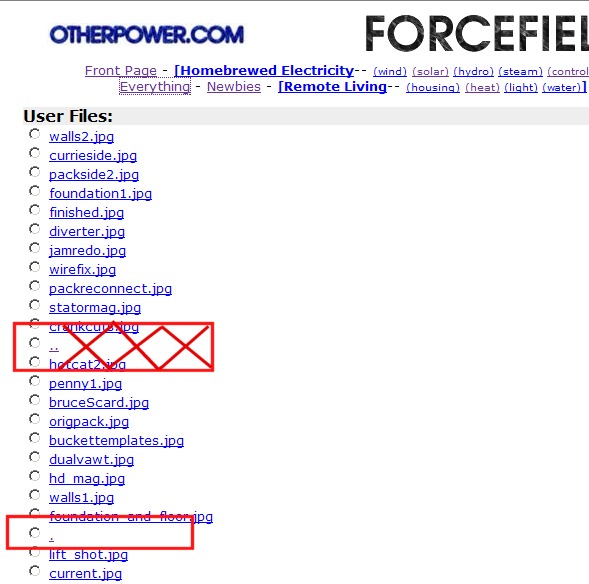

I think this is the picture you were looking for?
I think there's a bit of a bug in the software on here now when it comes to uploading and posting pictures.
If you open up "Your Photo Uploads" in another browser window or another tab, if your browser has that feature, the page should look something like this.
The page you see will be different because you don't have as many photos uploaded as I do.  When I looked at your files all that was listed was
and, "motor tag.jpg"
Once you're on this page you can click on "motor tag.jpg" and the picture you loaded will come up.  If you click on the "." it will bring you to another file tree and that should look something like this.
Don't try to find your file under the ".." since I believe this will take you to every photo upload on www.fieldlines.com from every user.
As you can see, your files are there but unfortunately you can't add a picture from that tree using the "Insert image" button.
What you can do is open whatever photo you want to insert, copy it's web address(Which should be something like "hxxp//www.otherpower.com/images/scimages/xxxxx/nothingatall.jpg")then paste that into your text with the "img tag".
If that's not clear enough let me know and I'll try and explain it better/further.

wingman1776
  • Posts: 44
Re: first wind mill
« Reply #3 on: March 28, 2009, 04:56:49 PM »
Thanks Zap that is the pic I was looking for and the way you explained the adding the photo was very clear to me and a lot of help. thanks agin

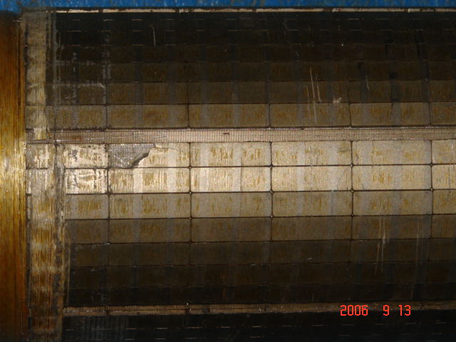

When I recovered the Kollmorgan from the trash barrel there was slight damage to it (one of the many magnets was cracked and had a small piece missing)
as you can see the fiber tape that covered the magnets had been removed.
I stopped by a local motor repair shop and inquired about replacement for the rotor covering that had been removed.  They sold me a fiber tape to wrap it with, the manager of the motor company told me that after I wrap the tape around the rotor to bake it in the oven to shrink the tape.  When I questioned the idea of heating of the magnets, he shrugged his shoulders and said that was the procedure they followed.
I DID NOT try this myself.
I would not suggest to anyone to remove this covering from their motors.

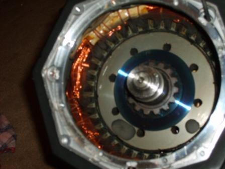

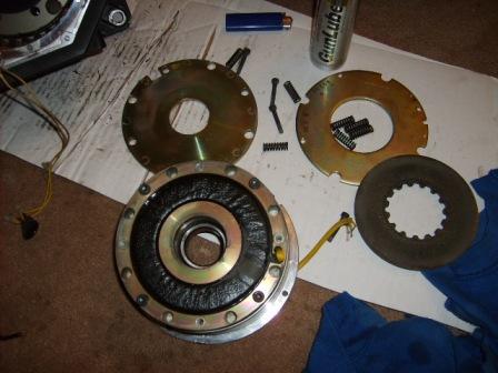

Well after all the talk I went for it and I got the brake out of the motor. I did not have to removed the magnets from the windings. Here are pics of the inside of the motor and the brake parts I took out.
Thanks guys for all you comments I got the motor put back together and will figure out way to run a couple out put tests. Will post results
