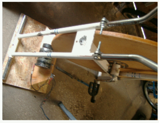

heres a shot of my little 300v ac pedgen NORM..
real simple set up--gen is  bolted to a scrap piece of plywood
bike is moved forward to mount belt--slid bike back to tighten belt
then your body weight is all that is needed to keep the belt tight..
« Last Edit: April 09, 2009, 12:20:59 PM by hiker »

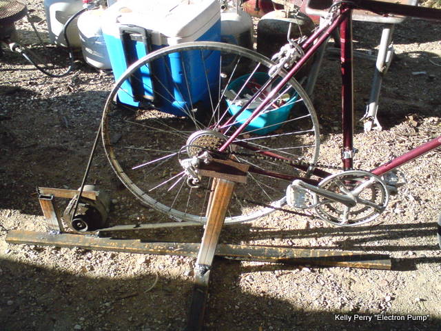

  I havent had a chance to show anyone this ped jen, I think I'll take the opportunity to do so now. She worked, but not very good. She needs a perminent magnet motor. Thats right boys... Thats a bone stock Jeep alternator. And I tell ya, It was all I could do to get it up to charg volts.
  One advantage to design... I've still got gears to get those coils all excited. Another is I can put a tire back on her and go to town for a beer.
« Last Edit: April 10, 2009, 07:59:37 PM by Electron Pump »
