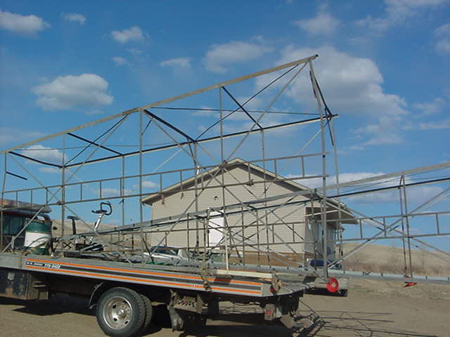

Sorry for the loss, I know what your going through! I think youre in Alta if I remember correct? Theres gotta be lots of old wind charger towers out there,I have two set up in my yard that both pivot to lay down. I have a tractor tire standing upright in case the cable breaks, to cushion the fall. And it happened! About 1/2 way down when it had the most weight on the cable the hook pulled off the front end loader! Down it came landing on the tractor tire, the tower got bent bad but the wind turbine never touched the ground!I have numerous other towers for parts, so changed some angle iron and back using that same tower. Except now I use a winch, you have way more control.
    I just bought this tower at an auction sale on Friday, Its an original Jacobs 50 foot with a huge footprint!I got the Jacobs 140 volt generator, with tail, blades everything but the control box. The gen head weighs 440 lbs!Its all original  equipment and mint condition, as it was put into storage years ago. Nobody was interested in it at all, I paid $110.00 for everything!

110$ for a whole Jacobs!?!?!  No fair!  That's rubbing salt in my wound!
They didn't happen to have a second one, did they?
Did that exer-cycle come from the same auction?  You aren't going to join the pedal-generator crowd are you?
Thanks for saying "hi".  Yes I'm in Alberta, close to that city that Sask people must be sick of hearing about.  It's still all brown here, too.
