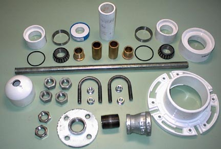

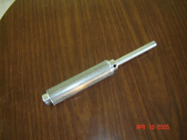

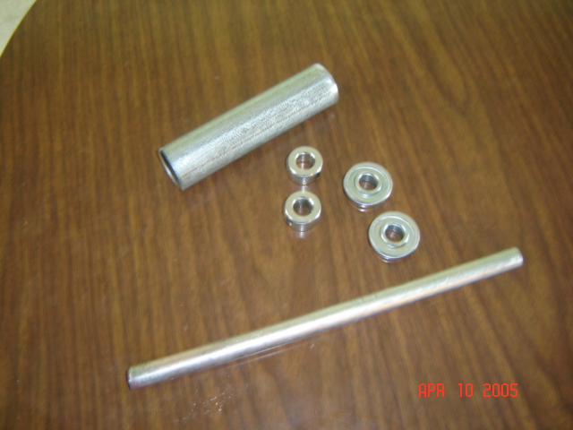

     On the way to building my second windmill I ran into builders block. I realized my current setup with small sealed ball bearings wasn't enough. I did not want to go the trailer hub route either but I did want to use the same bearings as in the 4" trailer hub. I have spent quite a bit of time over the last year staring at different bits and pieces, trying to put them together into some sort of workable unit.
     So, my goal; a setup that requires no plasma cutter, no welder, no lathe and really just needs a few hand tools to build the main assembly, less the alternator. A 6 foot and under mill that either uses stall limiting or no furling. A setup that anyone in the US could copy with a shopping list and few visits to the Ace hardware and building supply stores. Oh, and it also uses the same tapered roller bearings as the 4" trailer hub. I believe the original idea came from something in Ghurd's files so credit where it's due.
     Here's the bits.

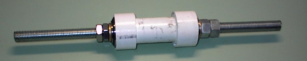

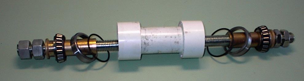

Next,
Partially assembled,

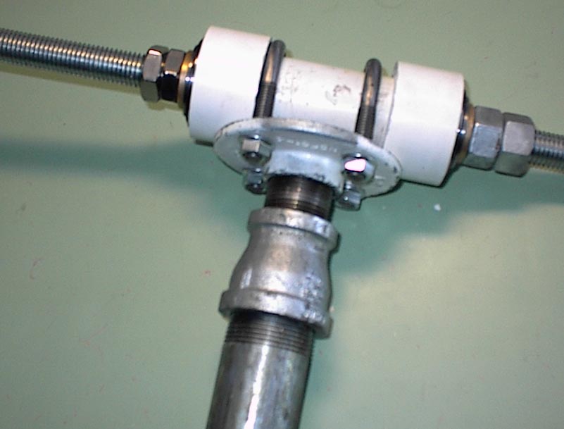

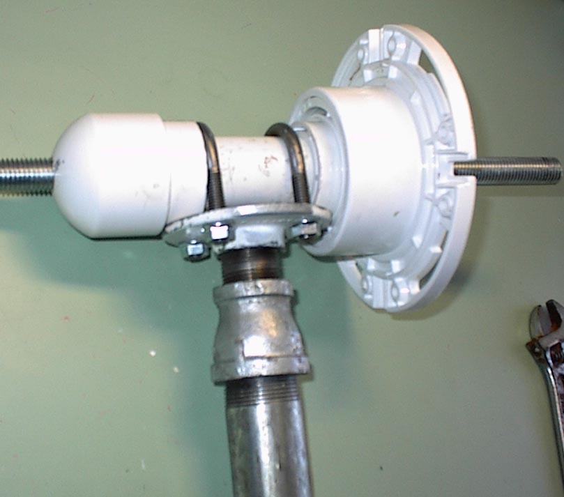

adding the down pipe,
Stator support and front bearing cover,
     The blade set will go on one end and the alt on the other. Everything is mounted on a 3/4 rod of all thread. The threads are set so that when the prop is turning the shaft the threads will push water out in a corkscrew fashion to protect the front bearing. Also the front bearing cap will have a weep hole at the bottom to drain any water that makes it's way in. The rear bearing will be protected by the stator support (not in the picture. Everything will get a few coats of Rustoleum to protect from rust and the PVC from UV.
     Why did I do it all this way? I wanted very much to build a small mill but knew I never would if I needed welder, lathe and the like. Also, I think there are many others that get discouraged from building a small mill and either quit or go the route of looking for treadmill motors and the like because it's easier, even if the results are disappointing.
     So there it is. Assembly time from the first picture to the last is about 10 minutes. Shopping time for the bits, a little longer. My six foot wood carved blades are already made and ready to be mounted and the alternator is on my bench just waiting for the stator to be poured before the final assembly. I really hope this is useful to folks with limited tools and I have no doubt it can be improved upon.

« Reply #4 on: April 26, 2009, 03:06:09 PM »
there have been allot of reported failures with threaded pipe joints the pipe tends to shear off right were the pipe screws into the fitting after a wile numerous people have reported that failure TomW for one that i can remember right off the top of my head
« Last Edit: April 26, 2009, 03:06:09 PM by kurt »

« Reply #5 on: April 26, 2009, 03:14:58 PM »
     Yes Kurt, I read that more than once. I wonder what size mills they were. I thought for a 6' mill the strain might not be so great. My first mill had a threaded connection at the top, but it was PVC! Actually lasted 6 months and took a lot of wind before it gave out.

« Reply #6 on: April 26, 2009, 03:46:18 PM »
     OK, I searched and found Tom's post on the threaded pipe failure. Also I examined that threaded nipple and the thickness of the metal at the grooves is ridiculously thin. Thanks for the heads up.
     At the bottom of Tom's post someone suggests using a schedule 80 fitting there instead of schedule 40. Tomorrow I will see if I can find a schedule 80 fitting and see if it appears suitable.
     Thanks again for the warning.

     OK,having been warned about the chance of a failure from using a schedule 40 galvanized pipe nipple, I procured a schedule 80 close nipple which is heavier than your standard galvanized pipe. For a small mill I think this should be ok now. Also, the fact that this setup has blades on one end and the alt on the other end balances the weight better and may cause less stress. This does, however, really screw up my plan that someone can get all the bits shopping locally in one afternoon. I had to special order the schedual 80 fitting. Oh well, I'll work on that part of the design.
     So I packed the bearings and assembled it for the last time. It was pretty stiff with the new grease so I added a few drops of oil and loosened things up. Then I mounted my six foot wood carved blades on it and took it out to my test pole for a little free wheeling fun.

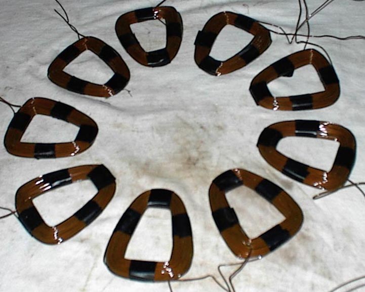

     So, now the builders block I had is gone and I can get back to finishing the alt. Coils are already wound and laying on the wife's dryer like they have been for the last 3 months. They are 65 turns of 18 AWG.

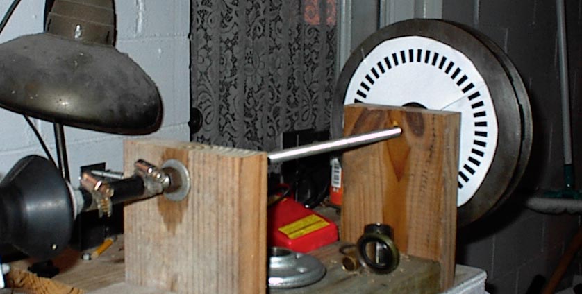

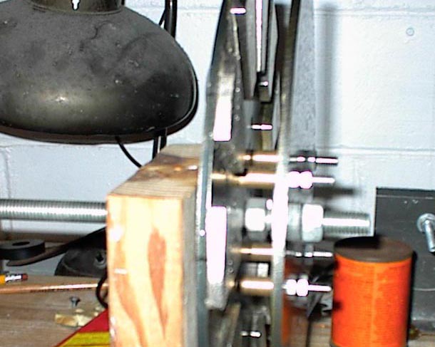

      The rotors are 10" by 1/4 steel with Ed's wedge magnets on one disc, the other disc will be blank. Here's a shot of my test gig. Notice the stroboscope stuck to the rotor. That's how I check RPM's. I use a DC motor with a PWM speed controller to set the speed. There's a program I use that will create a stoboscope for any RPM you input. At 150 RPM's I was getting about 1.65 volts ac. I estimate cut in anywhere from 170 to 200 for 12 volt.
     I used bronze spacers to set my airgap. I would never get it right trying to adjust nuts. The air gap is around 11/16". I anticipate a stator around 7/16 "

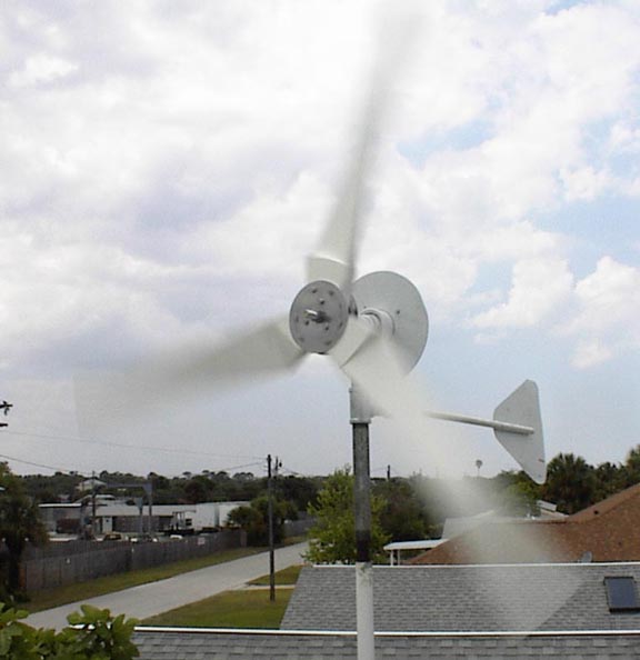

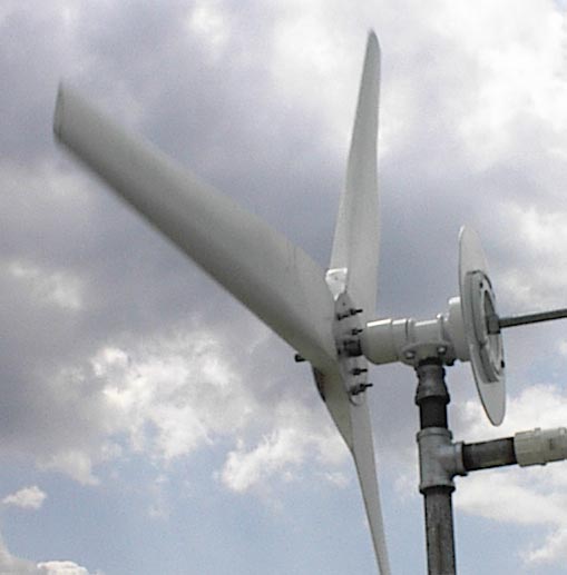

     Well, my new rectifiers arrived (thanks Ghurd) so I finished things up and it's flying. Wind was good today except that it's ESE which is dead foul for my test pole mounted beside my house. Even so it put out up to 100 watts when the wind managed to twist around the house.
     I'm very happy with it and it is running very smooth and quiet. With what I learned here I was able to guess cut in pretty accurately. Here's a shot,
     The whole project can be seen here,
