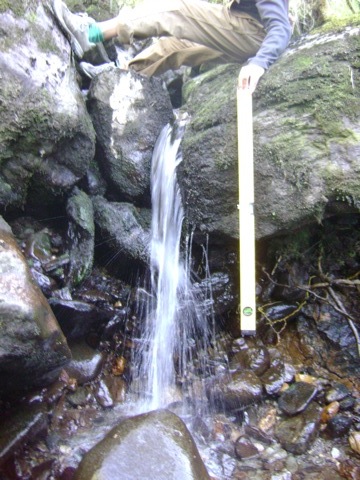

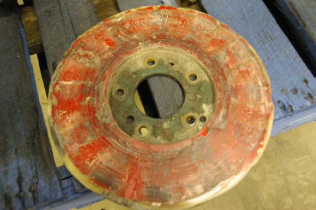

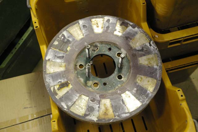

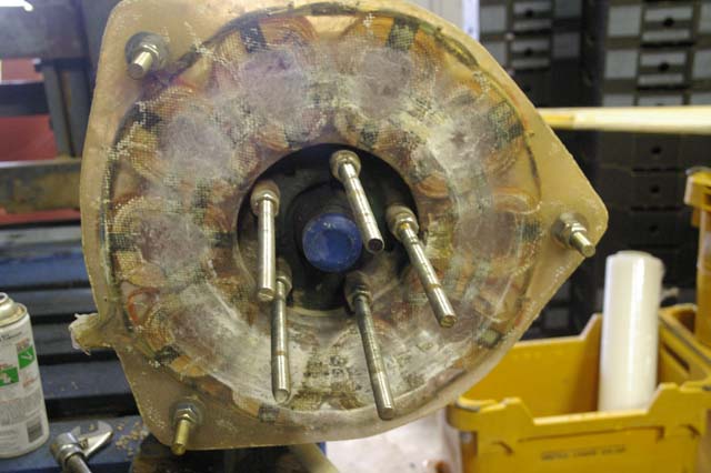

We are embarking on a project to build a axial flux generator driven by a pelton wheel. It will be situated in Perthshire near Balquhider. The stream has about 45m head and a flowrate of 1.8 l/s.

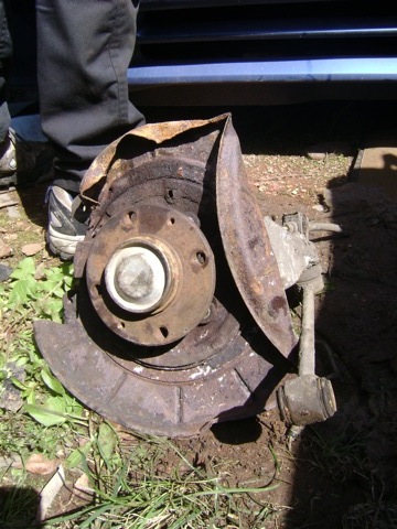

 We are basing our generator on the Hugh Piggott 1.8m diameter wind turbine design, which is rated at 350w. We aim to use brake discs for the magnet rotor and wind the stator to make it suitable for a 24V system. This week we went to a scrapyard and got both a front and rear wheel hub from a Peugeot 206- rear hub assembly pictured below.
Currently our plan is to use the rear hub. We also got a drive shaft with two CV joints to experiment with.
We visited the site and took the head and flowrate measurements, and looked at a few possible sites for the inlet to the penstock (photo below).
We had initially planned to cast the pelton cups out of resin, but were pointed towards cups available on ebay for less than five pounds each- this might be more sensible than spending hours refining our casting technique.
Our questions so far are:
  1. Has anyone tried casting something like a pelton cup? Is it a ridiculous idea?
  2. Any good ideas about making a nozzle?
  3. How do we match the generator to the wheel? Should we start by assuming an approximate RPM and design both to fit? It seems the normal RPM of a pelton wheel is much larger than the normal RPM of the axial flux machines. Obviously the higher RPM we go for, the more accurate our construction will have to be.
We will be updating regularly as we make progress.
Andy, Matt and Hertha
Ps. We spent ages getting the pictures uploaded and the right size...sorry if they are wrong. This was the most difficult part of the project so far.

These are the reasons we choose to build the Hugh Piggott axial flux generator. It is a known robust design. it can be made cheaply with minimal tools. It is easy to control. We considered using an induction motor but we were concerned the control would be more complex, if anyone knows a way of controlling an induction motor let us know. If the axial flux generator doesn't work for the hydro turbine we can use the parts for something else. Its fun to make!
« Last Edit: May 20, 2009, 03:21:56 AM by mattg »
mattg
  • Posts: 33
Re: Micro hydro Edinburgh
« Reply #22 on: May 20, 2009, 03:23:24 AM »
The diameter of the rotor is 25cm (we are using brake discs)
« Last Edit: May 20, 2009, 03:23:24 AM by mattg »
« Reply #23 on: May 20, 2009, 07:22:12 AM »
If you want to build from scrap then you have probably chosen the simplest option. You may have to compromise on the turbine to get the alternator speed low enough to be manageable. I suspect that anything over 1000 rpm will challenge you in terms of balance and bearing losses using car brake discs and hubs.
Induction motors run as self excited asynchronous generators have their fair share of problems when used for direct power. Used for battery charging they are probably not going to give you a high efficiency. The compromises to the turbine will almost certainly result in less losses than trying to use an induction motor with turbine at optimum speed.
An induction motor converted to a pma would give your axial a run for its money but again at the higher speeds would be a significant engineering task.
My choice would be a slotless radial with magnets rotating outside the stator but it would not be an easy scrapyard project. It made a good windmill generator but was not really suited to easy production from scrap bits. With the much higher speed of small hydro it becomes a significant project.
Keep with your axial alternator and take what comes from a turbine that runs it at the maximum speed you can balance it at.
« Last Edit: May 20, 2009, 07:22:12 AM by Flux »

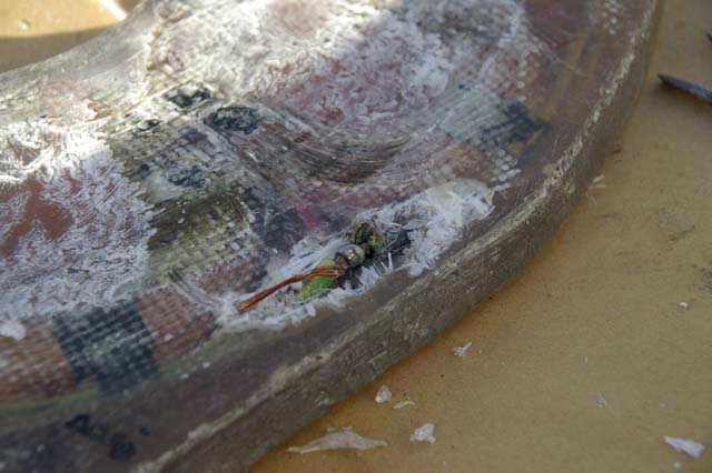

Hello all. After a bit of a break to move workshops and work on other projects, we wound some test coils this week.
We are currently thinking to wind 65 turns of two in hand 1.4mm wire. The stator has two coils in series per phase,and is of the single magnet disc but double rotor type.
We arrived at this number by winding 30 and 50 turns and spinning upto roughly 1000rpm (30 gave 3V AC, 50 gave 4.7V AC). We also noticed that in Hugh Piggotts recipe book he advises to wind 130 turns of 1.4mm in a similar single mag disc/stator/blank rotor setup, rectifying each coil separately, to cut in around 240RPM for 12V. We are emulating this by winding with two in hand, 65 turns then connecting as normal (two couls in series per phase). We hope that this will give us a cut in of slightly more than 500RPM. The other reason to wind this way is so that the stator can be used in a 12V lower RPM machine at a later date.
Are we on the right track? matt

To clarify we are aiming for 24v for the hydro application, but hope our stator could also be used at 12v for a lower speed
