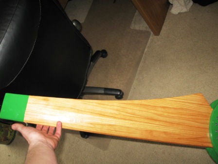

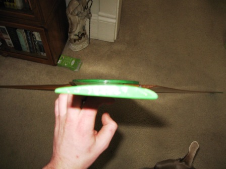

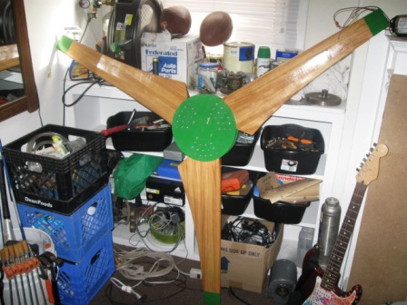

So here is what my 6' diameter rotor looks like. I am shooting for around 200 watts with this one given the winds here in the Appalachian Mountains. I plan on building a 12 footer to replace this soon!
More from the 6 footer. Carved the blades with a spoke shave and a hand saw, with a little chisel work here and there. I plan to do my 12 footer much the same way.

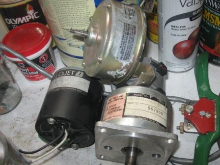

A DC servo, some other DC motors and a tread mill motor. Might make some micro mills out of those? Found all of it in the Ohio University dumpster (I got permission to take them first though!).
