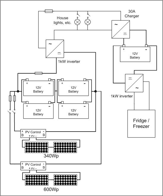

I had a few spare bits kicking around: A really old 100Ah battery (that just refuses to die even though I often neglect it in the garage for months), a spare 1kW pure sine inverter (left over from when my main system was 12V) and a 30A variable lab PSU that I use for charging batteries, starting small cars, blowing stuff up :D
Here's what I did:
The fridge-freezer only needs 125W when running, so the main solar inverter can deliver this with the other constant loads it has to supply.  The fridge-freezer only needs the 1-2kW surge for a fraction of a second and the 1kW inverter can deliver a 2kW surge.  So I used the spare inverter and battery as a buffer.  The 12V battery is only there to act as a big capacitor. In fact, I might try one of those 1 Farad car hi-fi capacitors instead of the battery (but I happened to have a battery kicking around).
Once the fridge-freezer is running, the 30A PSU runs the load from the house solar mains (drawing about 9-11A @ 13.8V, so it can recharge the 12V battery at the same time).  I'm using an old deep cycle battery but a car battery would do fine as it only has to deliver a "starting" current before going back to bed... floating to 13.8V after a couple of minutes recovering from the "start".
Obviously, the wife isn't too happy about a big boat battery next to the fridge in the kitchen but I think I can hide it all under the fridge. We had to raise the fridge up on decorative concrete blocks because there was a water pipe at the base of the wall that meant the fridge wouldn't fit in the space next to the units if it was on the ground...  So, there's a convenient bit of storage space under the fridge.  If I can get away with using the 30A supply (as the load is only nominally 9A) and a 1F capacitor for the surge, then I won't even need a battery.
Or, I might keep some sealed batteries under there as then I can maybe run the fridge overnight. I can run the fridge on the main bank via the charger until we go to bed and then I usually transfer the PC & comms stuff to grid power (easy as it's on a UPS) and I turn off the main inverter.  The fridge can then run for about 8 hours off it's dedicated battery (it should consume no more than about 46Ah), until the morning when the main inverter is restarted and we have solar power again.
A bit mad, but it might work!  The dedicated 1kW inverter can supply the inrush surge and power the fridge (plus I get another 100-ish Ah of battery capacity in the system for it) and the solar system sees a higher average power utilisation during the day.  And I didn't have to buy a new 2kW pure sine inverter to replace my main 1kW one :D

Very interesting...
My interest is in keeping our freezer from thawing out if we have an extended power-cut.  It's not happened for a long long time since domestic electricity in London is pretty damn reliable, but I'm still interested "in theory".
My fridge/freezer's consumption is a little over 1kWh/day, so in theory ~160Ah of 12V battery would provide a day's power on top of the ~18h that the freezer in particular is rated to keep the food safe for if you don't open the door (IIRC).
But the size of the surge is a real eye-opener, and means that you/I have to waste extra energy in what is, most of the time, a massively-oversized inverter.
And the fact that you have two more phantom loads with the waste inherent in your charger, and keeping the battery on float.

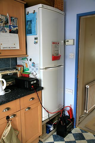

Here you can see my creation which I've dubbed "Fridgenstein" :D. Sitting on the counter are some of my other solar powered kitchen appliances. I have a 400W toaster oven, a 900W kettle and (out of shot) a 400W rice cooker and (in a cupboard somewhere) a 200W automatic egg boiler (actually an egg steamer but it makes "boiled" eggs).  The cooker, washing machine and fridge remain out of bounds for now :D  Although, I do run the cooker hood lights and fan from solar power.
One poster mentioned that if the inverter can't produce the required start-up surge, the compressor can fail to start and I did have this happen once (while doing the dishes in the evening).  The charger was sitting at 15A and the fridge was doing nothing.  The compressor had stalled on start-up, drawing 180W while not moving (hope nothing was damaged). I cycled the power and the fridge started up as normal after a couple of minutes.
It almost made it though the night on its dedicated battery (quite a feat for the 12 year old & often neglected battery).  After sun-down, it ran on the house bank via the charger and then at about midnight I turned off the house inverter (with the bank depleted to 60% DoD).
At about 4am, I woke up and had a look at it... still working. The compressor was running.  About 6am I woke again and this time the battery had died with the inverter locked out on a low voltage alarm.  I fired up the house inverter and the charger sat pegged at 30A for about 30 minutes (with the compressor running) but I had to stop it as the house bank was now drained down to 80% DoD.  The fridge carried on with its own battery and I let the sun start to charge the house bank.
It's not nearly so blue-sky sunny today so that will probably be it for the experiment.  I'll let it run until noon and then I can say that I've powered a fridge for 24 hours on solar power but I also know that even a dedicated 2kW surge rated inverter isn't enough to guarantee that the fridge will operate normally.

Simple...  I had to use my whacky multi-conversion thingy because the start surge from the fridge will blow the house inverter that is servicing a 200W constant load plus intermittently a 800W kettle.  The 1kW spare inverter I had could only just about start the fridge when nothing else was connected to it.
If I was serious about powering the fridge from solar, I'd just upgrade the house inverter to a 3kW one to provide the fridge startup current within the base load capability (not relying on the surge rating which will shorten the inverter life) and service the other loads at the same time.  It would also mean I could run the microwave, washing machine and a "normal" 3kW kettle from the solar system (not at the same time!).
But that means doubling the standby current from 0.7A to 1.5A on the house inverter and spending north of £1,000.  I did this test using spare kit laying about the workshop for nothing :D.
Post analysis puts the multi-conversion thingy at about 55% efficiency.  You lose a lot of power as heat on a transformer based linear regulated 30A lab supply...
