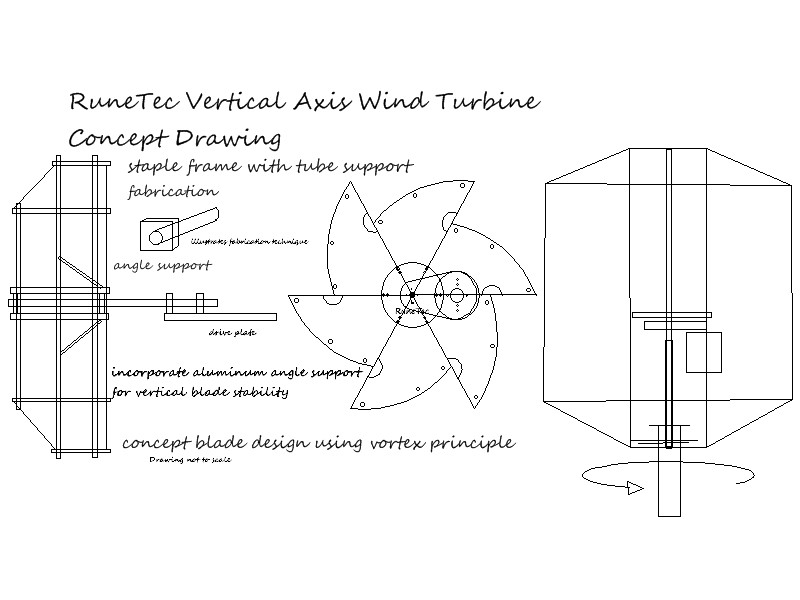

Finalized VAWT blade design.  I am using fabrication techniques developed during last blade attempt so previous efforts were not a complete waste of time.  Previous road tests proofed the fabrication technique is capable of withstanding high winds without blowing apart. The blades are constructed of PVC and aluminum using pneumatic staples to secure the aluminum flashing within the pattern canals cut in the PVC. If test results show that more torque is required the blades can easily be expanded to provide more torque.
The new blade design in combination with the 3 to 1 ratio drive plate should produce better results.

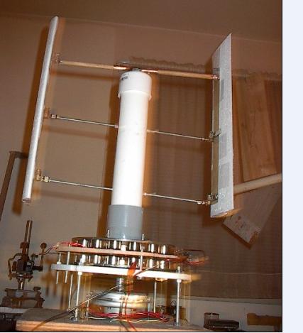

KilroyOdin your not going to like what i have to say,but here goes.
i do like your alt with its 3:1 ratio and its belt tentioners, i might have used bicycle sprockets and a chain,but i still like it.
My only experience with VAWTs was my version of EDs(windstuff) cycloturbine , which spun like a bat outta hell with a strong winter wind , not sure why he didn't go further with that design? maybe it got a little scary with a heavy wind ,not sure.
it only had/has two blades ,i first made them out of wood , later i made them out of foam ,point is sometimes less is more.its just that i cant see using six blades instead three?it is looking like one of those circulating resturaunt vents sure they spin , but will they ever generate usefull power? I've been thinking about a design where the backside collapses when its not capturing the wind , to cut down on drag. That is a main advantage of the cycloturbine , the backside isnt a drag on the system because it turns into the wind as it rotates. in fact IIRC its the one comming FROM the back that produces the lift. google windstuffed if ya get a chance good reading.

Hi, thank you for your input.  My PMA is has small diameter and requires a lot of RPM's to reach a changing voltage.  Spinning the drive plate by hand under different loads illustrates the torque needed to produce  higher outputs.   I am hoping the new design will provide both and be installed before the snow arrives. Thanks again and best regards.

« Reply #6 on: September 10, 2009, 08:06:29 AM »
That page !
It's not mine.
i should remove it
If you knew me you would know that i mostly make stuff from what i find , or can make.
I was trying to point you in a direction of something that may work better.
anyway this was my version of Ed's cycloturbine, a few years ago.
http://www.otherpower.com/images/scimages/2965/cycloturbine.JPG
http://www.otherpower.com/images/scimages/2965/top_view.JPG
