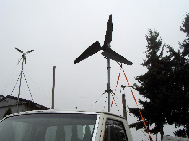

Here are the #s for the Hornet GM alt.
 Here are the TLG boast buster blades #s.
 5 mph   0 watts
  1. mph   0 watts
  2. mph   0 watts
  3. mph   12.25 watts
  4. mph   49.2  watts
  5. mph   93.75 watts
  6. mph  129    watts
  3 Hornet blades
 5 mph   0 watts
  1. mph   0 watts
  2. mph   0 watts
  3. mph  81.25 watts
  4. mph  89.46 watts
  5. mph 259.35 watts
  6. mph 357.5 watts
 Here are the 6 blade Hornet #s.
 5 mph  0 watts
  1. mph  0 watts
  2. mph 38.1 watts
  3. mph 96 watts
  4. mph 175.5 watts
  5. mph 246.93 watts
  6. mph 312.4 watts
Again these #s are scewed. It was a very calm day. So I just used the truck spedo.
Below 35 mph the 6 blade hornet did best even better then there 3 blade version?
But it still shows, car alternators are late to cutin.

All I've done here was tested these blades on the GM Hornet alternator they are suggested for and reported how they preformed for me in my test procidure.
The wind speed #s are scewed by the wind going over the cab of my truck but all the blades were tested the same way under the same conditions but the diferances are real.
These are not my blades or my alternator. I'm simply testing what this industry is offering and suggesting.

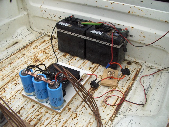

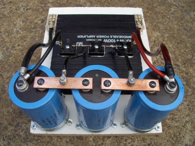

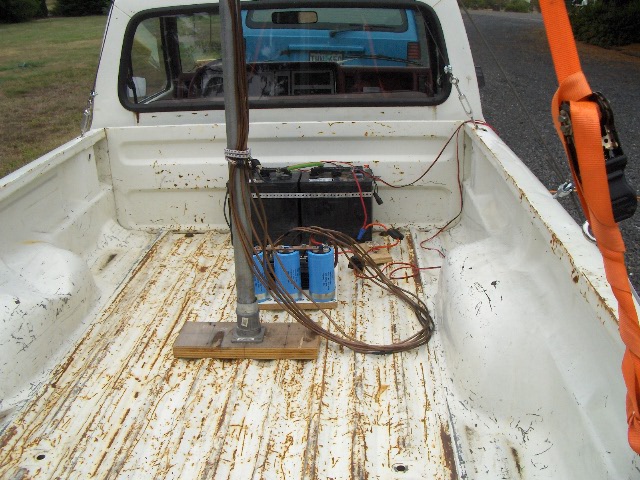

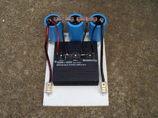

Re: TLG wind test.
« Reply #9 on: September 11, 2009, 05:10:58 PM »
Here are the batteries in the truck bed. These are thesame batteries used in the Dec. bench testing.
Here is the fullwave bridge and capacitor "Jerry Rigg" heak sink unit.
Hope this info helps.
