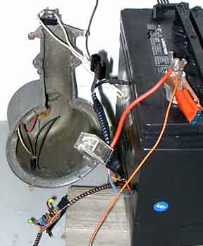

Yup.  They do get hot.
It does not take a whole lot to keep them cool.  Something flat and heavy, with good mass under the bridge, and lots of surface area.
I have used heavy angle AL, AL car parts, even a security light housing because it was in the truck. Yee-Haw. :)
http://www.otherpower.com/images/scimages/2050/FrigCntrlr.jpg
Heat sink compound helps a lot.
Using both AC terminals helps spread out the heat, IMHO.
No need for a negative connection on the bridge, just need to know the polarity coming out of the motor.
http://i701.photobucket.com/albums/ww20/ghurd1/Sketches/BridgeAsBlockingDiode.jpg
