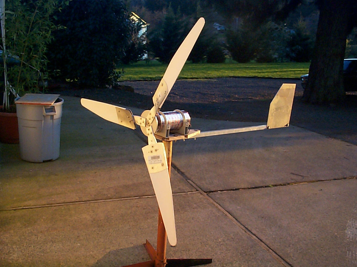

These work quite well.
I wrape the motor in aluminum foil ducted tape used for heating air ducts. It won't rust and its fast. Also kinda shiny. I sell these blades without the hub for $15 each.

The blades are very light. About 9 OZ. each. This would be around than 2 LBs after packageing. A very thin pkg. also. I ship by USPS. to Canada. I don't think it woud be all that bad for shipping.
I do sell a 3 and 4 blade metal hub. Thats the expencive part $50. You also need to make aluminum sheet metal supports at the root and extend 5 inches towards the tip.
I sell these supports at $5 per pair. 1 pair per blade requiered. A set of screw hardware is $5.
I also use #10 stainless steel machine screws, large flat washers, lock washers and nuts to hold this sandwich together.
Without this root support the blades will break. With the supports the blades have with stood 80 MPH+ winds in northern Youkon teritory.
I've wind tested them to 68 mph in my wind test truck.
Many folks have built there own hubs and supports. If you can do this from scratch this make these blades very cheap.
In terms of rpm I have no hard data yet. I do know they've spun a GM car alternater to 405 watts direct mounted.
In a recent F&P test I calculated from both lathe power and the a windpower test that at 15 mph the blades were spining at aprox. 415 rpm. This was 10 amps. This could be higher or lower rpm depending on the size and type of generater?
