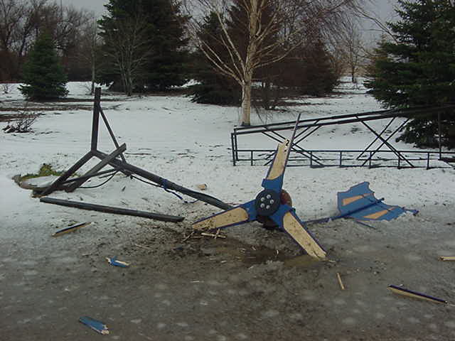

 After this big crash,

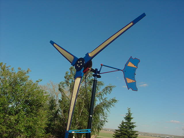

Heres the new blades, I can never add more than one picture at a time here for some reason.

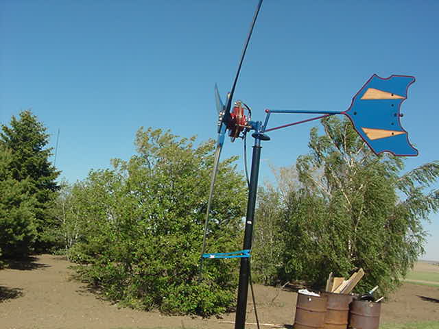

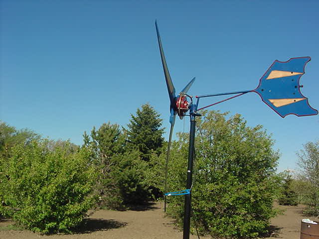

These new blades have a slight ;sept back' appearance for some reason, all three about the same. The tracking is dead on.

You can see by the trees how windy it is, lots of turbulance, but earlier was directly into good wind.

Wow Shadow, what the heck, didnt you have the stand ancored to the ground? I think your going thru a learning process like the rest of us. Ha. Anyway, If your using the little Square bridge rectifiers, it is possible that one of them may be shot. I burned out a couple the other day, when I had gusts up to 40 miles per hour. what happens when they go bad, it acts like a short, and will effectively slow the genie. I check mine by using my ohm meter and holding one lead on the AC termial that is to the left of the positive terminal, and than check across to the other terminals. You should only get a reading on the Negative terminal. If you read anything on any of the other terminals, it is no good. I have now placed three rectifiers on each Ac lead for a total of nine 35 amp rectifiers in parallel. Mine is also a duel rotor 9 & 12, 34 turns of double #14, with 12 foot dia props. It was puting out 90 amps DC. when the rectifiers quit. They were well heat sinked at the time also.

 Thanks Harry, I'll try that right away. No the stand wasnt anchored properly, but was never a problem. That blue strap you see fell off in the high wind and turbine spun out of control until it was like a sheet of plywood in the wind, then toppled over. All I would have needed was a plug-in shorted out to keep it from turning, tied or not. So now I keep it tied and shorted when not in use. I also anchored the stand.

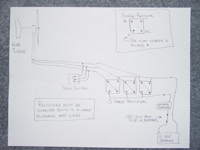

Ok, mine are wired like this,
so you say test the two across the back ac in to negative? with my meter set on ohms(buzzing)? And are we talking with the turbine stopped or running?

Yes, that should work, however I found that three was not enough. I had six when two burned out. When you test them, have the wires disconected. There may be another way to check them, but I found that the ones I had that were shot, I could get a reading on my ohm meter across all the terminals. which would be a dead short.

It sounds like the bridges ( 1  2  or 3 may have shorted with the high winds that you had. What kind of current was it producing at that time? What were the bridge rectifiers rated at for voltage and current? I suspect that one or more are shorted keeping your mill from producing its former volts and current. Shorted diode acts just like a short across the phase.
Test your rectifiers unplugged from the mill otherwise your coils will show on your meter. Short out your mill at same time so you can't get hurt.

The only sure way to test the rectifiers is to remove all the leads. There are 4 diodes in each package and your meter should show a diode between any adjacent pair of tags ( conduct with leads one way and not the other). Any pair that conduct both ways have a shorted diode, if you get no conduction you have an open diode, but that would not cause your present problem.
