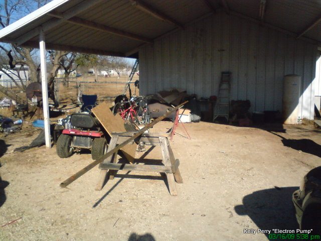

  I made me a bearing holder that worked great for ballancing the blades.

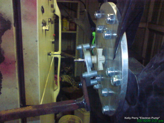

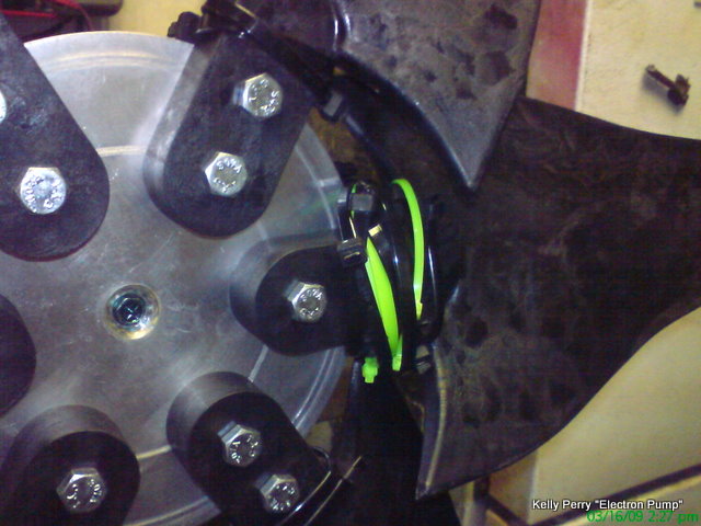

  This is the ball of nylon ties I ended up with at the center of my hub when she was finally finished.

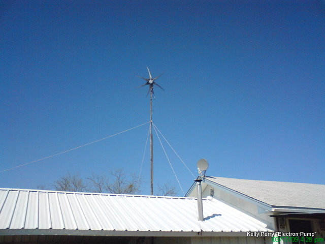

  Here is a shot of the pole. Its two 21' 14-guage 1 5/8" pipe offset by 7'. For a total of 28'. I'm really going to tell people its 30'. And I bent 4 pieces of rebar and welded 5' from the top to tie guy wires on. I also welded some tie downs to the sides and ends of the car port.
  This is what she looks like up in the air-a-flyin. Oopse, I cant seem to find that one in my files. I'll catch up with you on that one.

  I told ya I would catch up with you on what she looked like when she went flying!

You don't have that puppy anchored to your house, do you?
That's a good way to vibrate the nails out of the structure, damaging the house.
(Also:  A heavy wind may pull down the tower and pull a chunk off the house, giving you a twofer owie.)

  Man, I had a hub fail in 60 MPH winds. The top of the carport has a few dings to proove it. I found what was left of my hub and blades in a neighbors tree.
  And I have been through the vibration thing and I've fixed it. She is so smoothe and quiet, she can be pumpin' 5 amps into the batts and in the shop she is mounted to you cant hear it over the hum of the florescent lights.
  As far as the house, the shop is isolated from the house. It has its own foundation. The house is peer and beam. The only part of the shop that touches the house is a thin flashing so it doesnt conduct vibration. The shop is welded 2x6 and 4x4 square tube. Good and strong.
  I believe my worst fear is throwing a blade off. Or an exploding battery.
  Where she is there the pole bolts loose from the shop and tilts right over to the house. I can get up on the roof there and pull the jenn right off the pole and scuttle her in the shop. I keep very close watch on the lockal wind and weather reports and if they say they are stormies I can run out and take her down in real short order.
  Hey, I appreciate the comment though. Yall have a good weekend guys.

You really can not say the a roof mounted turbine will cause any damage or problems unless you have had it happen.  I have had mine up on a wood framed Saltbox House for just about a year now.  The structure is over 100 years old, and has shown not a single problem from vibration.  You just need to know how to do it.  The tower goes inside the roof to the second floor and onto a brace.  All held in with anti-vibration mounting and four steel bolts at the base as well as rubber supports at the roof beams.
Just need to plan what you want to do with what you have.  Telling people not to do what some are unable to do is not being helpful.  The wind speed at this site has been over 160kmh, average is above 40kmh and about all we ever get is a dull hum.  That is till the motor on this one fried.  Gotta luv SW.

  I saw 52 MPH winds last night. Well actually I'm still in em. She is out there zinging 7.5 to 10 amps solid and quiet as a mouse. Well a pretty dizzy mouse.
