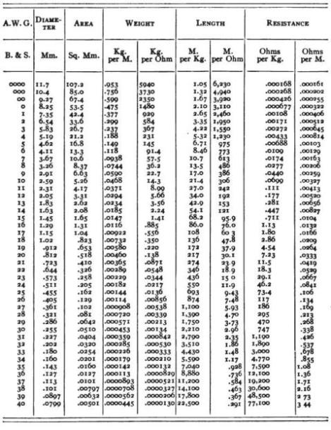

  • Can someone point me for an approximation in wire meters (not Kilos) for the 1.5mm that i will need for 9 coils?
I can say its near the AGW15
AGW14      1.63
AGW15     1.45
AGW16     1.29
What a dilemma ..at least it is for me :)

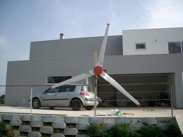

Nice turbine displayed in front of 'Cool House'
Photo Size is limited to 150K bytes and/or 640x480, please refer to Frequently Asked Questions... DanG

Sorry for the size of the last picture..corrected now
Thx DanG
Its my recent build "Modern cubic" house (470m2 of space inside)..lots of big windows in the other side (south), very efficient, good solar exposer...but that's another story...

  • AWG15 is 0,0147Kg per meter <-> 1Kg has 68,2 meters
For what i read in forum,i may need +/-200gr (70turns) per coil, that's 2kg of wire.
