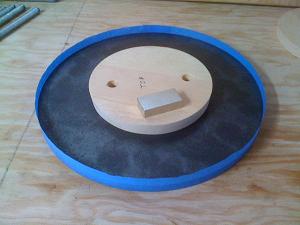

  2. I was hoping to cast both rotors at the same time and did not want to build two wood molds or band the rotors. I can not find stainless banding in a small quantity and I don't have the ability to weld stainless anyway. So, has anyone tried to cast the rotors just using tape around the outside edge (and the wooden island, of course)to hold the resin in? It seems like a simple and cheap way to go.

We re-cast our stator with tape, it worked all right you can see the discussion here http://www.fieldlines.com/story/2009/1/6/154435/7727
Also we live in a dry climate and were unable to find stainless steel banding so we used regular packing bands from a refrigerator box or something which we found at the dump.
This our first turbine besides the one we built at the Other Power workshop last year so please take everything with that in mind, anyway here are our rotors
http://outfitnm.com/alt-energy/wind-power/axial-flux-alternator
The bands make a great casting dam keeping everything level, much better than trying to keep the tape in place

Using normal steel band around the magnets rotors to substitute SS is a good way to short some of the magnetic flux in the magnets. Not sure how big of a problem it will be without calculating, but I would recommend using SS band for the sake of magnetic properties.

I used to use tape that way and it orked fine I guess, but when I did I took measures to really make sure th emagnets couldnt come flying out.  It should be fine, if something goes wrong though and the magnets start rubbing the stator you may have problems.  if you do that, I would try to somehow band the rotors, even if you cannot find the stainless, either use steel.

If you are relying on it for holding the magnets then I would suggest a band of some sort. If you can't get stainless then thin mild steel wouldn't have much effect on the flux, there is bound to be some loss but I can't see it being an issue with something less than 1/16" thick.
Cleaning the discs carefully with abrasive or grit blasting or something makes very good sense if you are relying on bonding the magnets to use without a band. if you use a band then just removing active rust and grease is probably adequate.
I think vinyl ester works better than polyester so for weather protection it should be perfectly adequate but I wouldn't consider it a structural glue. The better epoxies should do the job without banding.
I think even vinyl ester should be ok with a fiberglass banding round the magnets as long as you key the resin mass to stop it sliding with some holes, roll pins or screws.
Just a resin block with the magnets right up to the edge of the discs and no banding requires a structural adhesive to hold the magnets or epoxy potting to be sure, although I think the issue is much less than many think. nearly all magnet coming off issues are after some other failure such as a stator rub with heat demagnetising them.

I used to run a piece of stainless steel wire rope (about 1/8" diameter) around the circumference a couple of times.  It bonds well to the resin so there is no need to tie it up.  You need a bit of extra resin outside the magnets to bed it into.
Nowadays I feel that a layer of fibreglass cloth on top of the magnets shold be sufficient.  No problems lately.

You could band it with fiberglass fabric and impregnate that with resin.  No magnetic problems that way.  (But might be difficult to get the fabric to stay where you want it.)

I'm thinking of sticking to the book design on the rotors and spending the extra time to get the stainless bands made. I'll try the vinyl ester resin too since I have lots of it and sounds like it bonds pretty well with the steel plate. For the next turbine I'll get a bit more creative and try some of these other ideas.

Interesting. I like the idea of putting screws through the rotor to give the resin something to hold onto. Perhaps you could do this without the banding at all.
