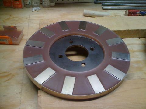

Ok, guys I need a bit of advice here. I read most of the forum discussions about casting stators, but I am still not quite sure what to do in my particular case. Working on this 10 foot other power wind turbine is the first time I have worked with any type of resin.
Anyway, I cast the 2 rotors a couple of weeks ago and they turned out great (see picture), but it was a bit touch and go. After 3 or 4 hours the resin had not started to harden at all. So, perhaps I was being impatient or stupid but I ended up putting a space heater near them and they fired off really well. I measured the temperature near the rotors and it was about 100 degrees. So I took the heater off after a few hours that night and they were totally finished hardening in the morning.

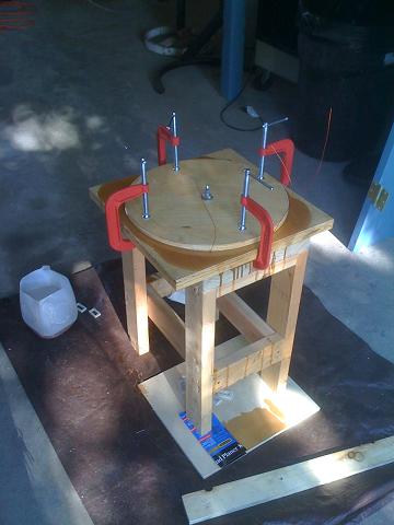

Now I am wondering what to do about my stator. I just cast it a couple of hours ago and just like before, it has not started to "fire off" at all! Am I being impatient or do I need to apply some heat to the stator now as well? I am concerned that it will crack or shrink if I apply heat like before but worry it will never cure if I do nothing. What should I do?
I used...
  • 1.5 Quarts Vinyl Ester Resin
  • 0.5 Quarts ATH and Fiberglass as fill (mostly ATH with a touch of fiber)
  • 0.25 ounce of Hardener
It was about 85 degrees when it was cast.

Thanks for the suggestion! The a couple hours in the sun and the mold (and my tester) was totally cured. I guess UV does work...well my temperature gauge registered 107  degrees on the mold too. Anyway, it cured up nicely even with so little hardener (about 1/2 %) but it did take some heat. I don't think it would have ever cured without it.
Unfortunately, there were a number of air bubbles but they all look like they are cosmetic and fixable. Any advice for fixing bubbles? I was going to use a bit of tape around the edges and pour more vinyl ester resin into the hollow spots...maybe put something flat on top to smooth it out.
The mold was destroyed as well. The bottom of the mold actually pulled up a bit of the plywood. I think making a plastic mold is a really good idea. I would not do wood again...the stator did not fall right out. And this was after 4 layers of linseed oil and 3 very thick layers of mold release wax.
Anyway, here are a few pictures...
