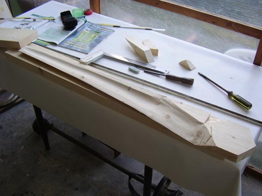

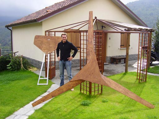

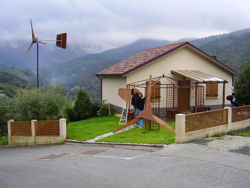

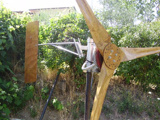

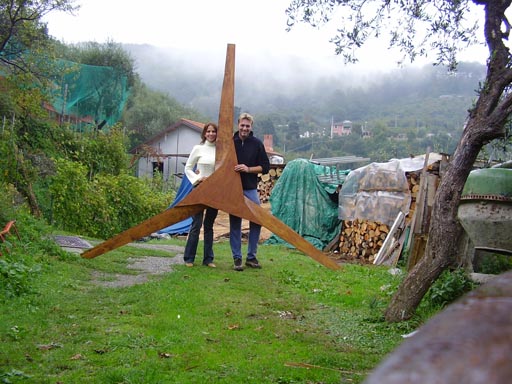

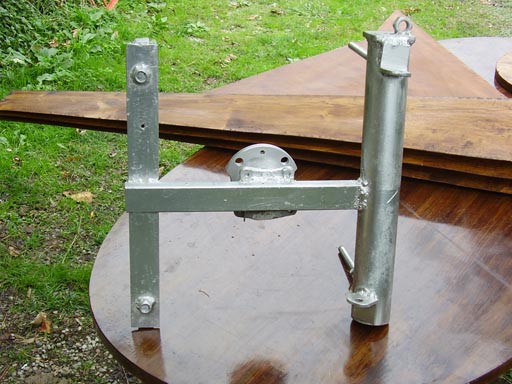

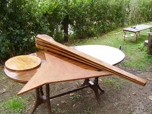

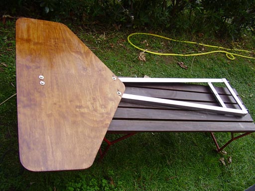

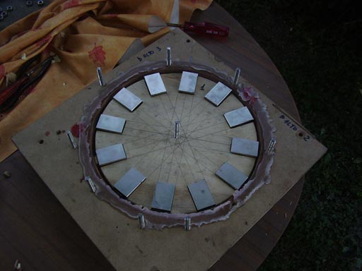

I send you some photos of the jennies from me built with the help of my wife of 500w and 1000w of inspiration Piggott. The jenny of 1000 ws misses they anchors the rotors and the magnets that will arrive soon..... A big problem will be to succeed in throwing aloft it!!!!

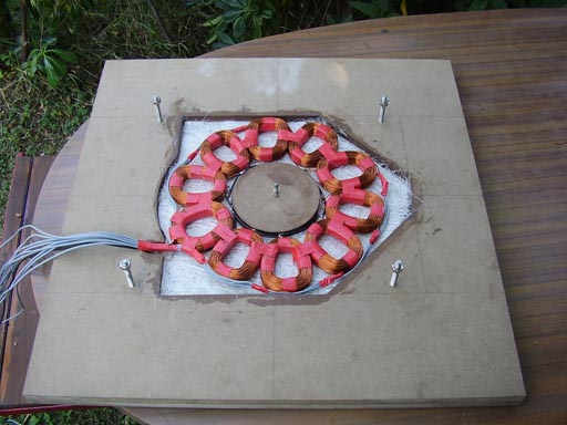

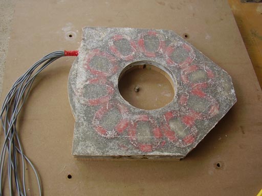

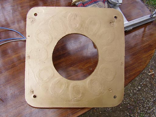

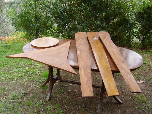

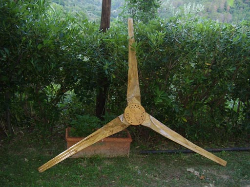

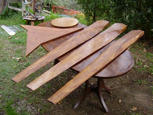

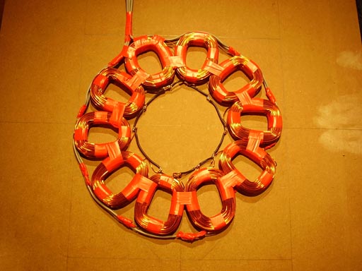

The constructive phases of the jenny from 500w, (10 coilses thread 1,12 mms. for 142 turnses, magnets degree 40 30x46x10 mms)
The constructive phases of the jenny from 1000w, (12 coilses thread 1,82 mms for 46 turnses magnets degree 40 30x46x10 mms)
My house with the jennies

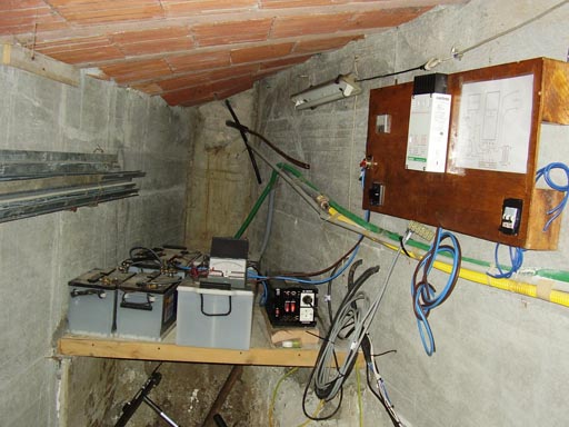

The control panel and the batteries

congratulations ! everyone looks happy!

wow--nice country--looks like you burn wood for heat--is that a small village you live in?--great lookin mills also..coolin off here..but no snow yet..[looks warm their]

Wow, beautiful country, and beautiful machines.  You must be proud.  I am envious.

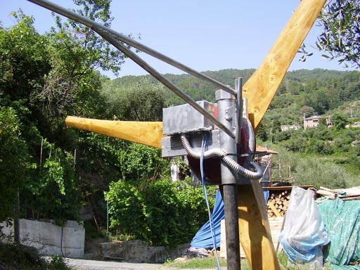

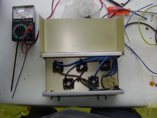

I was looking at the mounting of the rectifiers and wondering if the heat sinking is sufficient.  I took what I thought was a pretty large aluminum heat sink (about 12.5 by 26 centimeters about a centimeter thick base with about 3cm fins on that) out by the Dan's in the spring and DanB told me that it would be insufficient for a 12V roughly 3meter machine, but maybe ok for a 48V machine because the amps are so much less.  I can't tell for sure, but it looks like your rectifiers are mounted on a thin aluminum box and I'm wondering if that will be sufficient in windy weather.

I am sure the rectifier heat sink will be adequate for 48v, especially up there in the wind.  The 12v case is a lot worse.

Excuse me but I have forgotten to say that the system is to 24v.
The box èeffettivamente of thin aluminum but from the photo he doesn't succeed in seeing that I have positioned others two angular thick in aluminum on the front of the scatrola together to a big squanderer for CPU.

I forgot to say that the jenny I have seen to produce woodpeckers of power of around 340W with gusts of wind (therefore the car doesn't seem to go to stalemate) but probably the strong wind still has to arrive....

If you have thick aluminium angle under the fixing points of the bridges I think it will be ok even for 24v. you should get a lot of cooling directly to the stator mounting frame.
That is a nice output in gusts, it should go well in stronger winds.

It's a small town of 500 in habitants and with the fractions we are 1000, my wife and I we live in the small house in the photo, to the shade of the jennies
